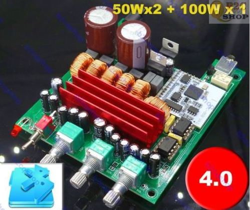

I am building my second project. My first one was Speakerdesignworks Aviatrix. This one will be a 2.1 channel portable boombox using the following parts:

- TPA3116 Bluetooth 4.0 Digital Amplifier
- Dayton Audio SD215A-88 8" Sub
- Markaudio Alpair-7 Gold Cone 4" Full Range Driver
- Mean Well MW NES-150-24 24 VDC 6.5A 150W Regulated Switching Power Supply

those batteries look promising. I am going to build it with just a PSU for now. The compartment is large enough to support batteries in the future. It will be 5" x 10" x 10". My subwoofer and PSU come in today. I will start testing out my amp. It seems to be a different build than the one that FFcossag upgraded on youtube for better sound. Mine is attached here. Has anyone here used this specific version?
I tested out the amp and one of the channels has more base than the other. The sub channel's low-pass filter is set too high. I have to learn how to adjust the capacitor values to accommodate as I'd like the low-pass to be around 100hz, or better yet, 80hz. Then the high-pass on the 4" speakers to be around 60hz. I am also getting the wood cut next week. This being portable, I am thinking of 1/2" Birch and doubling up on the front baffle with internal bracing. Do you guys think this is solid enough for my subwoofer, or should I go with 3/4"?
I was looking at that one as well. I am worried about all the mentions of noise.
