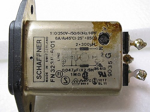

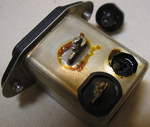

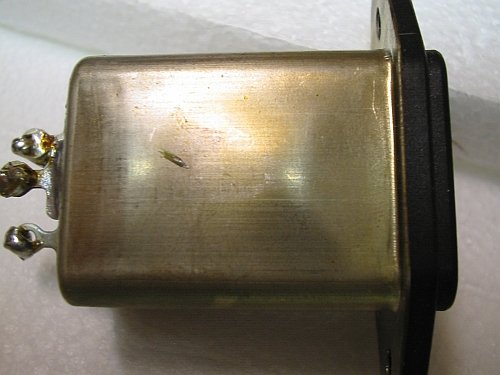

Several components for hifi/home audio in used condition are danger even outside of operation, because the integrated capacitors in the mains inlet C14 plugs are not disconnect from mains after switch off the component (and not to check and for replace).
Therefore the aging is more extend and it is not possible to check the condition like describe under
because the parts are potted and thus not accessible without destroy.

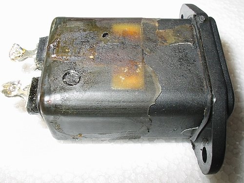

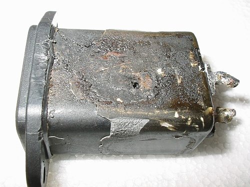

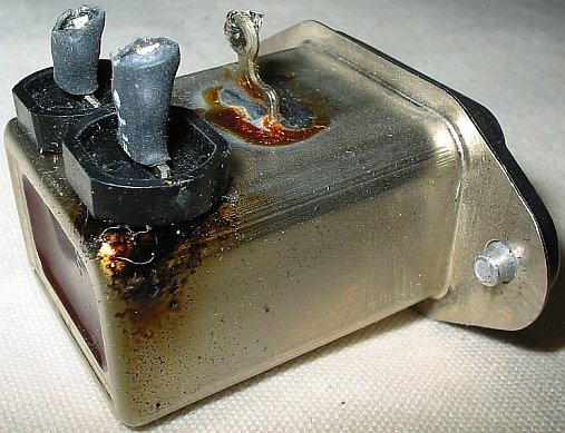

A friend of me observe such IEC C14 inlet versions with internal burning parts in his Linn Pre-amp KAIRN and Linn CD Player KARIK (unfortunately covered in a black shrink) exact according the description under this URL's:
https://www.vintage-radio.net/forum/showthread.php?t=88137
https://www.vintage-radio.net/forum/showthread.php?t=82160
https://www.vintage-radio.net/forum/showthread.php?t=69128
His apartment smelled extremely unpleasant despite ventilation for many days after this event.
Are the problems in this mentioned threads extremely rare ?
Because there is no access for replace the bad X2 capacitor - go to
only the possibility for whole replacing exist of course with the risk of the same issue after a certainly period of use (because all parts are always connected to the mains even after switching off the main switch).

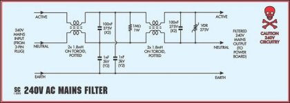

P.S.: In general I strongly recommend always to replace by a passive inlet (i. e. without integrated RFI parts) according the attached images No. 8-10
Additional an external RFI unit resp. mains filter according those under
https://www.audiomisc.co.uk/mains/filters1.html
or according the attached images No 11-16
but connected behind and not before the mains on/off switch.

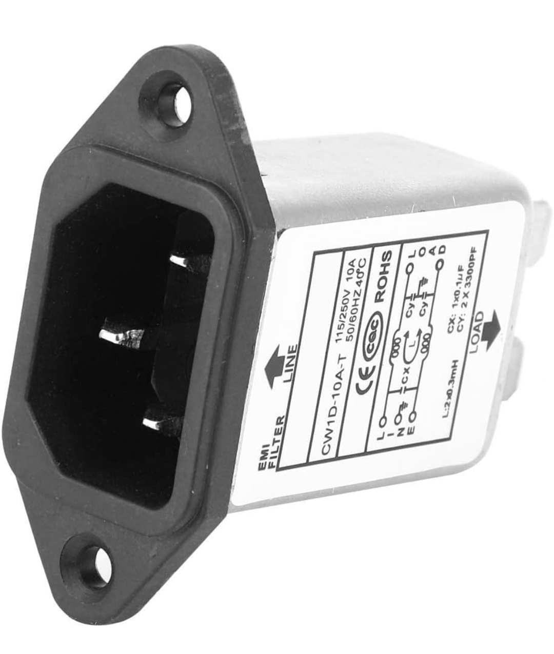

Hi Guys,
Trying to replace a failing Schaffner inlet filter (Fn-376- single fused,voltage selector) with a brand new Delta (03sb4- double fused,voltage selector) and can use some input on how to correctly wire things to the new filter, as they are slightly different. I will be using it on 240V primarily, but would like to maintain compatibility to the 110-120V if needed.
I've attached some pictures and a drawing of the old and new inlet filter.
Thanks a lot for your input...

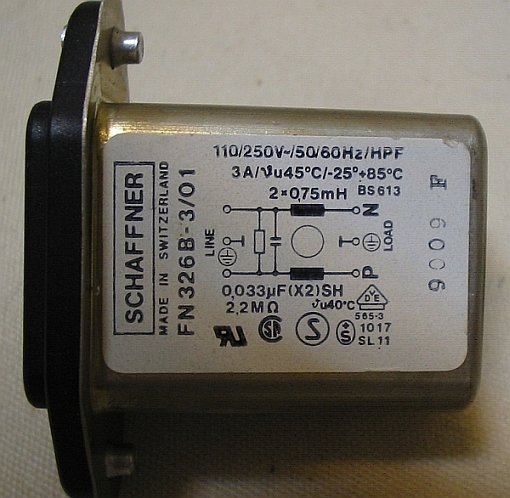

IEC power inlets of course come in all price ranges and I plan on getting a few of the Furutech and other "audiophile" ones and AB them against the poly glass non magnetic cheap ones from parts express in the near future with the same amp wires speakers etc and see if anything is audible at all from them. Of course this experiment can be money wasted and time wasted and wondering if anyone has tried this and what the experiences and results were. Surely someone here has tested this before not just by ear but also with testing equipment probably better then I have access to. Anyone care to...
Or you choose wisely and choose one with a DPST mains switch and fuses integrated. It is always more safe to switch stuff really off (both L and N) and separated from the grid when unattended.
Anyway, the Schaffner filtered IEC inlets with exploding internal RIFA PME series caps are a known issue but these are very old and the RIFA PME caps are very bad. Those RIFA PME also explode in other old devices. Their plastic casing cracks and then moist/dirt can creep in which is not beneficial for their longevity. Many parts are subjected to being energized 24/7 which does not necessarily needs to be a problem. X and Y caps in all their variants are designed for that. These RIFA PME decided that they did not want to take part in such activities anymore.
In other words there is no real common problem we need to panic about and there is absolutely no valid reason to advise to replace filtered IEC inlets for unfiltered ones. Unless one has the particular IEC inlets by that brand with that capacitors. It could be a good idea to check old devices coming in (the price one pays for gathering/hoarding old stuff) for that particular brand and replace the decades old filtered IEC inlets without hesitation for recent ones. Also to be cautious when seeing any RIFA PME in whatever device and replace those also rücksichtslos for a recent cap with similar or better properties. Solved.
