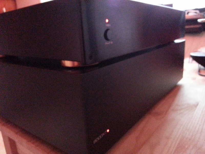

About a year ago, when I just got my Audiolab 8000x7 power amp and connected it to Onkio digital processor (having a good hardware media-pleer as a main source), I had significant switching-type-of... well, not even "clicks"... explosive bangs from time to time while switching something at the processor or starting playback at the player (Audiolab works starting from DC).

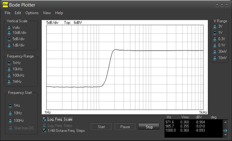

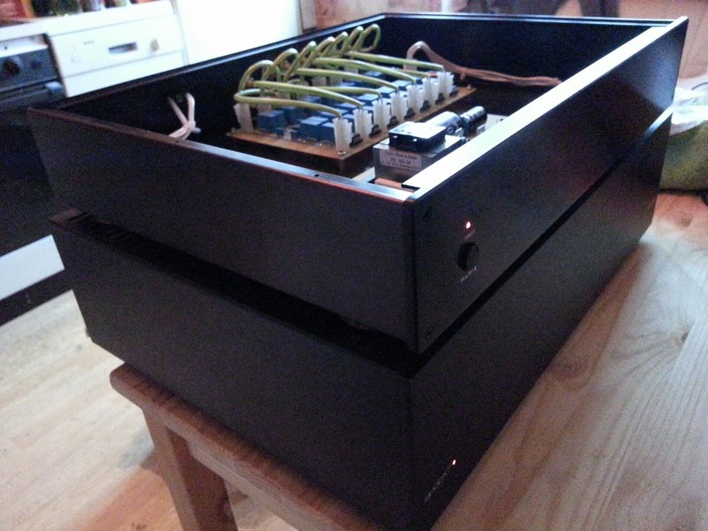

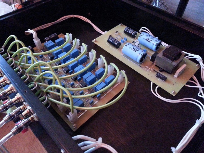

So I decided to build a high-quality subsonic filter to address this issue. 5-th order Chebyshev was designed, Burr-Brown OPA627 were selected as active elements.
Here goes the sad part of the story 😛 3 OpAs per channel * 7 channels = 21 OpA.
Local store gave me the price of $30 per OpA. Well, what could I do? Right, order at ebay... but then I would have to wait. I went for a faster route 🙂

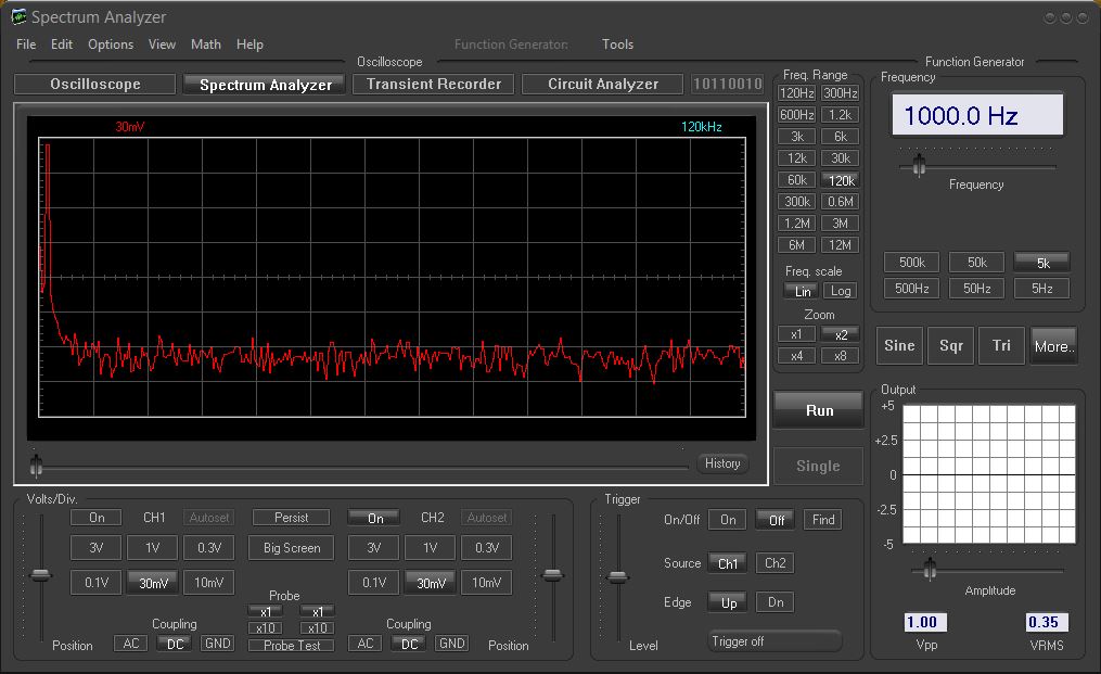

The filter if fully transparent above 18Hz, it virtually has "no THD" - I can's see it, I can's hear it, I can't measure it. There's only noise sobewhere at the level of -120db. No compromise device 😉

I have attached some pictures. The graphs are taken from the device itself - no modelling.
I still use it and love it. Will also use it with PowerAmp-pio I am building now.
If somebody is interested in more info - I will publish the schematic and well-designed PCBs. Nothing special - devil is in details 🙂

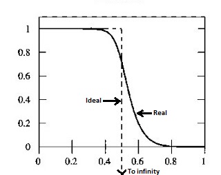

Why choose a topology with a stop band (Bode plot, image#5 of post#1)? Why not let the very low frequency response continue to fall at -100dB/decade?
It would be great if it would be possible 🙂
When developing active filters, generally a normalised circuit is considered which produces an “ideal” frequency response having a rectangular shape, and a transition between the pass band and the stop band that has an abrupt or very steep roll-off slope. However, these ideal responses are not possible in the real world so we use approximations to give us the best frequency response possible for the type of filter we are trying to design (see attached - the picture shows low-pass, for low-cut just mirror it).
Here is a good article on how it works: Boston University - Active Filter Notes
As usual, you have to choose the right compromise between the pass band / stop band ripple and stop band attenuation.
Bode plot at post #1 is a real analyzer screenshot, showing the live performance of my filter.
