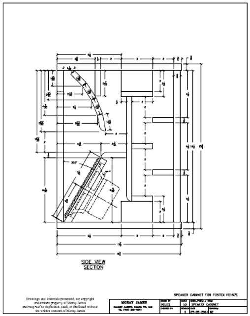

I had good results with this design using a Fostex Fe166 but I think that my line length was off. The goal is for a line length 1/4 of the driver free air resonance minus about five hertz. You can play with damping I think that the drawing will give you the general idea. I like Karlson's even though this is a departure from the traditional design. Best regards Moray James.

Moray James by"off" are you saying you made it [the rear firing reflex chamber] too long which would be difficult to correct. and by "good" do you mean that it did not meet your perceived expectations? Is this why you then tried the Karlson and found what you were looking for? Planet 10, this may be asking a dangerous question but very good compared to what? Hi Freddi My lounge room is the size of a small flat where Tannoy Canterbury SE's had room to breathe but thanks anyway.
