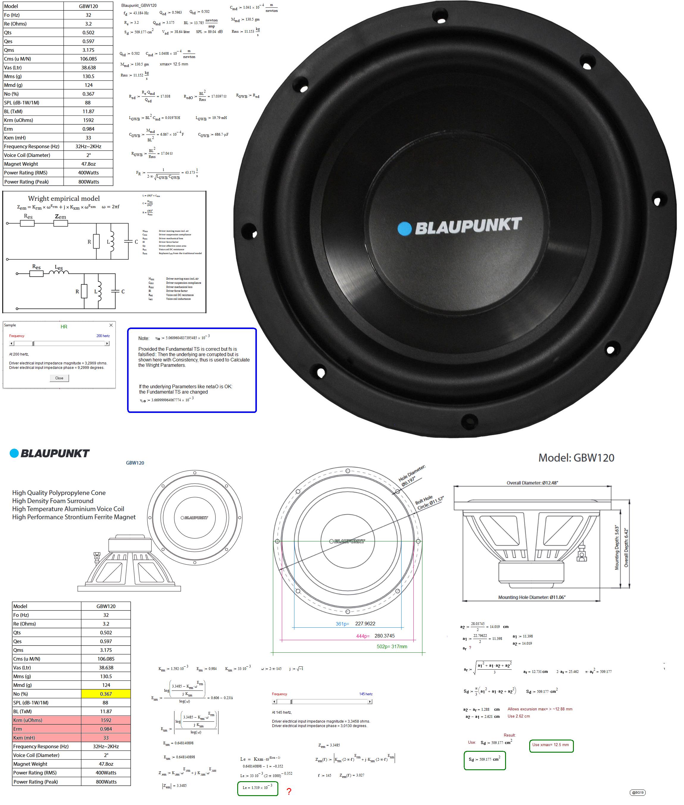

Qts .5. Fs 32hz
Can't find xmax.
Natural rolloff at 64hz infinite baffle. (Fs/qts).

Most of the parameters are available in the manual. Only xmax is missing.
Given that this is a car sub, I’d hazard that xmax isn’t too shabby...

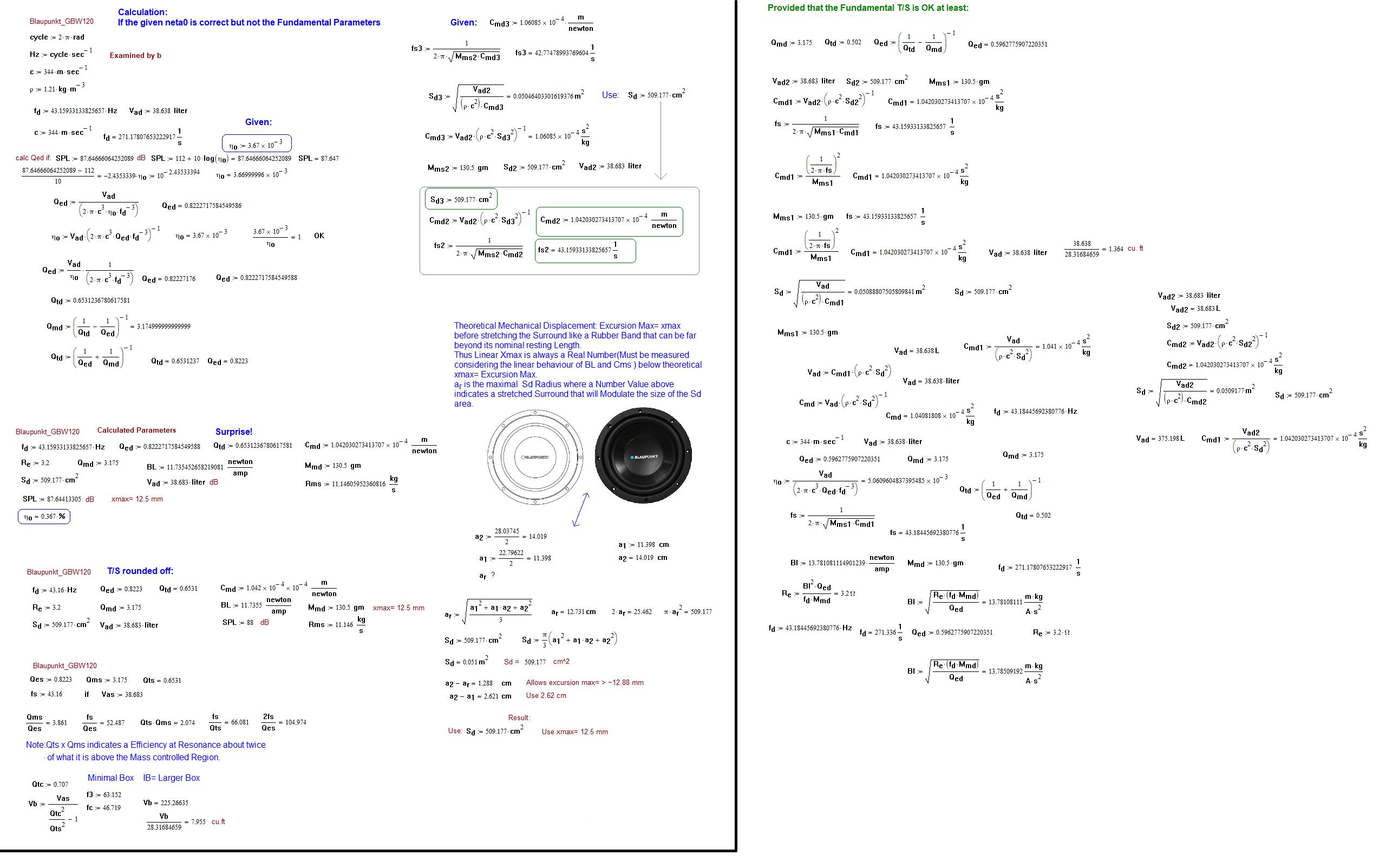

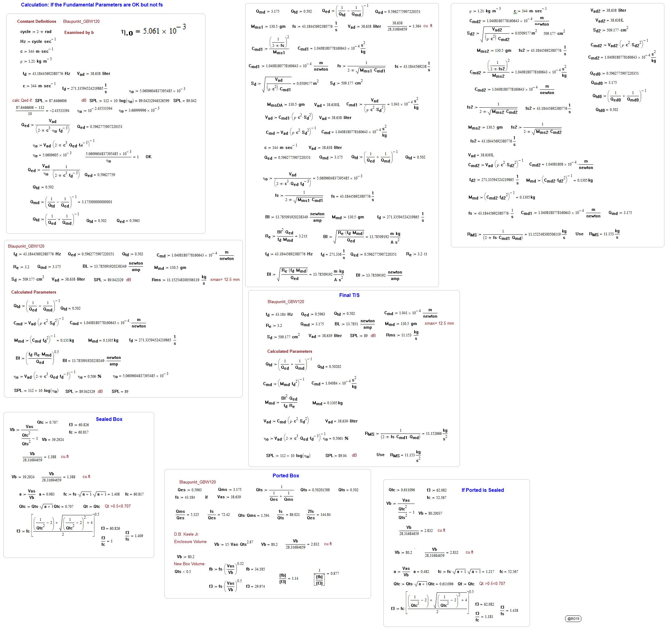

😡 Before any conclusions can be made when eyeballing this Driver: Do a consistency check:
xmax is around 12.5 mm, Sd is ~509 cm^2(506 if calculated) but the parameters are all inconclusive and doesnt match like fs= 32 Hz ,no way: but could be 42-43 Hz . Further is that Exm is missing, probably by purpose to misslead.
xmax is around 12.5 mm, Sd is ~509 cm^2(506 if calculated) but the parameters are all inconclusive and doesnt match like fs= 32 Hz ,no way: but could be 42-43 Hz . Further is that Exm is missing, probably by purpose to misslead./b
Isn't this Information you could base a Design? You hang up your Serious? consideration/assumption that an IB only could work properly if a single Parameter like xmax is the crucial Parameter when the most important indication is that of the given Parameters are corrupted.
I never assume, I do educated guesses like I've Posted: So why didn't you check my findings?
I gave you an indication of your ‘’Xmax’,fs and Sd’ and that is much more than ‘Nothing ‘
Here is what I based my guesses on, for the given Driver:*
