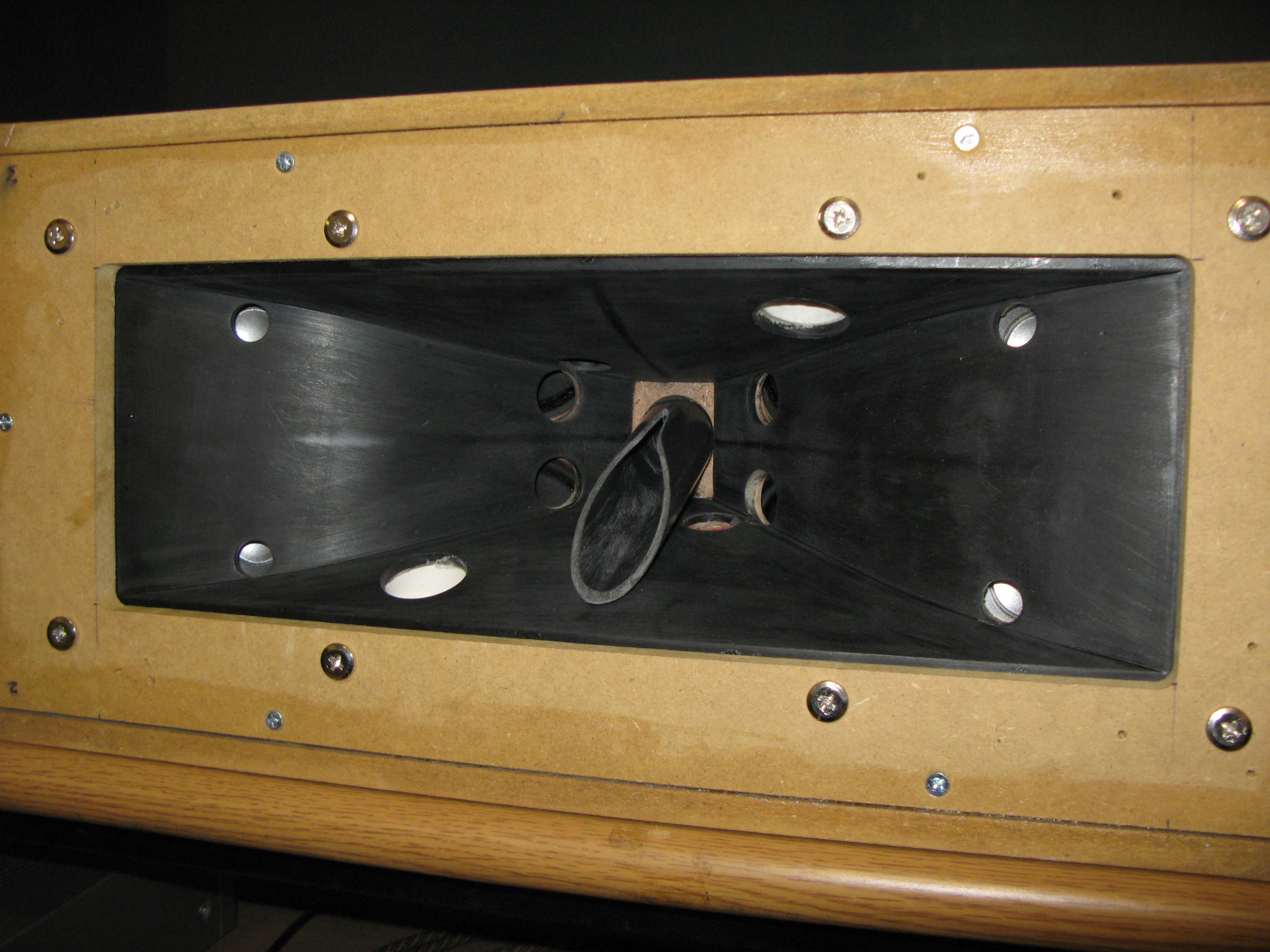

The bottom illlustration is my 'Black Mirror' project. Basically move the waveguide down low, so that the floor and the side walls extend it. In the illustration, you can see that pushing the loudspeaker all the way into the corner basically eliminates the early reflections in the lower midrange. Basically the wall and the waveguide function as one.
Here's some pics to illustrate the size of the cabinet, how it fits in the corner, and the size when compared to my Summas.

I feel confident that this project will work, so this time around, I'm building both speakers simultaneously. (In 80% of my projects I'm not so confident, and I generally only build a single speaker, then build a second one if the first one works as planned.)
Due to the fact I'm building both at the same time, things aren't moving as rapidly as they normally do. Right now I have the waveguides mounted on a baffle for both speakers, and I have the mounting plates attached for the midranges. The compression driver won't require a mounting plate, because this waveguide was designed for the compression driver I am using. (I'm using the big QSC waveguide, and the waveguide was designed for the Celestion CDX1-1425.)

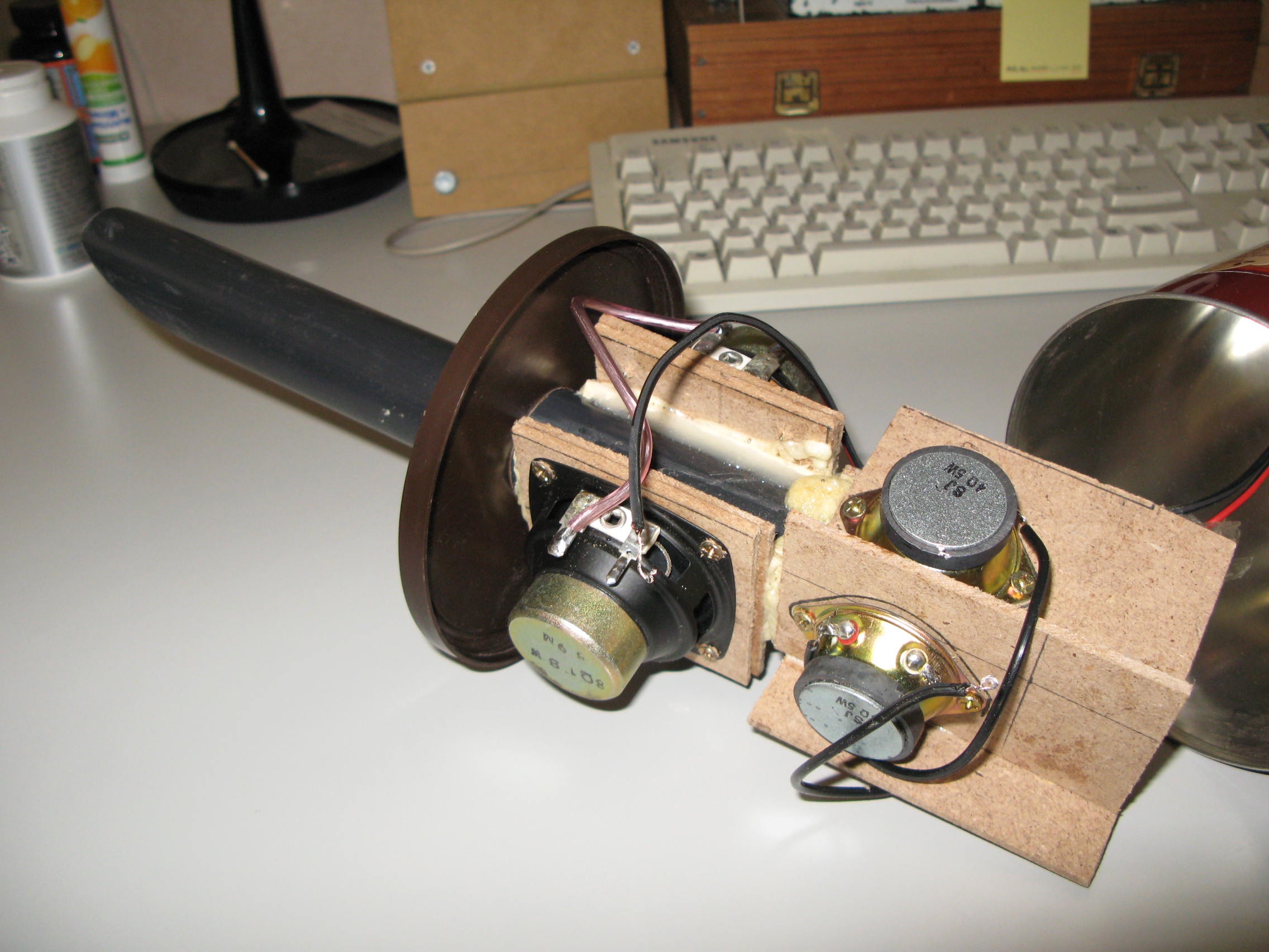

Synergy corner horns make a lot of sense! Walls acting as secondary flare.
I have a dream of having such in my HT cave as mains. I am pretty sure that a center speaker is not needed. Actually I made a quickie proto last summer. But this setup would mean pulling down 4 m2 of book/record shelf. And finding a new place for it. I don't have that much energy now.
