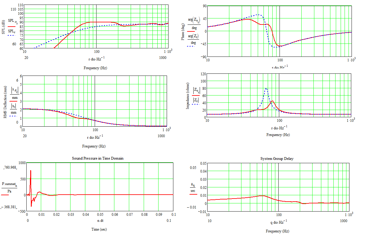

Correct, mass corner is too high without some help from the amplifier or Eq if you want to tune low. Linear travel is also rather less, so it tends to need more help from the box.
>>> Box for FF125wk. Internal HxWxD = 35.5in x 5.5in x 9in. Zd. = 7.125in. Vent 5.5in wide x 1.875in tall.
Scott, your sim looks like it would provide some weight to the sound... Nice! I also notice you tune many of your cabinets to around 70Hz for Fostex drivers this size regardless of the physical size of the cabinet. Would you recommend a sub for these rather than stretching their bass response (and potentially spoiling their overall performance)... or do you prefer them 'as is' accepting them for what they are?
actually, a bit of both I think
You mean like this Chris?
Box for FF125wk. Internal HxWxD = 35.5in x 5.5in x 9in. Zd. = 7.125in. Vent 5.5in wide x 1.875in tall. Stuff cabinet 0.65lbs ft^3 dacron or similar & adjust to preference from there. A removable back will make that easier.
gee - looks almost too simple, a guy could bash a pair of those out in a couple of hours
well, yah, what took you so long
I know, I'm slowing up. 😉 Will try to do better in future. 😀
