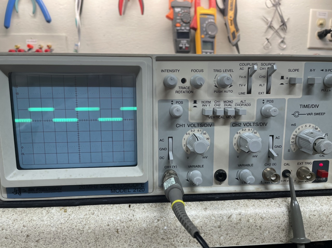

I bought a used BK 2120 scope about 7 months ago, and its been pretty faithful actually up until this afternoon. I know how to use it and have been using it on average about an hour per day since purchase.

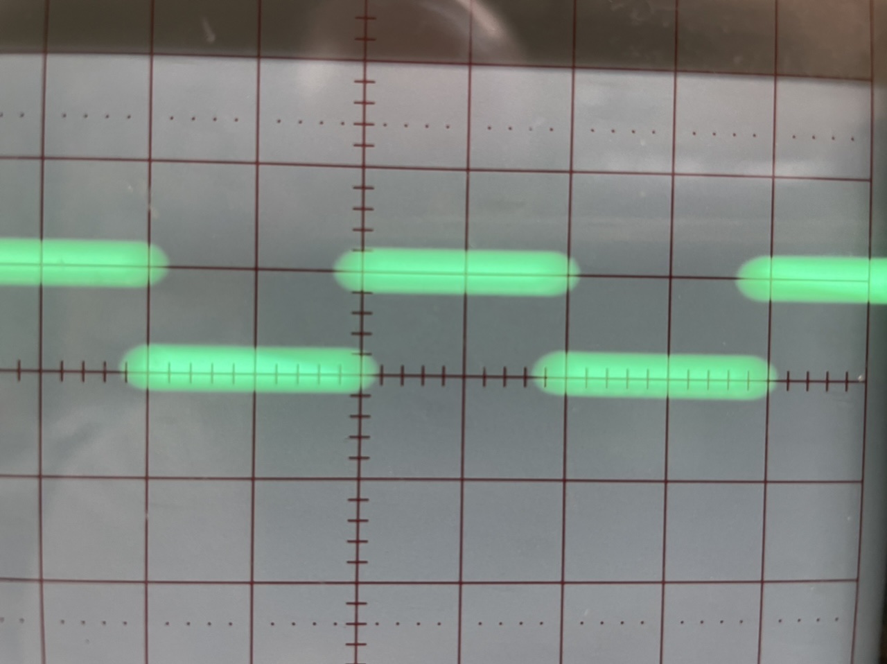

The trace line for both channels just today quadrupled in height. Focus cannot get the trace line as sharp as it was even just this morning. Nothing has changed at all afaik but then again dealing with old equipment. The scope still works otherwise but very annoying not seeing that sharp trace.
I opened it up but everything seems very clean inside.
Foreign object to me. There are no pots for focus fine-tune adjustment within either.
Anybody know how I might service this?

Digital TV style...get the service manual...the focus may be controlled from processor inside.
Check the power supply, and the EHT.
It can kill you, be careful around high voltages.

I know theres 2KV in there maybe more. Enough to fry some eggs and meters.

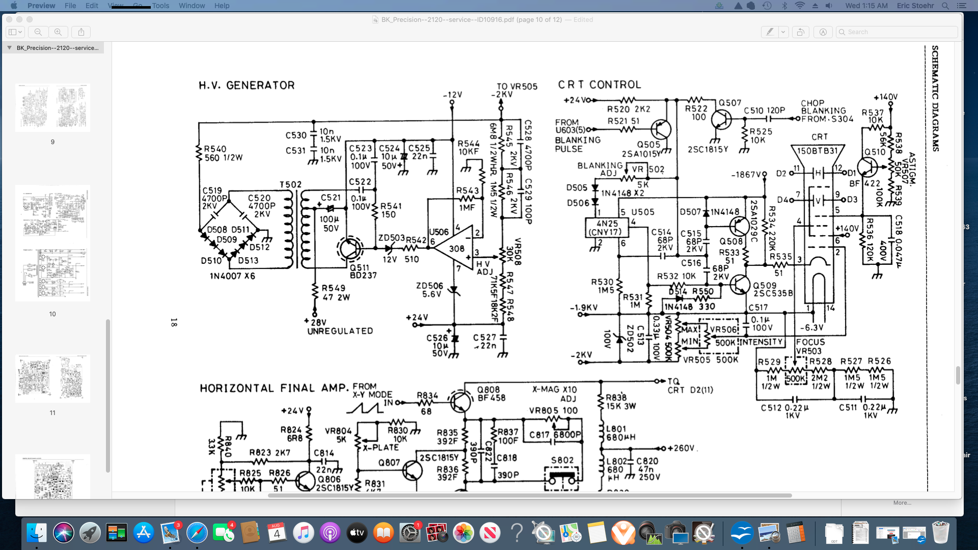

VR503 is the focus pot. While powered if I touch the positive meter lead to any of the legs of VR503 the trace immediately sharpens to a level I've never seen before.
I'll do some more testing tomorrow, but for now I'm thinking C511, or C512 may be out of spec.

My first suspect would be any of the high value resistors in the focus chain. Also do not discount the focus pot being faulty.
Why not just calculate the voltage expected across each resistor in the chain and see what you get.
And another thought (depends on the range it has) is the astigmatism part of the circuit. Easy one to check by measuring the voltage on Q510 emitter and seeing if it looks reasonable. Probably around 90 to 100 volts.

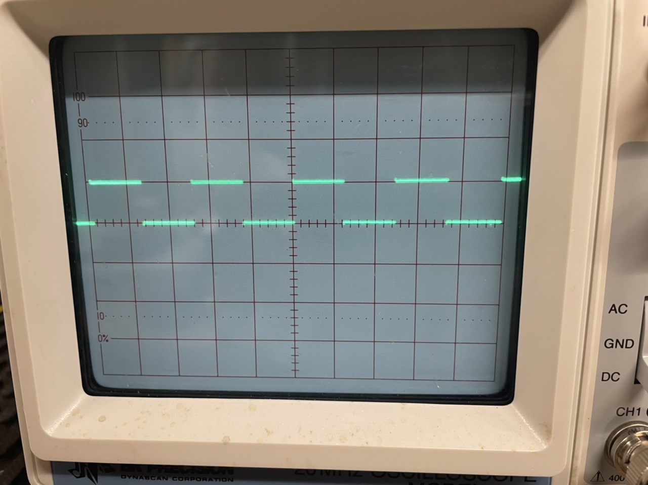

I found R526 blown open. Easy fix! Trace is now sharper than ever. Thank you!
