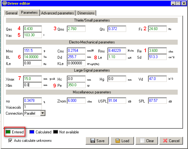

Has anyone got the .wdr file for this driver, to put in Winisd ?
If I try to input the driver from the TS parameter, upon entering the MMS of 150g and CMS of 0.198mm/N, it auto calculates an Fs of 29.2Hz. The Fs is listed as 24.6Hz. This is driving me insane, definitely a mistake somewhere. Such a bargain for a UK obtainable driver.
Any help on above would be appreciated.
