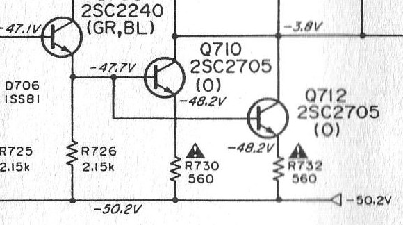

Here's a picture of a doubled 2SC2705 in the Vas stage of an expensive buggar from the 90s.
A single 2SC3955(+2SA1540) only costs 10 cents more.

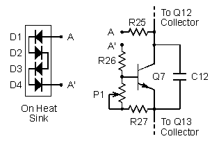

danville,
What Thermaltrak bias circuit will you use? The OnSemi application note shows a simple string of several of the diodes, while Leach suggests a Vbe multiplier transistor on the main PCB plus thermal diodes from the heatsink in its C-B bias leg. Leach feels the RC in this leg provides more stability than using long wires to the Vbe multiplier transistor.
I've been debating using ThermalTrak with the Leach circuit, but the specs on the Sanken 1215/2921 specs look attractive for my low voltage application, unfortunately... much more expensive.
I've never done it with an external diode. My thought was to add a single diode in series with the emitter. The BE junction of the transistor will be fairly constant if it is not near the heatsink. The variation will then be caused by the diode.
I use a two transistor circuit. The second Q just lowers the impedance.
I can tell you that you can control bias quite well when the tracking transistor is mounted directly on an output Q (not on the heatsink). The diode should be better.
I don't like the whole string of diodes method. This doesn't give you flexibility in setting the bias point in a fairly arbitrary way.
