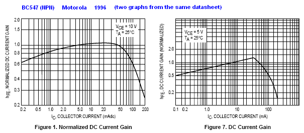

Hi keantoken
I've also noticed the two "flavors" of curve mentioned in your first post. First, many years ago, I saw datasheets for BD139 and BD140 where the BD140 had the "starts flat" curve and the BD139 had the humped curve. That got me thinking that the BD140 would be better than the BD139 for a VAS in an amp. i.e. use an NPN input LTP and a PNP VAS, rather than the other way round.
Your post awhile ago somewhere else about biasing transistors on the hump of the curve for minimum distortion got me thinking about this again. I got to wondering if PNP devices are inherently more linear in their current gain than their NPN complements, just as they tend to be slower.
I googled around for some datasheets now to check that out. Couldn't find any BD139 or BD140 datasheets with curves, but the TIP3055/TIP2955 curve below shows the effect.
Then I decided to look at BC547 and BC557. The curves below from Fairchild show the two shapes you mentioned but blow my theory totally. Their NPN has the flat curve and the PNP has the humped curve. (and yes - I've at least triple checked to make sure I didn't mix them up🙂)
The Motorola data sheet shows a "hump" curve for the BC547, though! Unless somebody screwed up their datasheet, it looks like the "same" part from different manufacturers can be totally different.🙁
Looked at another two BC547 datasheets to check.
The Vishay one is almost a classic "hump" shape, but flattening out at very low Ic. The Philips one is almost a classic "starts flat" curve, but droops down at very low Ic.
That's four manufacturers with four different shape curves
Maybe more modern / exotic transistors are more predictable?
Maybe it's just that the decades-old ones have been refined differently by different manufacturers over the years?

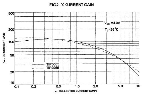

Hello keantoken,
I've addressed this issue to some extent on this web page. In terms of SPICE modeling, it's best understood in terms of the so-called "Gummel Plots".
The rationale of these plots comes from the assumption that, for an ideal BJT, IC vs. VBE is an exponential function. If beta (=IC/IB) were constant over all collector current, then IB vs. VBE would also be an exponential function for this idealized BJT.
This idea is combined with two properties of logarithms. The first is that ln(x) and exp(x) are inverse functions, that is, ln(exp(x)) = x. Therefore, for the ideal BJT above, plots of ln(IC) and ln(IB) vs. VBE should look like straight lines. This is shown in Figure 8 on the page linked above. The second property of logarithms that comes into play is ln(x/y) = ln(x)-ln👍. Since beta = IC/IB, ln(beta) = ln(IC/IB) = ln(IC) - ln(IB). That is, ln(beta) at each VBE value can be interpreted as the difference between the two curves.
Now have a look at Figure 9. The Gummel-Poon model shows that ln(IC) vs. VBE has a bend at high currents. This is what models the beta reduction at high currents. The model also shows that ln(IB) vs. VBE has a bend at low currents. This is what models the beta reduction at low currents. At both low and high currents, the curves are closer together, therefore beta is less at these extreme current values than it is at a mid range of currents.
Now, suppose at some "middle current" value (that is, some middle range of VBE), both ln(IC) and ln(IB) vs. VBE have become straight lines - that is, they don't bend. These lines will be parallel, thus beta will be relatively constant over this range of currents. Further, the parameter BF will be exactly the value of beta in the region where beta is constant with current.
Consider another case, in which there is no middle range of VBE values where both ln(IC) and ln(IB) vs. VBE have become straight and parallel lines. That is, as we start from a low VBE value and work our way up, ln(IB) vs. VBE is still bending up, while ln(IC) vs. VBE is already starting to bend down. For this case, there will be no middle range of collector current for which beta is constant. Further, for such a BJT, the BF parameter will be greater than the actual maximum beta.
This leads to another interpretation of BF. Suppose we take the linear portion of these two curves and extrapolate them so each curve (ln(IC) and ln(IB) vs. VBE) looks like a straight line. IOW, we ignore the bends. Then these curves become lines, and the difference between these lines at any and all VBE values is ln(BF). The key is that for BJTs that don't have a region of constant beta, there is no range of VBE values for which the actual curves look like parallel lines.
Some great examples of these two cases are the MJL3281A and MJL1302A. The PNP has a region of IC where beta is relatively flat, while the NPN never gets to a constant beta. This is reflected in the BF values of the two, relative to the actual measured maximum beta.
Thanks for the info Andy and Godfrey. I found it annoying myself to find that different manufacturers gave different curves. I think some questions can only be answered by someone with a curve tracer.
Andy, what you say confirms my experience. To model a humpier transistor, Bf must be higher than the actual value.

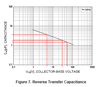

Something that DOES bug me is variations of bjt parameters with collector voltage, especially collector-base capacitance.
The second picture shows Ccb of about:
5V - 3.6 pF
30V - 1.8 pF
55V - 1.5 pF
So in the simple VAS shown, the total feedback capacitance is about 49pF, but when the output swings +-25V, it varies from about 48.5 to 50.6 pF.
That's about a 4% variation in the capacitance that sets the open-loop gain of the amp. Ouch! Distortion will be bad. Also important is that the capacitance variation is very non-linear (despite what the graph looks like - check the numbers above), so it's not all nice 2'nd harmonic distortion either.
You can keep the non-linear capacitance out of the feedback path with e.g. a cascode or baxandal super-pair, but for ultra-low distortion, you might want to worry about the output still having to drive that non-linear capacitance. That's a lot harder to deal with!
The non-linear input capacitance of the output stage is easier to deal with, using e.g. some kind of diamond.
btw: If you haven't seen it yet, GK's got a nice thread dealing with VAS linearity here: http://www.diyaudio.com/forums/solid-state/154670-my-folded-cascode-vas-linearity-investigation.html
Cheers - Godfrey
5V - 3.6 pF
30V - 1.8 pF
55V - 1.5 pF
Cheers - Godfrey

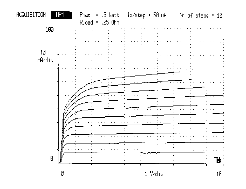

I've been thinking for some time a curve tracer would be a worthwhile investment.
Don't be tempted. I have a Tek 571 and I know of no other piece of test equipment that even comes close in unreliability. The thing has let the smoke out of its collector supply three times (once with a rather bright bonfire) and now its (obsolete) video microcontroller (running unknown code) has died.
However, in the brief moments when the blasted thing was working, I established a few things. PNP transistors always show Early effect far more than NPN transistors. hfe for those MJL beasties genuinely is more constant with current than anything else I've seen. SPICE models do not tell you about those charming little quirks that happen at low VCE.
