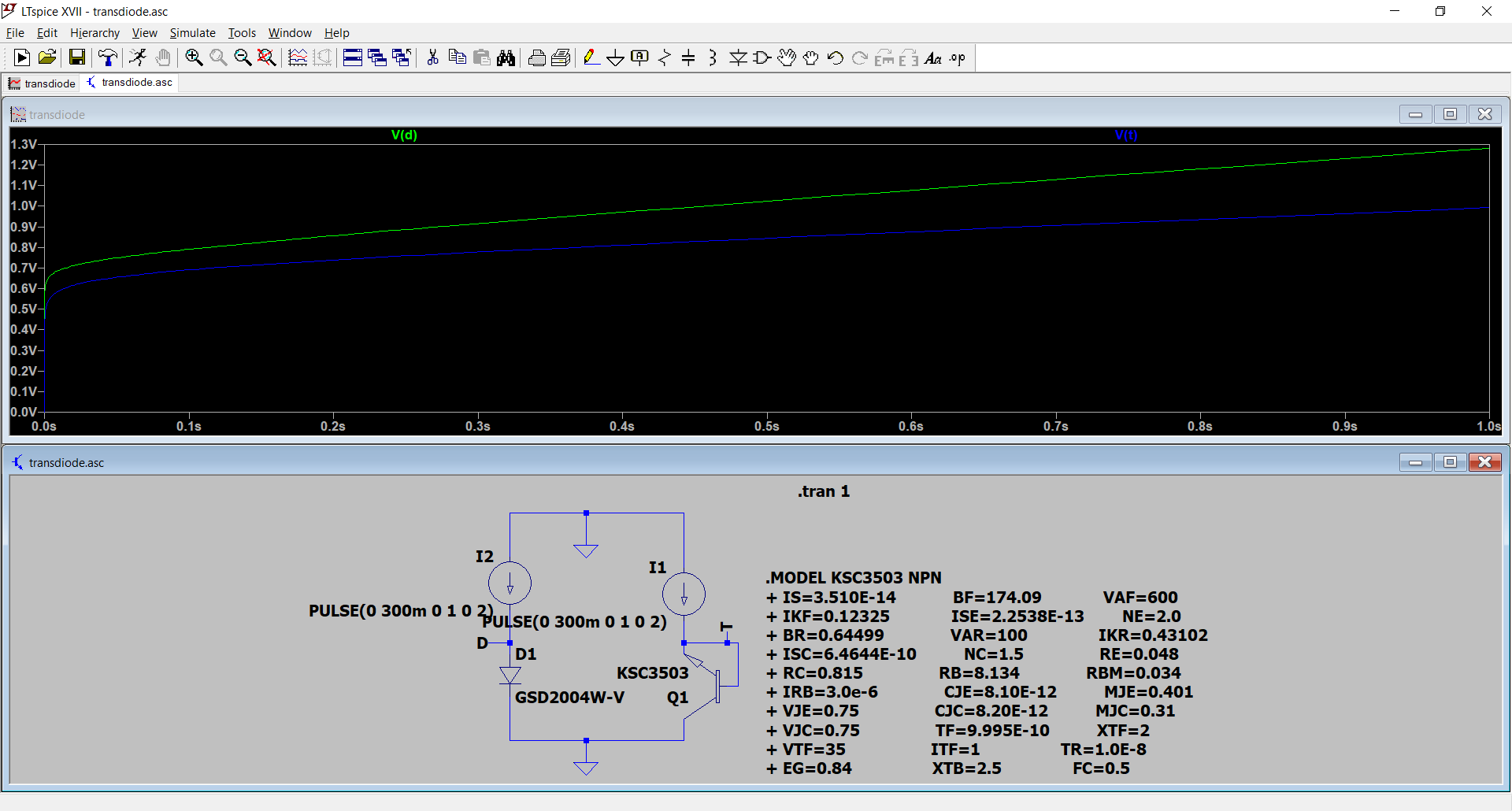

Connect B & E together and you will obtain the equivalent of a good epitaxial diode having a Vrrm equal to Vcb (larger than Vceo)
That should work. The series resistance may be a bit higher than for a normal diode, but otherwise I don't see any problem. In fact you could go up to the VCBO rating, which is always >= VCEO. Elvee's variant probably has less series resistance than the variant with open emitter, because reverse transistor action helps to conduct the current when the base-collector junction gets forward biased.

Hi Semper, you can use the CB junction as a diode, but don't expect a great diode. To get the 300V ratings, the collector is lightly doped so the series R will be high. Not sure if it is spec though. I would do an IV curve trace before using it to see if it is adequate for your application.
...To get the 300V ratings, the collector is lightly doped so the series R will be high....
I believe this is "highly doped". (But it is all relative.)
FZT558's Vce(sat) spec suggests just a few Ohms, "zero" for most tube circuits.
That cannot be, if it was highly doped, then you would have too many free carriers and the high electric field at 300V will lead to avalanche currents that would destroy the device. The physics don't add up.
I would curve trace it to make sure.

sandrohv is correct, it is lightly doped. With high doping you get a narrow depletion region and a low breakdown voltage, like in a Zener diode.

Exactly, a transdiode is much more perfect than a real one. The reverse beta might not be very large, but it suffices to improve matters considerably
In a BJT the emitter is extremely highly doped, the base moderately doped and the collector very lightly doped. This is essential to good specs, and the ratios are around 100 or so between the electrodes - vast differences.I believe this is "highly doped". (But it is all relative.)
This is often represented as N++ P N- (or for PNP P++ N P-) - the signs represent concentrations, confusingly!
In normal transistor operation the CB junction is reverse biased, but carriers from the emitter diffuse across the base into the depletion region and are immediately pulled across by the electric field, the collector acts as a resistor that depends on the density of injected carriers - more injected carriers, less resistance. Since the emitter has 10000 higher density of charge carriers than the collector, this means the collector resistance during normal operation can become very low when high currents flow, despite being high when quiescent.
As a BC-diode, you only have the base to inject carriers into the collector, so it won't be nearly as conductive as during transistor forward operation, since the carrier density is orders of magnitude lower. Also base-spreading resistance can be a factor too.
In transistor saturation the charge carriers only diffuse across the collector (no electric field to accelerate them), so the density of charge carriers in the collector can become even higher as its limited by recombination - no field to pull them clear - so the collector resistance can be much less again. As a diode this isn't going to happen.
In reality collectors have a highly doped layer where they contact the electrode metal, and a BC diode will perhaps behave a bit more like a PIN diode, since the lightly doped part of the collector is so much less doped than the base or the collector electrode contact.
So the device is actually N++ P N- N+.
The devil is always in the details...
