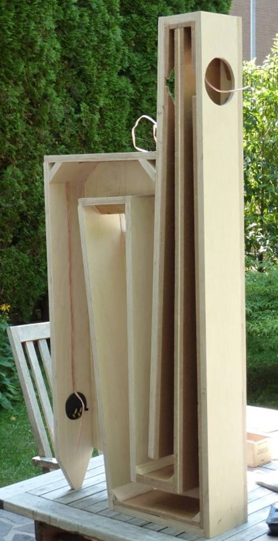

look my double horns, you can do it with TML, simulate ~2,5 m with a ~1,5 m, you can create a better IMP an interlacing of the drivers reduces membran movement for better mids and more max. SPL
