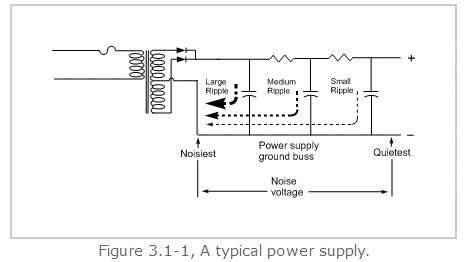

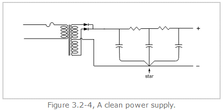

If you don't have the time to read it, here are two relevant images from that article. Also from it: "If signal reference current is routed through the power supply buss, this noise voltage will be impressed onto the signal by Common Impedance Coupling."
This may have been the reason why you had the noise.

The second image (fig 3.2-4) shows you how not to do it. It is not a clean power supply - it uses the classic dirty CT noise injection which I have been telling the OP to avoid.
The first image shows why it is wrong. You ground a PSU at the clean/quiet end, not the dirty/noisy end or somewhere between.
This is the author's explanation why 3.2-4 is the right choice: "In figure 3.2-4, the internal ground buss is collapsed into a point, forming a local star ground. Bringing everything to a point forces us to make a connection to that point – no more multiple-point connection over which a noise voltage could form. Before, we had two connections: a high noise one connected to safety ground and a low noise one connected to signal reference. Note that now the high noise point is directly connected to the power common where it can be connected to safety ground to drain the AC leakage current, and the low noise point is directly connected to the power common where it can be connected to signal reference. "

Would you be willing to try to build the PSU as in fig. 3.2-4 from post #9 and see if that does the trick?
The author's explanation is wrong. He has directly injected charging pulses into his ground. If everyone reads and follows this misinformation it might explain why so many people get their CT grounding wrong. He seems to be more worried about a small amount of noise/interference from the mains supply than the much larger problem of charging pulses.

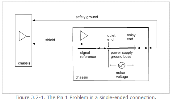

It is the bussed ground that is the cause of noise, not the cure for it. See fig. 3.2-1, the noise from the bussed PSU affects the signal reference.

Fig. 3.1-1 shows the "bussed" ground that creates a higher voltage noise (created by the current pulses) than necessary. Fig. 3.2-4 minimizes this and avoids the connection across a noise voltage (noisy side to safety earth and quiet side to signal reference).

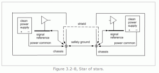

With earthed appliances (as we DIYers are forced to make because we cannot guarantee our creations are compliant to double insulation standards ) this is even more important because this noise voltage can drive a groundloop. From the same article: "Loops aren't bad, it depends on what's in the loop. Unless there is a voltage generator to drive a current around the loop, or radiated current into the loop, it is merely a parallel path. Consider the parallel shields of a left and right channel stereo cable."
The more I think about it, the more fig. 3.2-4 seems right. Esp. if you realize that the star drawn there is not the main starground. What seems contradictory is that the PSU star is both the low and high noise point. Left of the star is the high noise point (here flow the current pulses), right of the star is the low noise point (the current pulses don't flow here). In the star itself the currents in the loops left and right of it obviously flow together, but since this local star is just one very small very low resistance point, the current pulses can't create appreciable noise that would affect power common and signal reference.

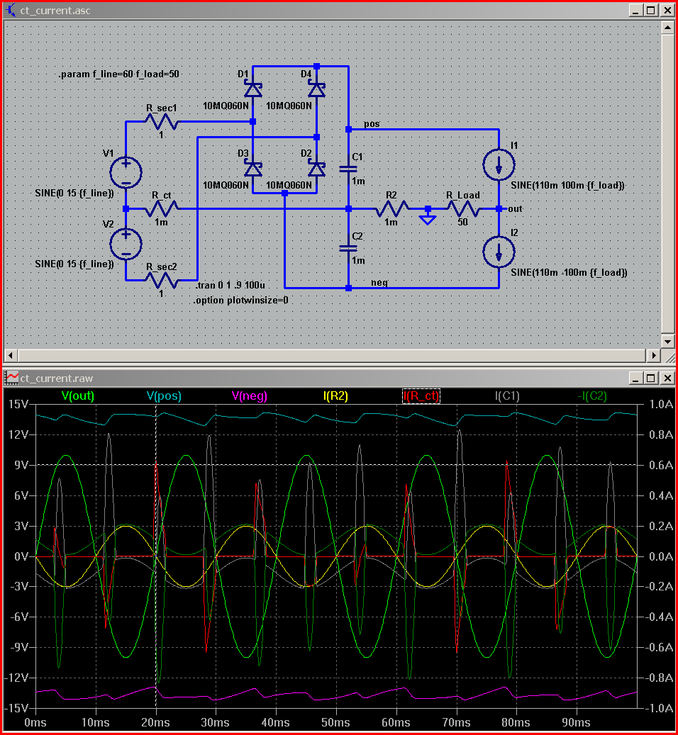

I simmed a sitation where even balanced Class A load gives CT current pulses - you have to locally "star" the CT and resevior Cap's "dirty gnd" leads - and use a single branch from that junction for the "clean gnd"

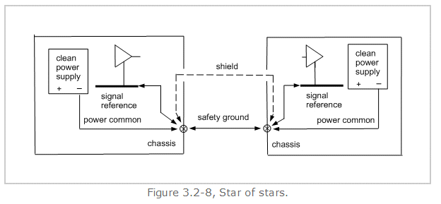

No, it is the connection between dirty ground and safety ground which causes the problem. Safety ground should be connected to the clean ground. The solution is very simple, and to be honest I am getting tired of how many times I and others have to keep saying it: keep charging pulses in tight loops away from grounds, and connect the ground to the clean end of a PSU.jitter said:It is the bussed ground that is the cause of noise, not the cure for it.
Connecting the transformer CT and all the caps to a star, whether it is a PSU star, safety star or (even worse) signal star just creates problems. You can minimise the problems by getting the connections in the right order at the star, but much better to avoid the problems altogether by doing it right: CT-caps ground should not go to the star.
