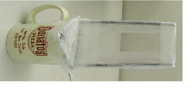

I built a speaker to these. I used a coffee cup, and a speaker that is a very good fit to the cup. Used some metal tubing as the posts to hold the plastic material. I used a sandwich bag as the diaphragm. It's all sealed together with clear scotch tape. It doesn't sound bad.

I used a cheap 3" full range 4 ohm speaker firing up. It is sealed around the coffee cup.
I covered the front of the speaker with tape, except the opening between the posts (the sound leaves the speaker, goes through this slot, then enters the baggie). Then attached the bag to the poles and sealed it to the slot with tape.
I drilled a small hole in the coffee cup for the speaker wire to exit.
The posts that support the baggie use the speaker mounting holes for spacing.
here's the coffee cup speaker.

Sound change - The speaker used is a low-distortion intercom speaker. It sounds remarkably well for music (200-7K frequency response). The bag limits the frequency response (looser bag gives better LF response, thinner bag gives better HF response)
The biggest change is the bipolar radiation pattern; it makes a more diffuse sound. It still 'sounds' like the same speaker, though. Sound quality of the driver is better in a direct radiating (normal) configuration, but is acceptable in the planar configuraton. I imagine that it could be quite good with some refinement (more attention to aerodynamics for the slot, and more rigid mounting - see the upright section below)
The 'uprights' can be made of anything; I used the metal, because it was already threaded. I would add a horizontal support across the top (you can see the bowing of my supports).

I made the speaker firing up, so that the magnet would be out of the way.
I made the poles the same height as the baggie, but there 'should' be some relationship to the displacement of the speaker vs. the panel area. Maybe just to be safe and limit distortion from the bag stretching 'non-linearly', the total displacement of the panel should be 5 (just a guess) times the displacement of the driver.
I made the opening to the panel the same as the width of the poles, but I think a flared opening into the panel would reduce distortion (turbulance).
