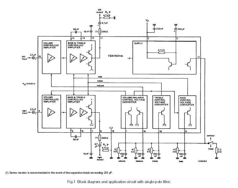

Last weekend I built a TDA1524 based tone control circuit ( I use Philips reference design). But it was absolutely fiasco! I cannot get any pot over mid level... When I get any pot to upper level it appears a big noise on speakers and no music! While they were %10-%50, the sound was clear. What's the problem? Did I make a mistake? Or the circuit is mistaken?

I already checked PCB and other connections. And I changed the chip ones. But as I can see in TDA1524s datasheet, it amplifies the signal @22dB! with full volume... At full volume the pot sends 4.5v dc to chip. And it makes 22dB. But if I can limit to 2.5v, the gain reduces to 3dB. Does it cause the problem?

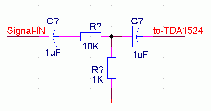

I use the same circuit in my amplifier and I had the same problem.
The divider worked like charm!

I ve been using internet for quite sometime now and trying to get help through discussion boards always made me sick, as the people who know anything tend to behave like GODS, but DIY Audio seems an exception here people serioulsy try to help people out, my Hats off to people maintaning the site, Jeans Idea of usinf a divider at the input is excellent, I just gave it a try and beliven me it work more than just fine, only side effect you need to workout the proper combination as to how much u want to divide down input voltage. But it is definitely worth giving a try.

I really did not understand what did you say! But I tried the microjean's signal divider! And it works... But I cannot say its a perfect way to tone control... May be I can divide the dc pot driving voltage.. Or you can say more?
