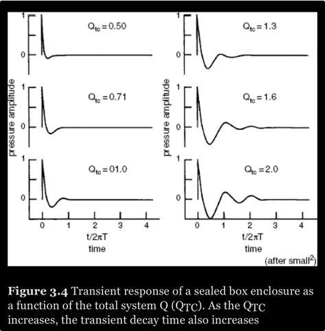

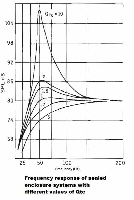

Is there a rough guideline as far as where the QTC of the box should end up. I think I've read somewhere between .55 and .6, but I've read a lot lately.
Should I chose .707 or .577 when modeling a sealed enclosure in Winisd?
Most of that is hogwash once you place the sub in a room. Your measurements with REW in room trump everything. Basically, you get a smidgen deeper extension with 0.577 (if you need it) and less pass band ripple with 0.7. Don’t sweat that detail. Sweat the in room measurements. And it’s not like 0.577 sounds super tight compared to 0.7. That’s all handwaving subjectivism folklore based on theoretical ideals (which don’t exist in a real room that has room modes, etc….).

.7 is the maximally flat Q while .557 is the most extended bass response. If you are using DSP I would go for .7 and use the DSP to get lower. With no EQ the .577 gets lower but starts rolling off much higher but since the DSP can fill the lower end in use the .7 so you don’t waste power putting back what the .7 already has and just boost the ultra lows.

Most of that is hogwash once you place the sub in a room......... And it’s not like 0.577 sounds super tight compared to 0.7. That’s all handwaving subjectivism folklore based on theoretical ideals (which don’t exist in a real room that has room modes, etc….).

Nowadays, mostly yes, but those of us that mostly built corner loaded systems it can matter, though overall these charts are sufficient.
