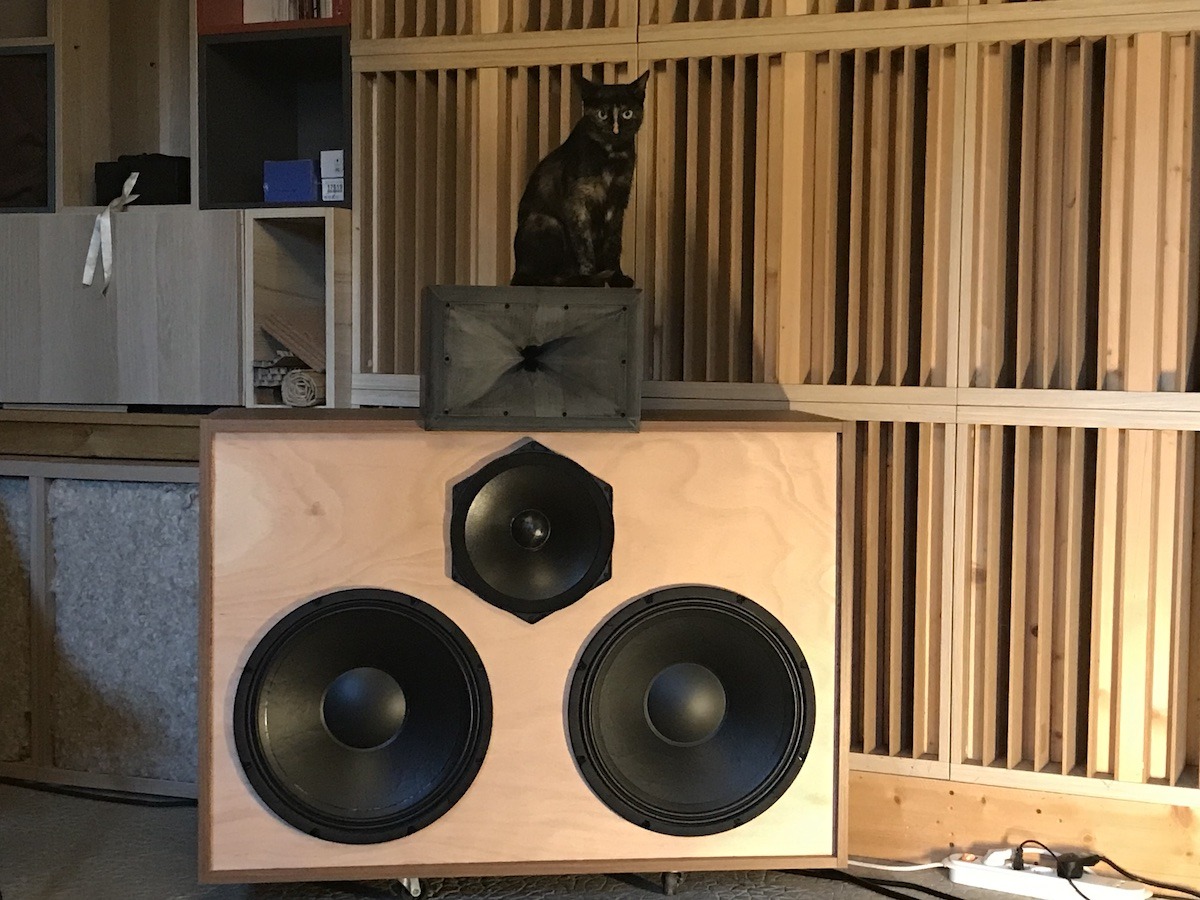

Hello guys, I wanted to share my last build, maybe get some feedback.

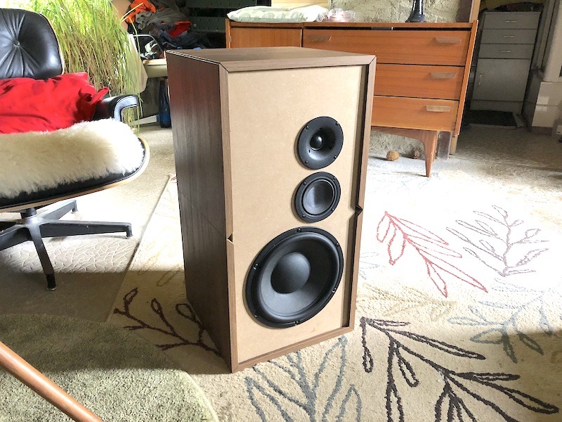

I initially started with a simple 3 way sealed, classic look that I like, reasonable size as I thought I wouldn't need much SPL.
First prototype was not very pleasant.
Build a second one a little bigger, not much better.
It felt weak, not enough presence in the room, no filling/no feeling.
I'm sure it could have been better with a lot of tune work but it was just not a good enough starting point.
So, for the time and money involved why not go nuts with the biggest I could fit in the room?
Always love the jbl 4350 serie, so this was the first inspiration.
And really love the Pitt & Giblin stuff, this was the kick in the back I needed to decide for a 3 way sealed with horns.
In the same time Nicolas opened his online shop on Audio Horn so after discussion I went with the X-28 with roundover option.
2x15" woofer sealed for the bottom to try sub-less first, and allow a future port if needed.
Studied a bit what kind of woofers could play nice in a sealed box of 100L, at reasonable prices, and went for the SB 15OB350 (very cheap and the simulated response was not much better with the 15SW800).
Then what kind of midrange could play nice between 200-1500Hz with this horn? The PHL3040 seemed a good fit, among others.
I could have gone with a more low midrange oriented one but wanted to try.

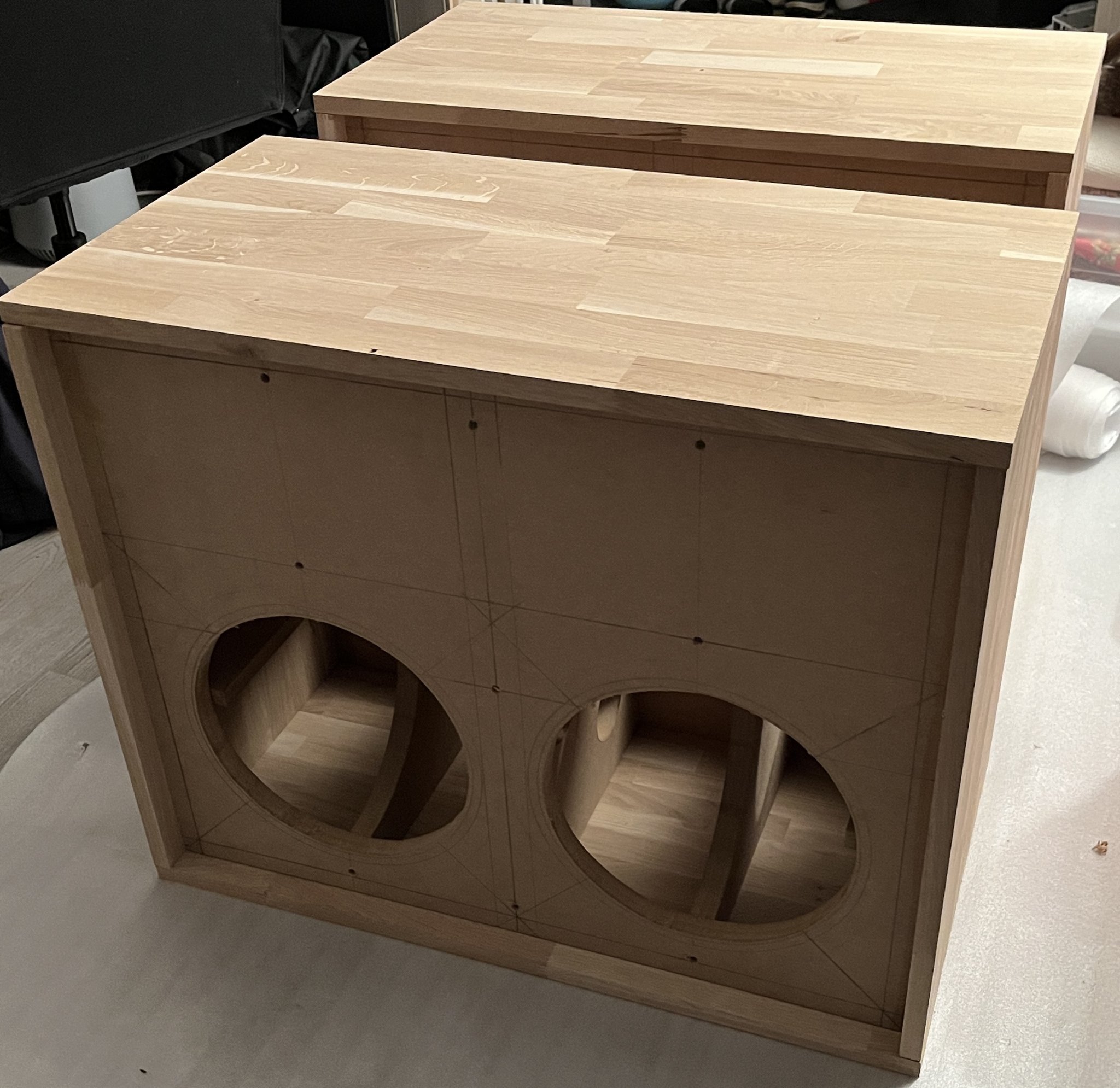

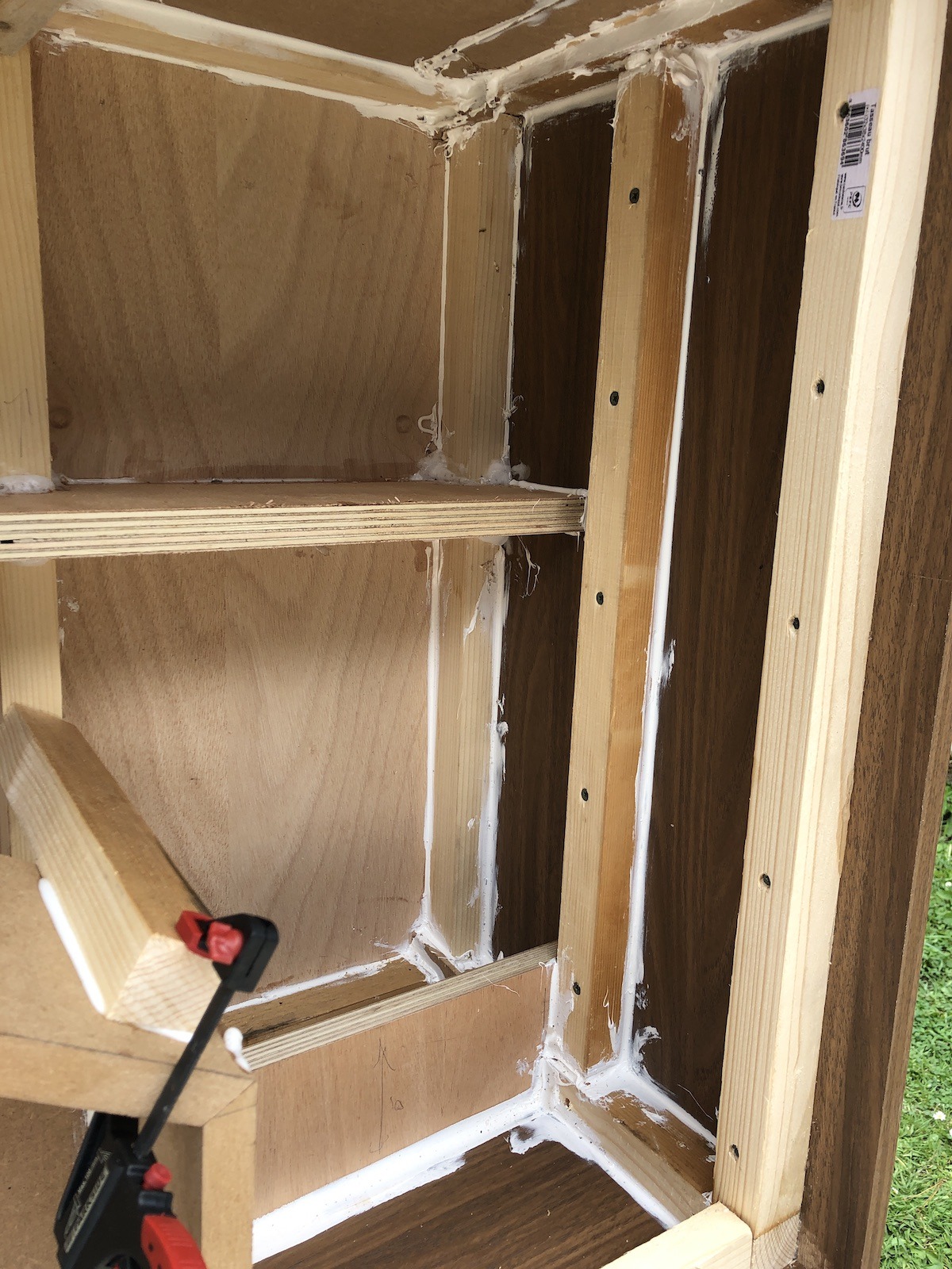

Construction was fun, I'm very impatient and usually start with minimal plans, my way to deal with surprises during the process.
Very useful informations were found online around the jbl : plans, clones, video build etc so I had a good idea how to do it.
I also have a limited wood work knowledge, practice and tools, so I again went the ikea route, for a good enough finish with minimal work.
So I took some door panels, full particle boards with a fake but nice walnut finish, for the outer box, and Eket boxes resized for the horns.

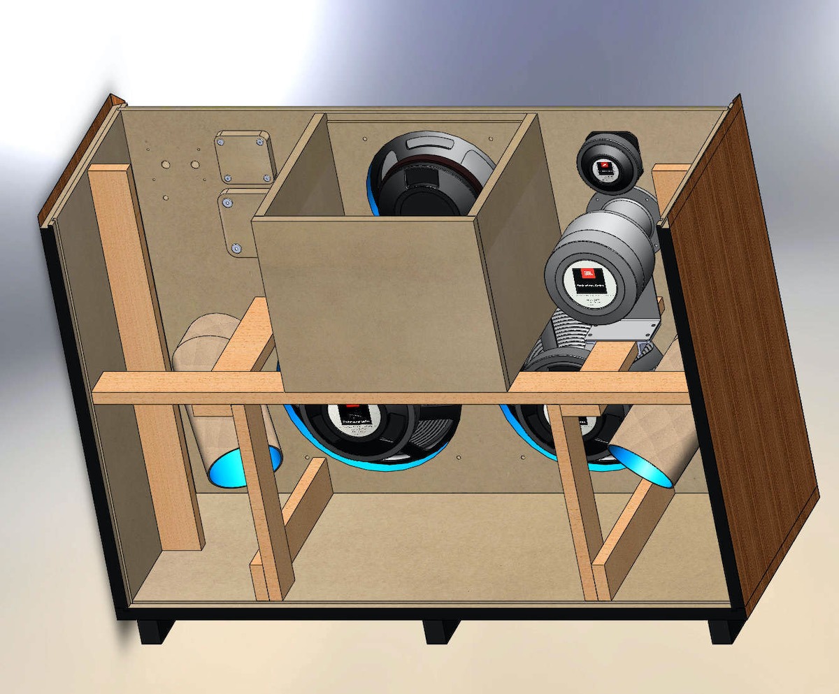

22mm plywood for front and back, with mdf as second layer where needed + bracing.
100x70x40cm, 280L outside and around 220-230L inside, with a 15L. box for the midrange, bracing very similar to the the jbl, all panels in their longer length + support around the woofers. Kind of light bracing as a start, that could evolve if needed.
Bought few tools to get a nicer result, a little router that was very easy to manage and surprisingly strong enough for the big holes, and a plunge saw with rails for better cuts as my regular circular one didn't cut straight on longer runs.
I've built one at a time and was ready for 3 thinking I will mess the 1st too much, but fortunately it was ok and I was able to do 2 very similar in a row. The second one is a little cleaner on edge cuts and details but is 95% the same I'd say.
To do better I would have to study real wood working, or ask for help.
It sure could be built better but it is solid, where I thought it seemed a little weak I would just add some wood.
If I redo one I would go even bigger as finally their size is fine.

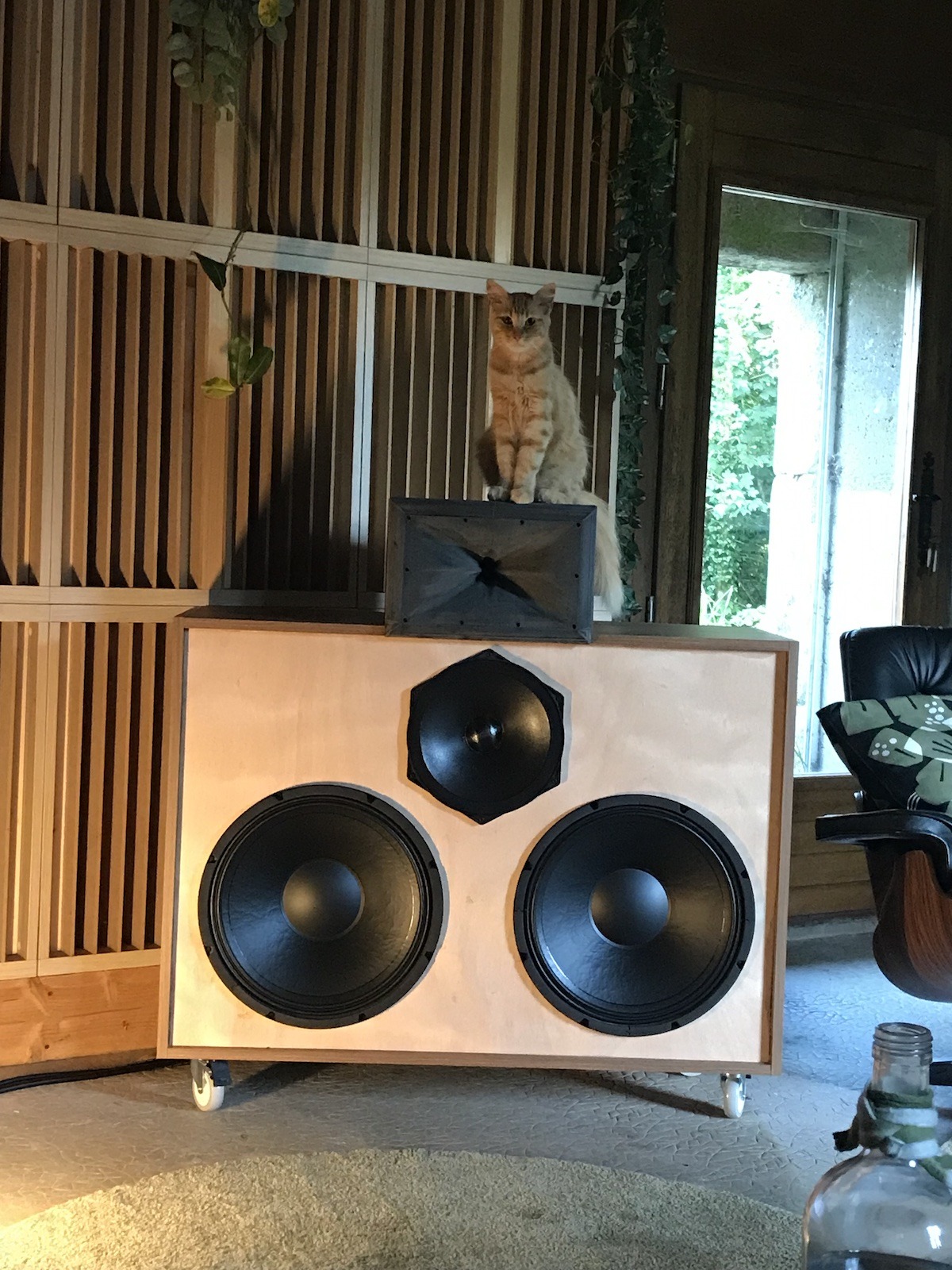

Few pics of the boxes:

Very nice system!
I would definitely test more with damping. For midrange I would test lining all panels with thick felt 9-12 mm. Then add pure lampswool. I guess around 250 gram would fill it entirely (Same as Troels Gravesen use).
For Bass you would have standing waves. Should be rather clearly if you take out one woofer and speak/shout with head inside cabinet.
If you haven’t done so, I highly suggest you work with proper simulation, splicing near field and farfield. VituixCAD have excellent guide.

I'm also planning to build a system with the PHL 3040. What's the volume of their cabinet? Good to hear you can use them as high as 1400Hz.
The midrange box is around 15L, minus the 4L of the driver it’s near 11L.

Forgot about the cd, it’s an 18 Sound ND1TP in 16 ohms.
I usually go with Faital but I just followed Nicolas’ advice for his horn.
It's fine for a final 24db slope but a little steep "naturally", I should probably have used bigger for more flexibility, or future potential drivers.
Just checked and I didn;t save them, but I’ll share more next time I tune.
Didn't try much higher than 1400Hz, just enough to merge into the horn response.

Which compression driver are you using?
Will try, right now I’m focused on the mid/horn, switching between LR12 and 24, very similar result, but the LR12 is still less optimised in eq.
I didn't want the woofers to go too high, to keep male voice in the mid, also by habit because with previous system the dual opposed woofers were not clear near 300hz.
But now I could try, they’re on the same plane, ctc is 50cm so should be good, it would probably add some « thickness".
I don't have the hypex anymore, the CDs are the 18 Sound ND1TP in 16 ohms.

What did I say about the cats...
