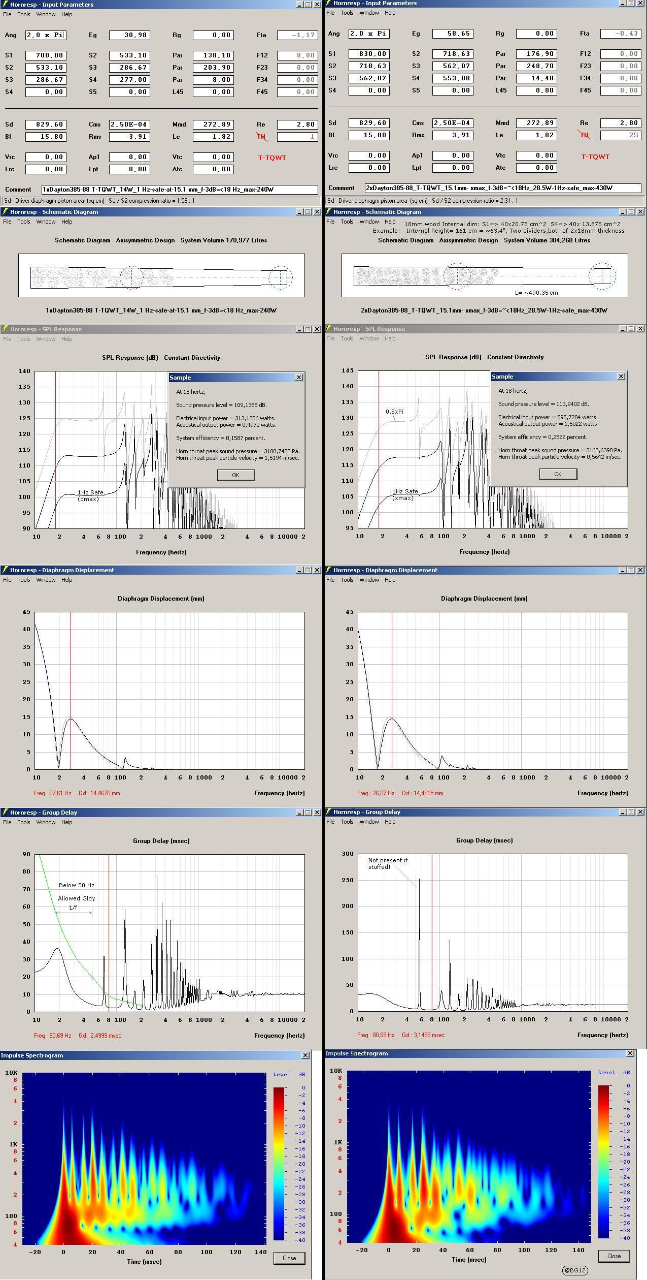

Hi guys, I've got four SD315-88 Dayton subs which are doing quite well in about 4cf per driver tuned to 23Hz but my amp has no subsonic so I'm always a bit cautious and because I've got it tuned a bit low, my 50-80Hz bass is a bit weaker or has lost a bit of power handling.
So I am now thinking of doing something else. If I was to get four of these 15" drivers, can I expect the best of both worlds? Lets say 4-5cf sealed per driver? Extension down into the upper teens without worry of drivers unloading and also have good output elsewhere?

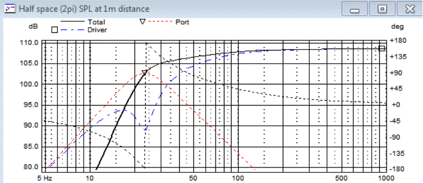

It doesn't sound to me like you're current set-up is lacking in its ability to go loud, nor do you have a problem with deep bass extension. Tuning the drivers that low in such a large cabinet is giving you an extended bass shelf alignment, which does have a slowly decreasing output in the area you are saying is lacking. Usually this isn't an issue with subs because the frequencies are low and room gain usually compensates fairly well.
Before pulling out the wallet and throwing serious cash at the issue I would try optimising the current set-up.
The first issue you've got is with the potential for damaging the drivers at very low frequencies due to you lacking a sub sonic filter. How much power does the amplifier have that you are using to power them?
The other issue is with the lacking output in the 50Hz region.

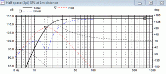

Currently your response should look something like this.
And we can see why you might be experiencing the problems that you are. There is also the chance that room modes might be working against you.

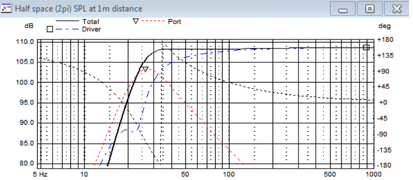

The easiest way to fix the 50Hz issue is to increase the port tuning up to around 30Hz and this will give you something that looks like this.
It should help solve the one problem but due to the higher tuning frequency makes the problem of the driver unloading at sub sonics even worse.

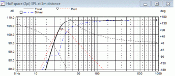

The third option however is to introduce a high-pass. A simple 2nd order filter tuned to 28Hz with a Q of 1.26 will sort things out and you end up with something like this.
The high Q nature of the filter introduces a hump in the response that corrects for the loss around 50Hz, but it also protects the driver from any over excursion issues due to the driver loading at sub sonic frequencies. You can implement this either with a simple active filter built around an opamp, or you could build a PLLXO instead.
Now as you can also see from these sims, the driver isn't suited to reproducing bass down to 20Hz. If this is your goal then you will need to change to another driver, but first I would try correcting the problem with what you've already got.

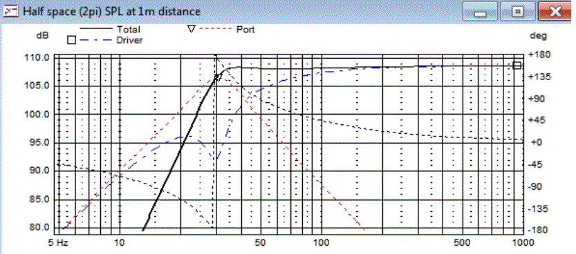

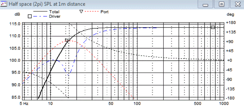

In an 8 cu ft enclosure, 30% fill and tuned to 16Hz, you get a response that looks something like this.

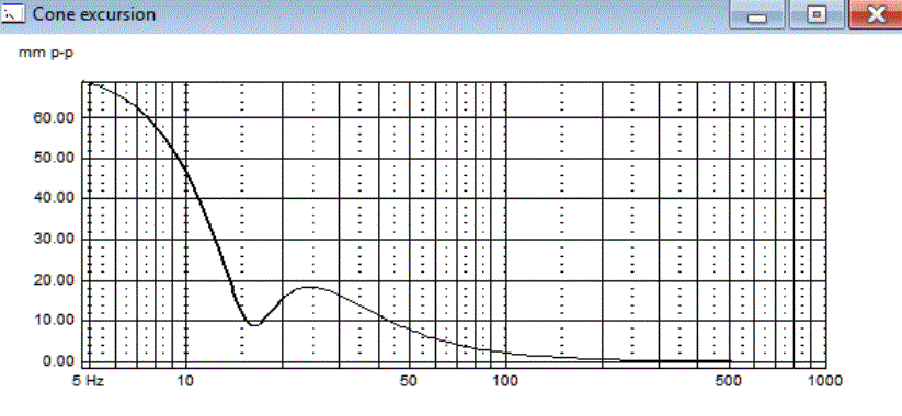

Given your amplifiers output voltage capabilities, the low tuning frequency also gives control over the drivers excursion down to around 12Hz. That's if you wire them in series, which I am assuming you would.
I'd still recommend a sub sonic filter at 10Hz or so though just to be safe.
Of course the driver you linked to would most likely do similar things, but if this were my money I'd go for the driver I linked as they have more advanced motors and occupy a pretty nice place as far as value for money goes, after which you end up very much in the realm of diminishing returns.
Within the capabilities of your amplifier, a pair of those will give you THX level bass reproduction down to 20Hz in room and with plenty of Xmax to spare.

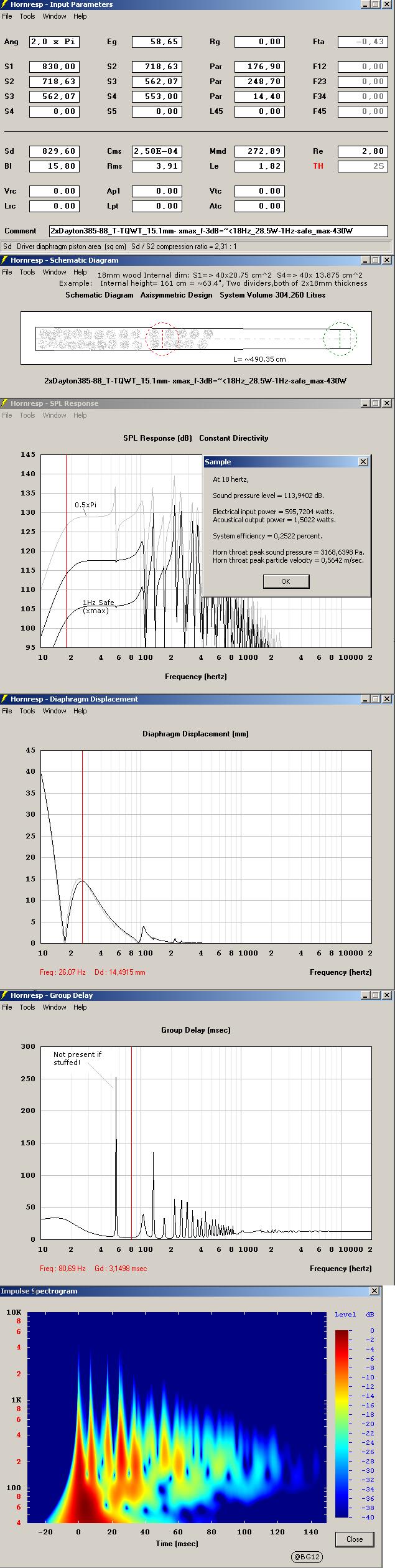

They would fit in this enclosure suggestion:
b 🙂
Okay so i just got a new car and some of the trunk dimensions are 36"w x 28"d x 18"h.
could this thing be folded to fit in that space?
... got a new car and some of the trunk dimensions are 36"w x 28"d x 18"h...could this thing be folded to fit in that space?
No, Simple DIY calculations: Your mentioned internal volume using 0.75” wood is only ~247L.
You need at least 304L internal volume for a dual driver box, but a single driver requires ~171L = ~6 cu.ft, IMO good for home HT-use.
If built and installed in a car: Problem that may occur is exaggerated FR at the low end if not tailored with a suitable HPF.
I would instead consider a ~80 L closed box that would have a f-3dB at ~41Hz for a single driver.
