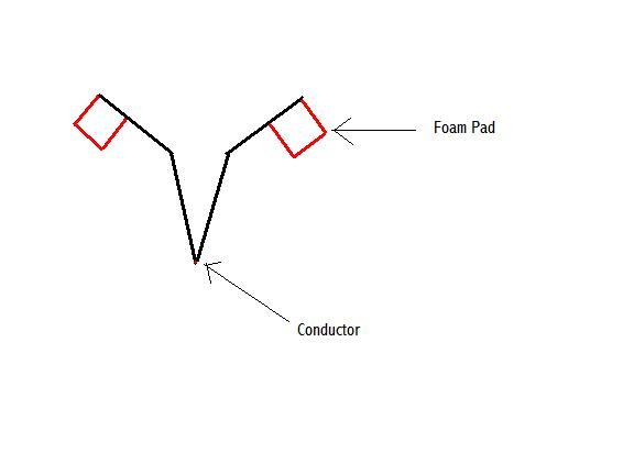

I read about Andre`s planar. It realy looks promissing. Is it corrugated like: UU (just two curves) or UUUUU?
Omni low frequensy Heil is interesting (magnets available to buy?), but at first I should do wide ranger.
André´s magnetostat has a flat diaphragm that rests on foam stripes. The conductor has no turn.

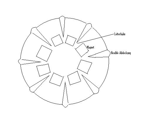

Some years ago I thought about an AMT-like onmi myself, but my doubt was that the contraction of the whole construction overlays the air motion coming out of the folds. I can think of two solutions: textile/rubber across the folds or foam on the cylindrical parts.
el`Ol said:Some years ago I thought about an AMT-like onmi myself, but my doubt was that the contraction of the whole construction overlays the air motion coming out of the folds.
Why do you think there will be contraction? Half of the pleats move one direction and the other half move in the opposite direction. There is no net contraction, unless I'm missing something here. BTW, this isn't a new idea--look at Figure 11 and 12b in the original Heil patent:

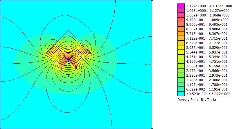

el`Ol said:This kind of magnetic circuit is quite linear:
But probably Neil Davis will tell us that the mechanical linearity is a mess.
Only if that is true 🙂
It may be possible to design a linear suspension for ribbons that will allow higher excursions. But the simple design used in the conventional planar, using the tension of the diaphragm as the restoring force, probably isn't going to ever give good results for large excursions.

My starting point was that for a large AMT the gap would be to big for the usual magnetic circuit, so my solution was that there are many gaps and every gap contains only one fold (picture in post 7). Result is nat neither of both movements (fold contraction vs. cylinder contraction can be neglected, so one of them has to be removed.

Principally everything that is used for cone drivers. Maybe paper that is treated with a roller to do the foldings. Beware that paper has a fiber orientation. With aluminium or polymer I would glue textile on the stripes to do a flexible connection. Beware there is almost nothing that glues polypropylene. Best suited are probably modern compound-materials, e.g. aluminium with viscoelastic polymer or glass fiber mesh with Rohacell foam.
