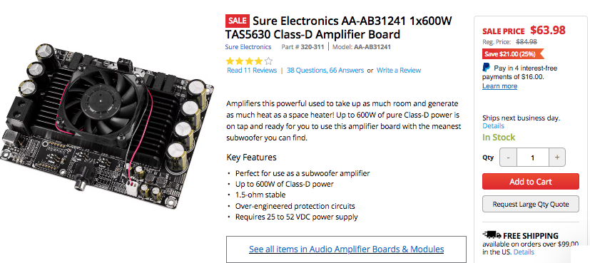

I inherited a subwoofer in a nice cabinet. The plate amp is junk. I don't want to buy an amp. There are three boards. One for inputs, one with controls (I'm assuming that is the equalization, and the amp itself. The equalization board has two tiny wires going the amp. I would like to connect those outputs to one set of the RCA jacks and the driver to the other two. So what I need is a really powerful mono transistor amp kit to power the thing. Any Ideas?
Something like this 600 watt Class-D amp:
It requires a 25 to 52 VDC power supply, which you might salvage from your plate amp or a computer, or purchase along with it.
52 volts and at least 500 VA of transformer.
Unless you think your really gonna put 600 watts into a speaker then more like 600 to 800 VA
Assuming 600 watts is a Class D fantasy and more like 1% to 10% distortion at 350 watts
Then 500 VA is more than fine.
There is of course switch turd power supplies, depending on the rating buy one that is twice the rated fantasy power.
Then you get the actual real world needed power for normal listening around 60 to 150 watts
and not have the class D amp or switch turd supply overheat and shut down.
So like many others you can get away with a relatively weak switch mode supply.
Or just use a tried and true overkill linear supply that lasts 25 years not 3 to 7 years 12 if lucky
and wont overheat on party nights or loud movies
