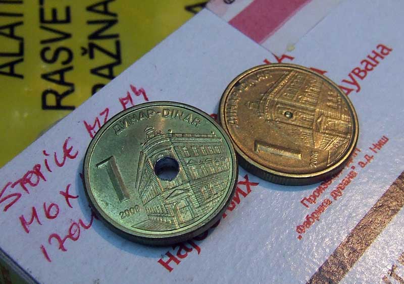

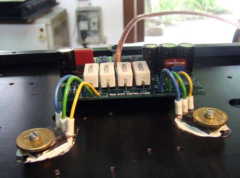

I've noticed on the Pass products the use of oversized washers on output devices to help spread out the force of the mounting bolts. Are these standard washers or special order? I like the idea, and would like to use it on some of my amps where the output devices are blowing a lot of power.

In the Phils we have this 5 centavo coins made of 6% copper. if you buy regular steel washer they charged you 25 centavos..much expensive than using the coin...hehehe
