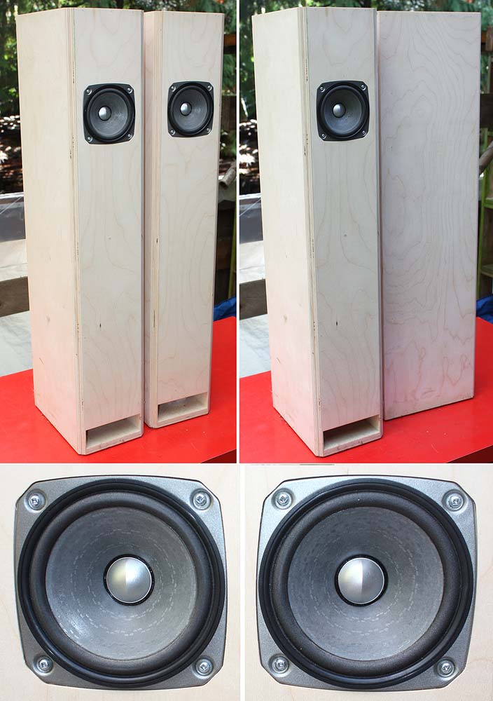

So Im wanting to create a BIB speaker using Fostex FF125WK.
I have no woodworking skills apart from being able to rout circles so figured a cylinder would be easiest. No problems cutting circles into the side of a tube either, and have worked out how I can mount the driver at the appropriate level.
BIBs are traditionally narrow and deep, but if the volume is correct will a cylinder also work alright? Or does the mouth at the top have to expand for the BIB to work?
Im thinking I won't be able to achieve that very easily, but should be able to insert a piece of somewhat flexible wood into the cylinder to double the line length. It's just that it wont be expanding towards the mouth.
Anyone any experience with BIB cylinders??

It would be very tricky to cut the slanted divider needed plus i’mnot sure the geometry would work. Doing an ML-TL is going to be a lot easier.

¾” material
Internal HxWxD = 35.5in x 5.5in x 9in.
Zd. = 7.125in.
Vent 5.5in wide x 1.875in tall.
Stuff cabinet 0.65lbs ft^3 dacron or similar & adjust to preference from there.
A removable back will make that easier.
GM:
FWIW, my take on it with a more typical 38” ear height:
L = 56”
SO/SL = 40”^2 – recommend ~ 5” x 8” golden ratio
zdriver = 18.5”
zport = 44.875”
dport = 3”
Lport = 2.5”
All dims i.d. and recommend lining top, one side and back with 1” acoustic fiberglass insulation or similar.

Thanks Dave, but are we talking about a box here?
Cos I can't build boxes, don't have the skills and have no intention of learning how. Think Homer Simpson's spice rack; that's my level of building ability.
But can the dimensions be used to get the volume of the box and simply translate that to a cylinder? I've built lots of stuff using plastic and cardboard cylinders and kind of know my way round those.

No. Convert the width x depth to an arra and use that to tell you how big a pipe you need.
ie for Scott’s, 5.5 x 9 = 49.5 in<sup>2</sup>, Using ∏r<sup>2</sup> one gets an r of 4”, so you need an 8” ID pipe. Plug the top and bottom so that the internal height is 39.5”, mount the driver down 7 1/16” from the top and a 5.5” x 1.875” (or the circular equivalent) in the bottom piece (which ideally is ¾”). Raise it up off the floor 2 or 3” and you have the ML-TL.

Yes, 35.5” internal height.
What you are building is essentially a Pensil125, but since Pensil is reserved for Mark Audio, we call it L-Stylo125.
