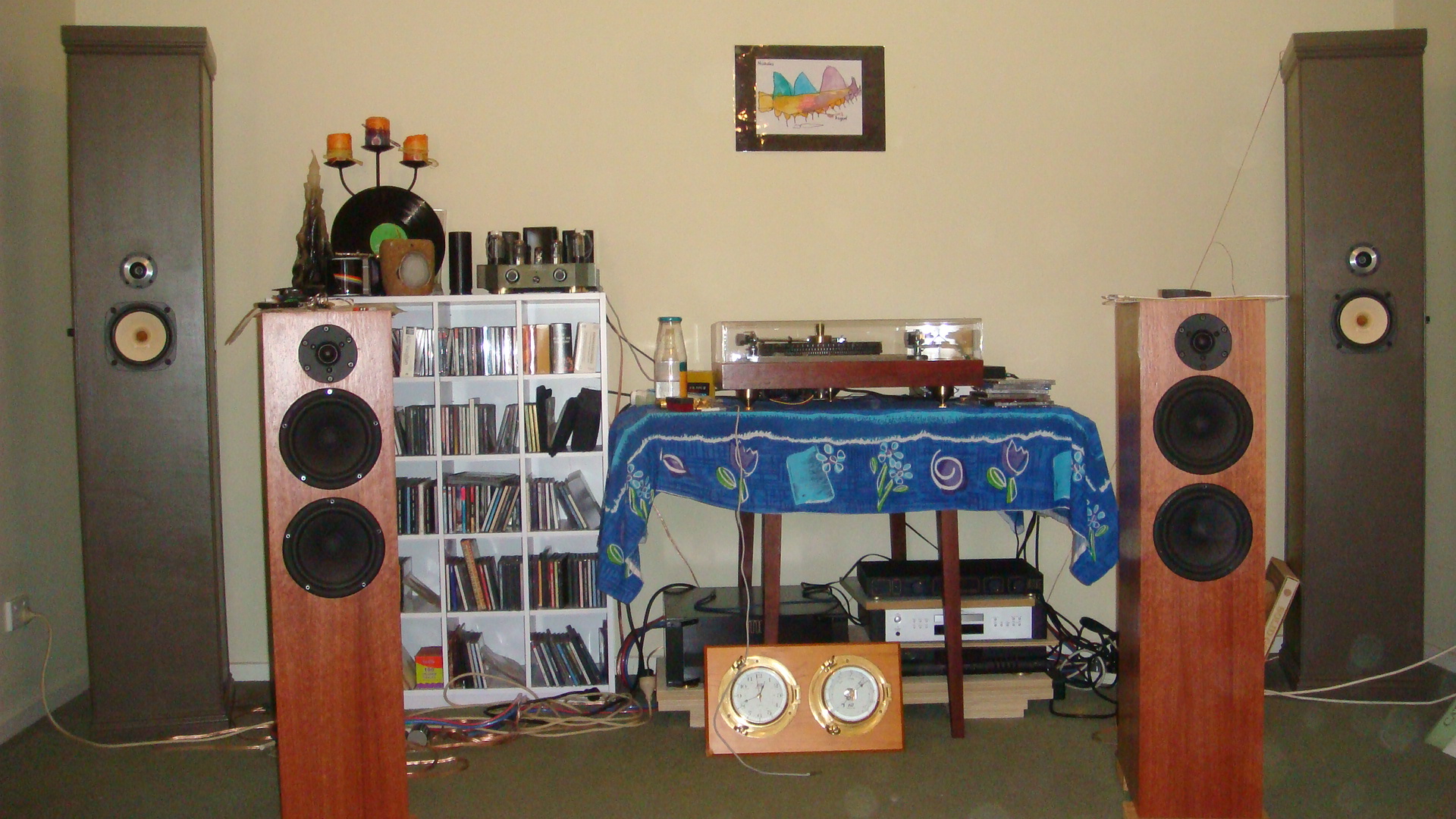

Hi Guys: Here's picture showing how close I ran my BiB to both corners and walls. To say that the sound was excellent is actually not expressing it clear enough! Especially with Planet10 wave guides implanted! If you do go through with building them...don't do what i did and sell them! My god, I regret that deicision!
Rgds: Dave
Hello to Zilla, Dave and Scott and GM, well, all of you! I haven't been on this site for ages!
