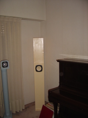

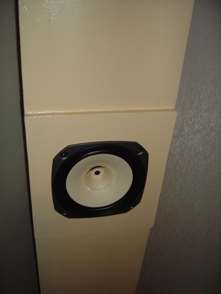

ok here's a pic,
been listening for a while, the bass is big. The 167 seems a bit congested with voices, and soft and rolled off in the highs. maybe the closeness of the divider is muddying things.Put some carpet and polyester fiber behind it but im still not happy. Had to make an adapting plate for the driver to fit.
ok here's a pic,
Give the drivers a hundred hours before making any significant changes & get them to Xmax a few times, which should help loosen them up.
What other damping material have you put in them?
hi scott,
maybe I should wait a lilttle as you say. from the sealed end till nearly the top of the driver is filled with polyester fiber. Behind the driver and to both sides I sticked carpet. I was concerned that the drivers would not breath correctly with the added plate which gave the front baffle 27mm of depth. So i cut the hole in the plate with the 45° position in the jig.then placed the little baffle over the original hole and draw it. then cutted again at 45°, so the driver hole is expanding at 45° towards the back.I putted some poly fiber at the expansion too. at the botom of the speaker I placed some foam and that's it.
Sounds about right. You baffle and hole-cutting logic is excellent. That shouldn't be causing any problems. As I say, give the drivers some time, and give them a good thrashing with material loaded with big dynamic swings.
If they're still not improving, my suspision is that you might have overdone the damping. The problems you describe don't sound to me like you've got reflection issues back through the cone. Conjested is not how they should sound!
Once the drivers are fully run-in, and if it's still not sounding right, my first tweak would first be to adjust the damping in one cabinet, and compare the two. Start with the foam: remove, and see what happens. Lynn Olson hates foam, he thinks it's a killer of musical life, in his Ariel's at least. I can't pass comment myself, as I've never used it, but something different at some point in the future might be a plan. Don't add any replacement for the moment however.
After the foam, try removing some of the damping material above or around the driver. It's a juggling act, but have patience & you should get there. Let us know if we can help.
