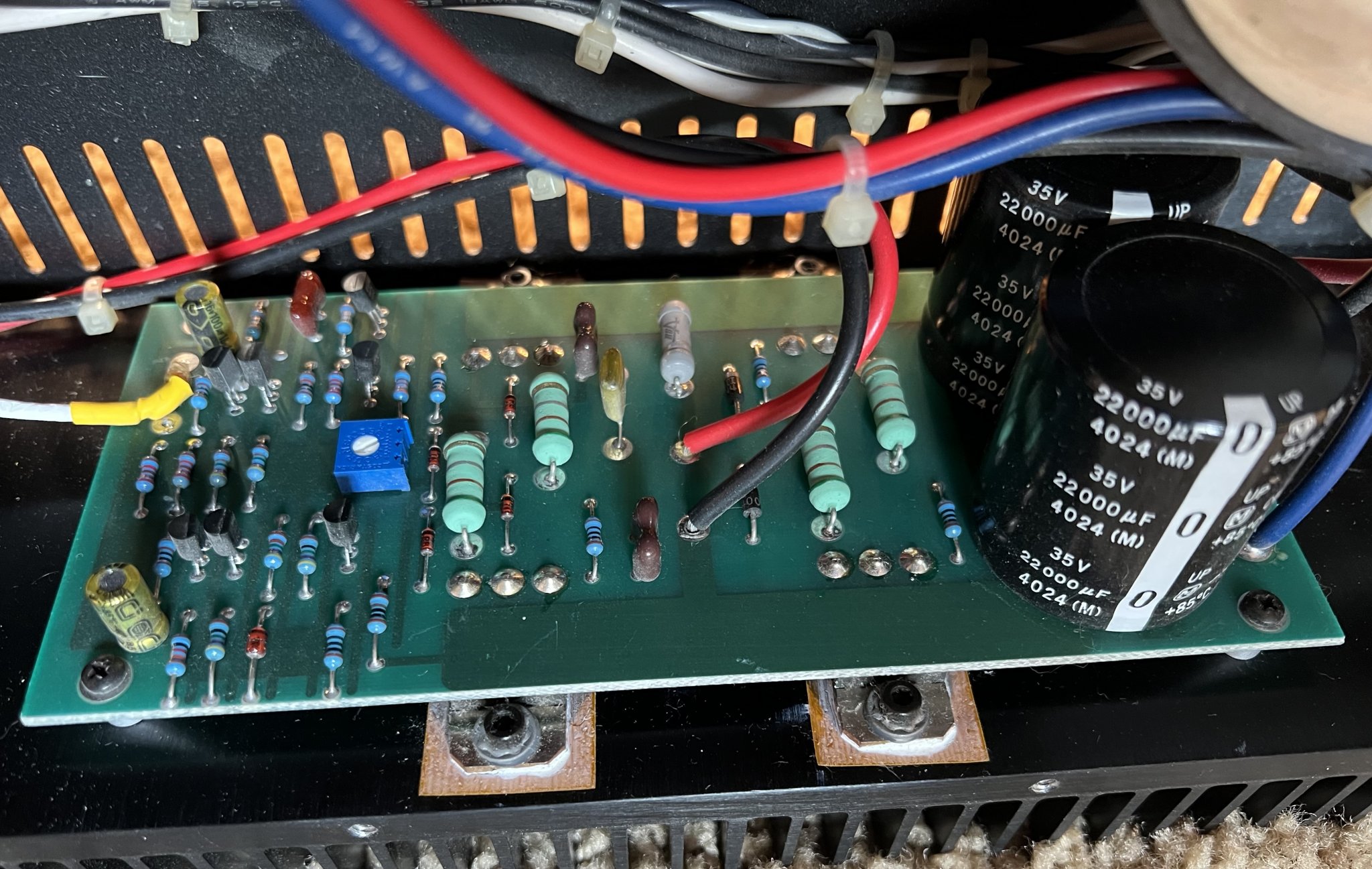

I also picked up an A20 several years ago, and while it sounds good, it never quite sounded right. Boxed it up and put it in the closet with plans to eventually get around to "working" on it (maybe a re-cap since it's getting fairly old). My notes from before I boxed it up show I did notice some DC on the left channel. Right channel reads 0.003V DC and Left channel is 0.31V.
Decided to poke around the web for A20 info and found this thread.
@saabracer23 - Have you tried reaching out to Cary yet to see what help they can offer? A service manual maybe? That was my next step. Also we must have slightly different iterations as I noticed some of the components in mine slightly differ.

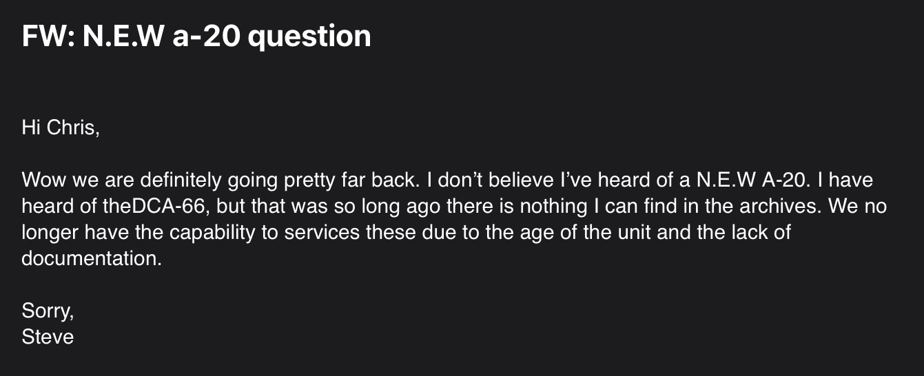

For all future readers I did reach out to Cary Audio and got a reply from Steve that they no longer service the N.E.W. Gear.
The notion that Cary Audio serviced N.E.W. gear came from an Audiogon post.
