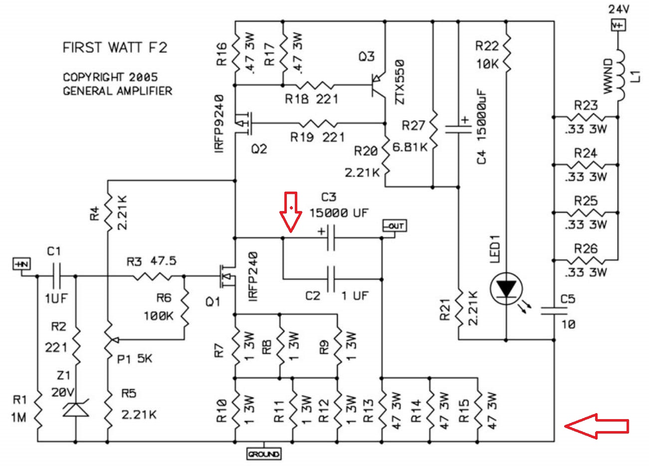

The end result you want is that the top CCS and the bottom part should present an equal resistance at ~ 2.8A such that they together burn ~ 67 watts.
And as the performance point we want is nicely enough at that point in the middle which is the red arrow with a dot in Zen Mods picture should have half the voltage of the rail. Or in short with 24V rails the half point should be 12V.

first - knowing where to put black and red voltmeter probe

I am trying to see if there is a shortcut rather than reading about the the whole website( will do it eventually).It should be something easy like put red prob at this point and black here kind of...
I know ZM does not want to give up that info, but someone else may.
set your DVM to range of more than 20Vdc
connect black probe permanently for this test- with alligator clip anywhere on GND potential ....... say on Out+ wire or terminal
put red probe on positive side of +24V terminal (other one is GND) , write down exact voltage , let's call it Ub
now put red probe to mid pin of Q1 (be careful not to slip with probe , it's easy to make short ) or even better , with small alligator clip to C2-P. and fiddle with P1 to have voltage exactly of Ub/2
repeat the same for other channel
that's it

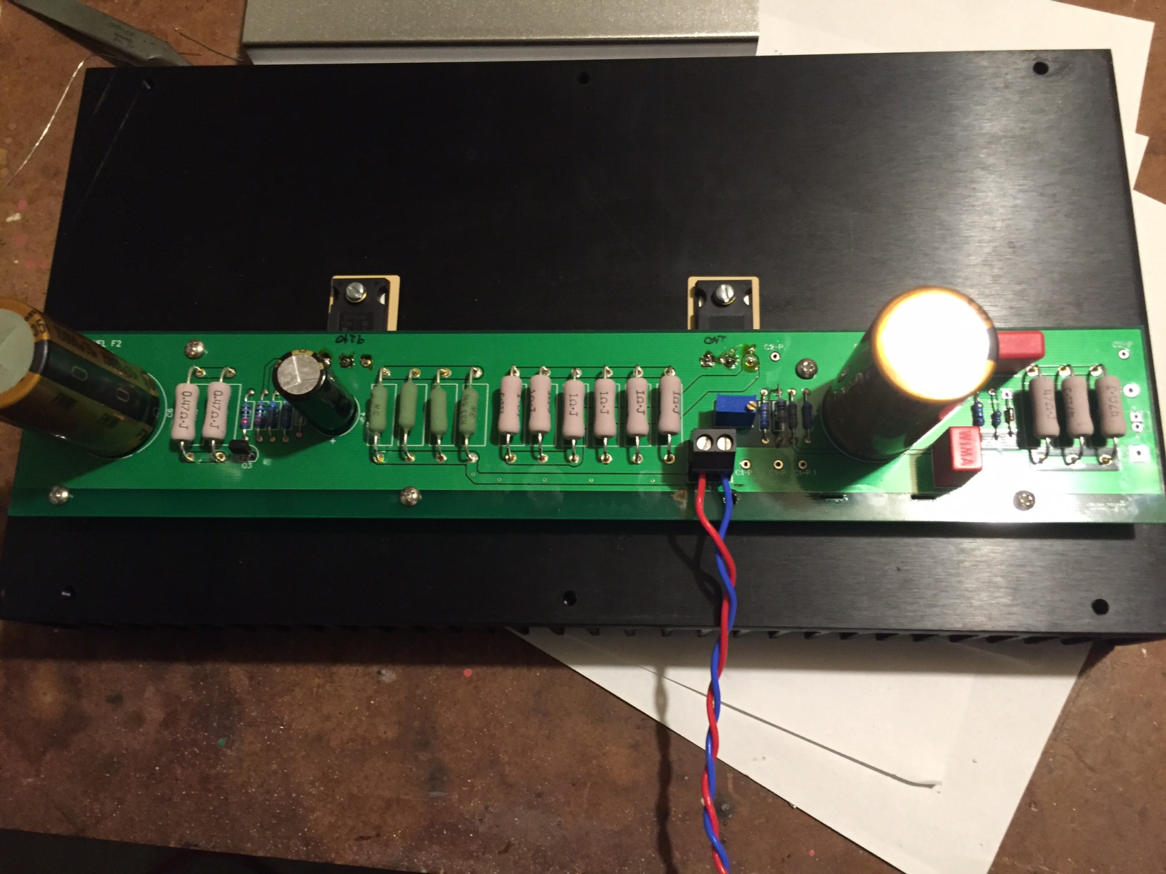

ZM, completed one channel,no smoke😀.Input Voltage 22.66V and Biased at 11.33V.Adjusted after 20 minutes to 11.12to 11.33V
Thanks for all your help.😀
