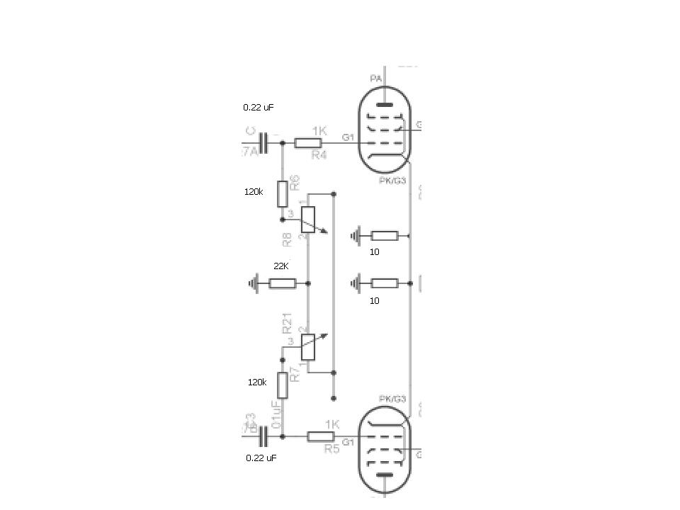

Hi ,
can't get voltage reading in bias pot ,
why is that ?
Thanks.
We need further definition of the problem......what you may see is that you run out of pot adjustment before obtaining enough bias current for the EL34's. This will require possibly changing a resistor value in the bias circuit. You will not need to change the cathode R, it's only purpose in life is to allow proper bias current measurement by measuring the voltage across it.
Have you been successful at getting your existing KT88's properly biased?
Another question that I forgot to ask earlier....do you have two bias pots? ie one for each output pair?
You need to adjust the bias pot to get around .5V across each cathode R; this is 50ma current (across a 10 ohm cathode R), a reasonable place to start with EL34's @ 400V anode V. This should require somewhere around -30 to -35VDC bias voltage on pin 5.
hi ,
yes it does have two bias pot , one for each output pair .
in the amp manual , it's said that the amp is biased between min 0.35vdc(35ma)
and max 0.40vdc(40mA) . i'm now biasing it to 0.40vdc . is it ok to bias the tube exceed the amp manual ?
in the bias pot i notice (2) 1k r (rgSeries) , (2) 120k r (rgParallel), (2) 0.22uF cap , 2 10 r(rCathode) , and (1) 22k r .
do you have any idea what this 22k resistor is ? i'm trying to figure it out.
the amp is wired in triode mode using 1k resistor in 47k resistor .
cheers ..
cheers ..
So with the EL34's installed, you ran out of bias adjustment before you could get .35V/35ma-.40V/45ma??
Can you draw/post a diagram of the bias circuit?
