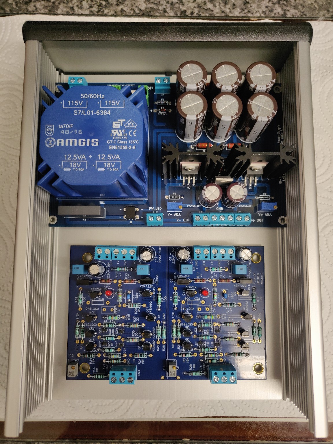

Another power supply I am in the middle of creating. This one is for my Wayne Colburn BA2018 Linestage build. This PSU is much smaller than my previous one and uses more modern regulators.
The PCB measures 160mm x 100mm and is designed to slide straight into the rails of a Hammond 1455T2201 enclosure. Just waiting for the boards back from the fab house.

Isn't the rectifier bridge too small?
Not at all it's good for upto 1.5A so half an amp more than needed. The regulators are only capable of 1A.

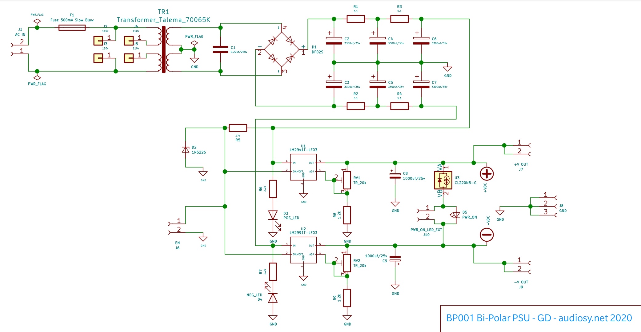

Any schematic for this?
There you go. Think it's time I made my schematic available.
Very nice work Gaz, these LM2941/LM2991 should get a bit more attention I think 🙂
Thank you and yes you are right, even Pete Millett uses these regulators in one of his power supplies which is what inspired my design in part. 🙂
