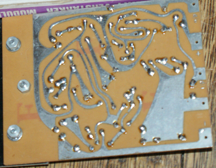

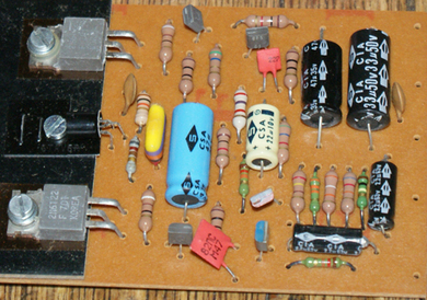

Should take you about 10 minutes to look at the board and draw the schematic from it.
Your right of course..😀

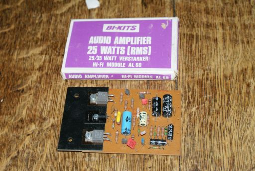

A few more pics found..🙂
I know the output transistors can be TIP41A<< I built this board as a big stereo one piece (DIY) years ago with a PSU, but I lost all the info..but the smaller ones..and the one in the middle of the heat sink..Good fun at the time..😀
The photo when expanded is about the same size as the original PCB..They don't exist anymore..

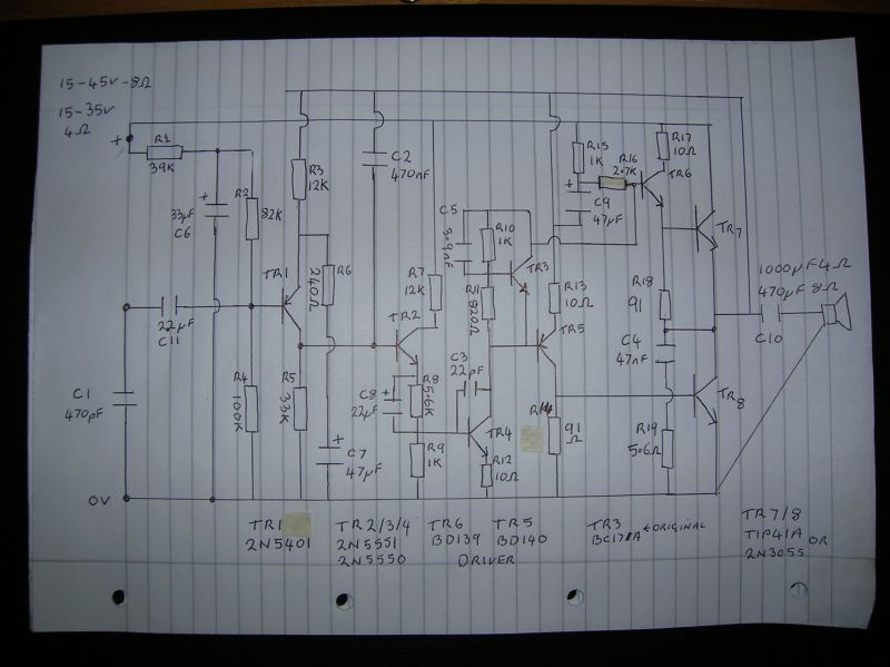

AL60 possible fun from the 70's
After a lot of help,
The original drivers were Tr5 BFS98 and Tr6 BFS61
Tr3 was BC171A<<in the middle of the heat sink.
In the past I used TIP41A output transistors.
Here is the result.🙂 Board traced out..what a PITA..😀
Transistors on the drawing are suggested types.

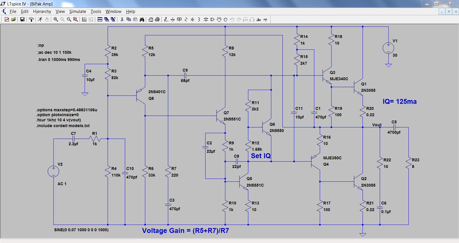

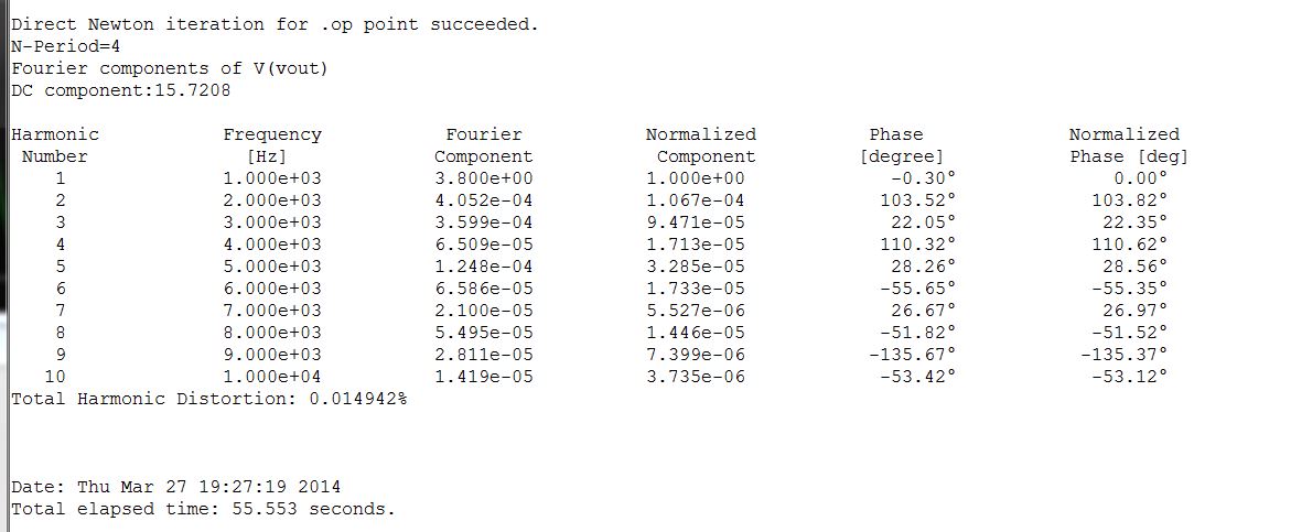

Just thought,
I would mention it has been modelled and the THD is very interesting..😀
Suggestions were to increase the output cap size to 3000uF or more.

A mod to increase stability,
0.22 ohm resistors are fitted on the emitters of the output transistors.

FWIW many sealed boxes will get along fine
with low output coupling capacitor values.
Basta! is good for playing with series caps.
e.g. http://www.humblehomemadehifi.com/download/Humble Homemade Hifi_Black Box_copy.pdf uses
600uF, and that could be the output electrolytic of a single rail amplifier.

You might be pleasantly surprised by just how good these can be.
The old electrolytics should be replaced and also the suggestion of M Gregg to fit 0.22 ohm emitter resistors could be worthwhile because the bias stability looks like it could be marginal.

I would say to just be careful with the bias setting. It suspect it will tend to increase sharply as the outputs warm, taking some time to reach thermal equilibrium.
