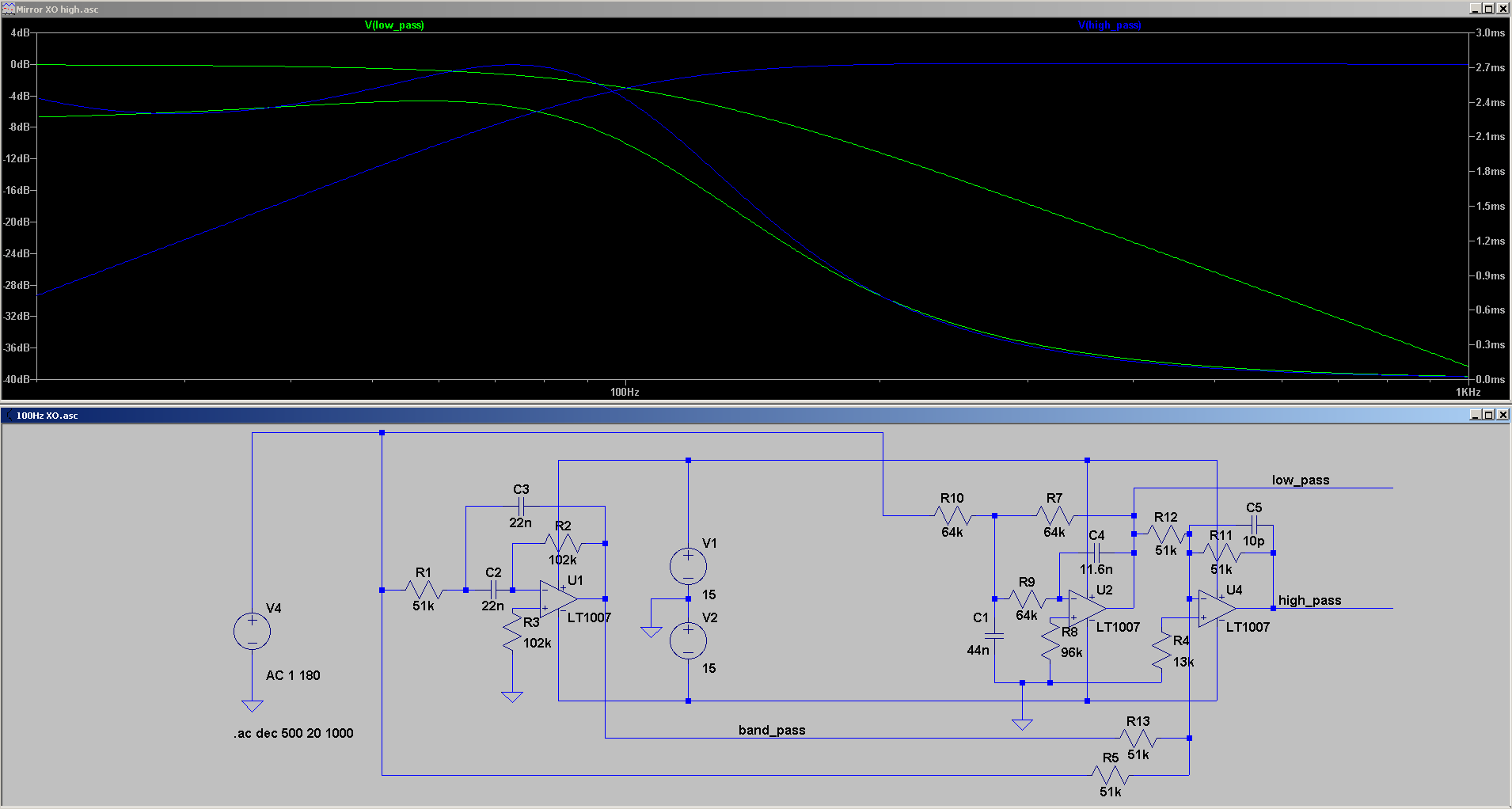

I am looking to bi-amp a pair of b&w nautilous 805 2 way spakers, and also connect a 12" sealed bass speaker(have seperate amplifier, but no xover) for low end extention.
I am after transparent and honest sound.
the system concists of:
Speakers
B&w 805 nautilus 2 wayspeakers
power amps
2 x 110w 8ohm newclassd green(tweeters)
2 x 150w 8ohms diy power amp(midrange)
2 x 150w 8ohm diy power amp(for bass speaker)

2) 3-way Active crossover
Using b&w original xover frequencies for tweeter/midrange xover and adding a hipass ot the midrange driver at 150hz to let the 12inch do all the work below that frequency.
+ full advantage of bi-amp.
+ Transparence of no passive filters?
- dont really understand the theori of active filters or how to design them or where to buy them.
still need to match tweeter to midrange and bass speaker level.

I cannot recommend any mucking about with a B&W Nautilus that cannot be returned to as new condition!!!!
Adding a high pass filter to the amplifier/s feeding the Nautilus will do no harm. It will simply cut the quantity of lower frequency information that you ask the Nautilus to reproduce.
Adding an amplifier to drive a low bass speaker cannot do any harm to the Nautilus.
Use Linkwitz Riley to guide you through the bass speaker project.
Why did you choose amplifiers with different voltage capability to bi-amp your Nautilus? Both sets of speakers terminals expect to see the same signal voltage, NOT different signal voltages.

I'd like to point out that plugging crossover frequency points into a active or digital crossover design will probably not have the same frequency response as the original passive crossover. A whole lot of things go on in a passive crossover that don't show up in the specifications or simplified schematics.
Andrews suggestion of passive bi-amping the 805s and adding a woofer with low level hi-pass (for the 805) & lo-pass (for the woofers) is most expedient. This is easiest to achieve with 2 identical amps for the 805 (one channel for mid/one for tweeter. This approach does not have the potential of full activem but will likely work better as the passive approach removes the need to re-egineer what B&W have done in terms of EQ and driver matching in the XO, a daunting task requiring knowledge of filter design and measuring kit.
One could fiddle with something like the DCX2496, but that unit would need extensive modification to bring it up to sonic level equal to the 805s requirements.

as a first stage in experimenting to find if there is a way to improve the sound you are currently hearing, then adding a low bass speaker and removing the low bass content of the signal sent to the main power amplifier and speaker, is the easiest experiment to carry out.
Tuning those two active filters with possibly some EQ to get the sound right will give you an insight into how difficult a job that is and show where your skills are adequate or not and can be improved with practice.
Then decide whether you can provide the resources to turn the Nautilus into an actively driven speaker.
Start with steps that give you a chance of success.
Many on this Forum start off with ambitions that are way above their resources and they have insufficient knowledge to even recognise that.

if i was to do that and ad a active highpass to the woofer section of the 805(get 100hz and below out of the 805)
100Hz seems a little high and won't be making the most of the LF performance of the 805's bass/mid as well as losing some directionality in the bass. I'd aim for a second order slope with turnover between 50 and 70Hz as B&W quote the bass roll-off -3dB at 49Hz.
You can achieve the required high pass and low pass to the bass unit with a three opamp configuration - a low-pass, an all-pass and a subtractor. I could even post up a schematic if you're interested because I've been designing one for my own system.😀
would that be possible without degrading the sound of the midband?
So long as your active filter's designed to be transparent, yes. No mean feat though getting that.
we all wanna fly before we can walk😀. that sound like a good way to gain further skills without to much frustration.
I know that 100hz is a bit high, but the speakers loose their focus and their lush sound in the midband when the driver simultanious has to handle both bass an midband when playing loud, thats why id like to try taking the thumb out ou of them.
By the way, its the on wall version of the 805, same crossover, same drivers, just different tuned cabinet, so it has -3 db at 60hz.
I'd love to se your schematic.
