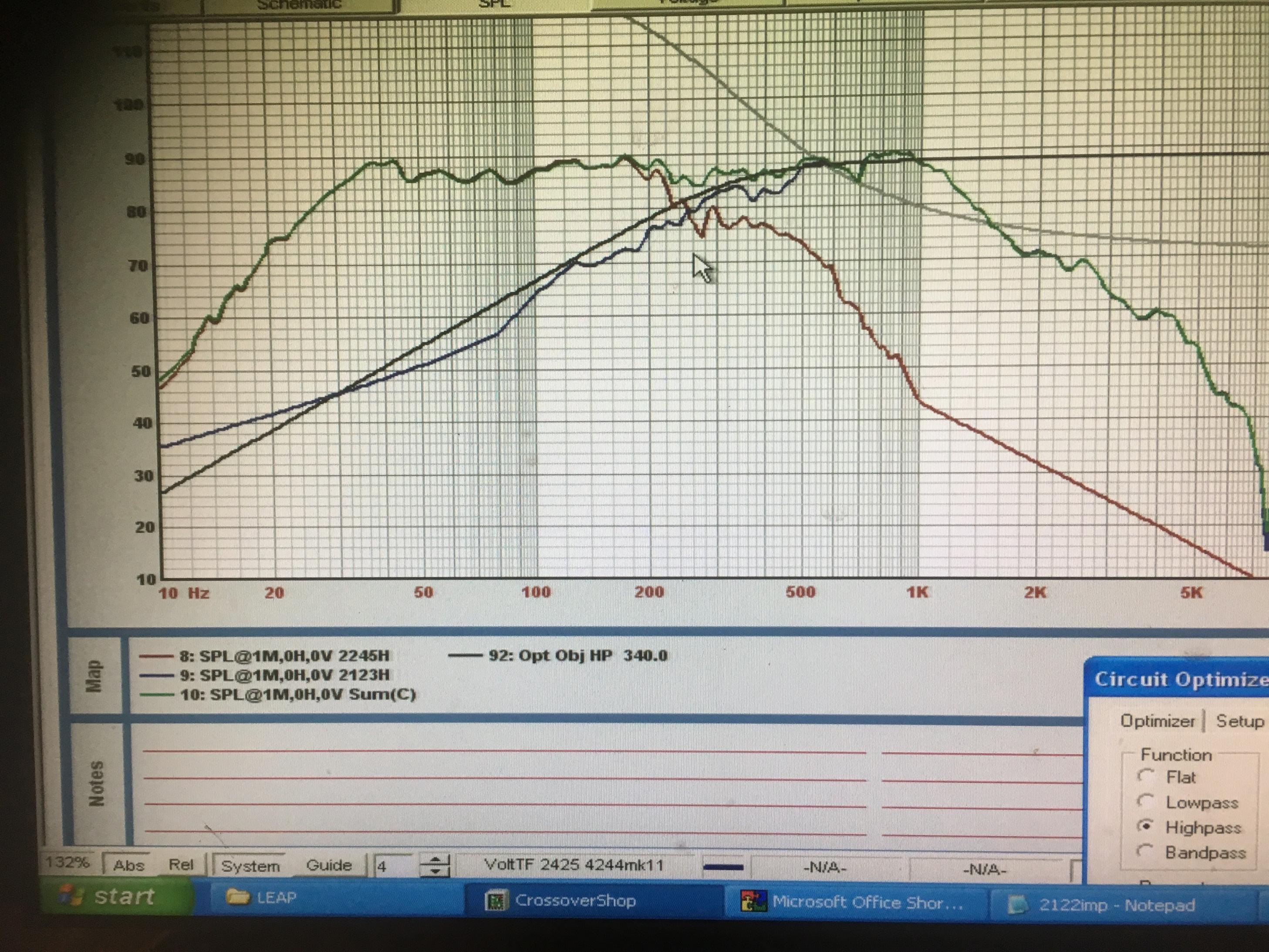

Hi Nelson
I actually measured the voltage drive and acoustic output of the 2123H mid range in this design and its overall a 12 db high pass slope.
The combined driver and LR network on the driver is 6db slope while the series capacitor adds the 2nd pole.
The woofer is a 2nd order filter
So the B4 could be set up for 2nd order low Pass and 1st order high pass it should be close to the passive crossover.
I plan to try with my B4 and will provide follow up
