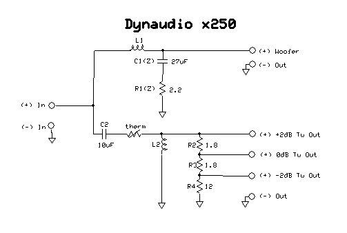

(pic of XO)

You should show the bottom of the crossover pcb and probably draw it out similar to the link below if you want a better understanding of what parts of the crossover are doing what.

For some reason, I can't get the crossover picture link to work. I can't even get Fiat Forum to load...

I got the picture to load, and it looks to be a 12dB on HP and LP with Lpad for tweeter and no impedance compensation. Pretty simple. If you can post a shot of the underside and the terminal labels, we can easily figure it out exactly.
The big Solen polypropylene cap is in the tweeter circuit, and the yellow electrolytic cap is in the woofer circuit. Chances are you can remove the cap from the unwanted circuit and the remaining components would be out-of-circuit if nothing was connected to the corresonding output terminals. Again, a couple more pictures would reveal all.

I have a pair of ADS crossovers that that have a very similar layout to this at least for the woofer circuit.
You will be affecting the sound as active crossovers and your passive are shaping the response differently. I haven't followed car audio for a while but 24dB/oct linkwitz-riley and 12db/octave butterworths were most common, which probably wont match the passives electrical response. It may even sound better using the active filter but I would use an RTA and mic to measure the affect.
The question mark in your layout should be a poly switch for protection of the tweeter.

Jonny,
Here’s a redraw of the schematic in a more “standard” XO look, using the part numbers you designated. The sections are very recognizable.
The 27uF and 2R2 are there to flatten the woofer’s rising impedance, and L1 is the actual first order filter.
First order filters are Butterworth filters with a Q of 0.707. This can’t be varied.
“therm” is the protection device.
C2 (10uF) and L2 are the tweeter’s actual filter while R2, R3, and R4 form the attenuator for the tweeter.
Being a 12dB/2800 Hz filter, using C2 of 10uF, L2 will be about 0.3mH. The Q, or response shape of the filter in the crossover region will be determined by the impedance of the tweeter in that frequency range. Looks like the MD100 is pretty close to 3 ohms around 2800Hz. That puts the filter Q around 0.53 with these component values. A Linkwitz-Riley filter is represented by a Q value of 0.5. A Bessel filter is represented by a Q of .577. You’re within a few percent tolerance of either.
So within a reason given standard value components, you have a 2nd order filter with a conservative Q in the mid 0.5 range at 2.8kHz on the tweeter and a 1st order Butterworth at 2.8kHz on the woofer. Assuming the specified 2.8kHz crossover frequency is close, that is.
All that said, I wouldn’t beat my brains out over choice of crossover slopes or trying to duplicate Dynaudio’s exact filter response. Looking at the x250 info on their website, it’s a bit generic so as to work with any one of 4 woofers. In other words, it would be pointless for the passives to have been designed/tuned with an exact target response in mind, with the infinite possibilities between woofer choice and installation variables.

Tim
Yet Another option:
The 7” woofer rolls off pretty smooth above 3kHz on its own. Let it roll off naturally, and only use an active section on the tweeter.
IMHO, a good quality active crossover really should have a bipolar power supply, the control features that you want, and be quiet. That’s about it.
That’s not to say it must have a bipolar supply, the ADS 642CSi was a well-liked 12V unit. It was a 4-channel two way but IIRC, had independently selectable F/R HP points and Q factors by DIP resistor pack. If that’s the case, you could HP the 7's at the sub LP frequency and let them roll off naturally on the top end, and the HP the tweeters at 2.8kHz & Q of your choice with one of these.
Tim
