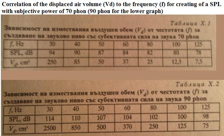

You could pretty easily find the minimum crossover frequency if you look at the response curve of your midrange or if you calculate the excursion limited SPL of the midrange.
So it depends on the midrange, for my taste the lower the better, but it depends on baffle step and the low range response too.
Sorry, but I don't have a larger graph for the correlation between the displaced volume per cycle and the frequency and SPL, you should find one extending at least to 500 hz or 1 kHz and it'd be good if you post it as i don't have such too.
Here below is a graph that will orientate you a little.
Generally you should take the effective area of the membrane of the midrange and multiply it with the peak effective excursion, if it is 200 cm2 and 5mm you should always multiply equal units (cm with cm) so it would be 200X0.5=100 cm3 maximal displacement per cycle.
Then you find how low can you go with 100 cm3 at the desired SPL 😉
Have in mind to consider one octave below the cut off point - for instance if you use 12 db/oct and aim to 100 db SPL, you should check if the midrange has enough displacement to cope with the demands of 88 db @ 1 oct lower
For instance if it has enough displacement for 100 db @ 200 hz, is it able to reproduce 88db spl @ 100 hz....
I have that kind of problems with an OB mounted midrange with first order crossover at about 200-250 hz... it just goes out of excursion at high levels because with 6 db/oct crossover it does 125 hz at -6 and 62.5@ -12 db - which would be 88 db total at 100 db mean system level... which is quite allot for a 6.5 inch midrange (actually it's allot for some 12 inch drivers too...)
