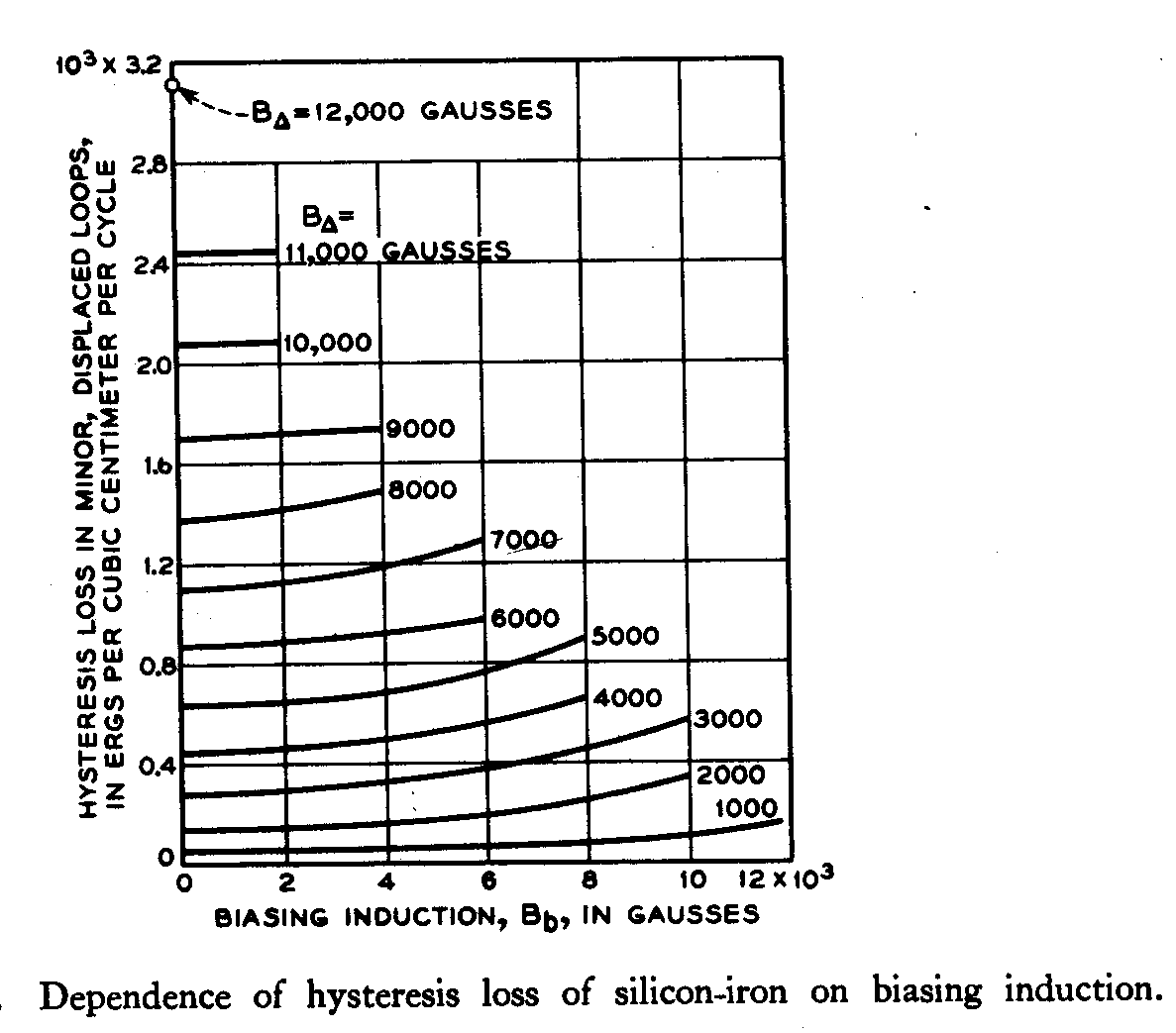

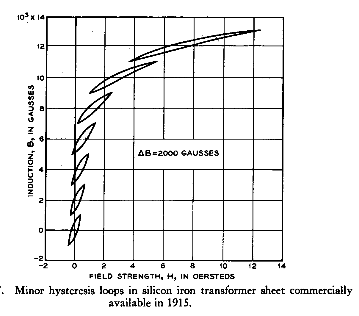

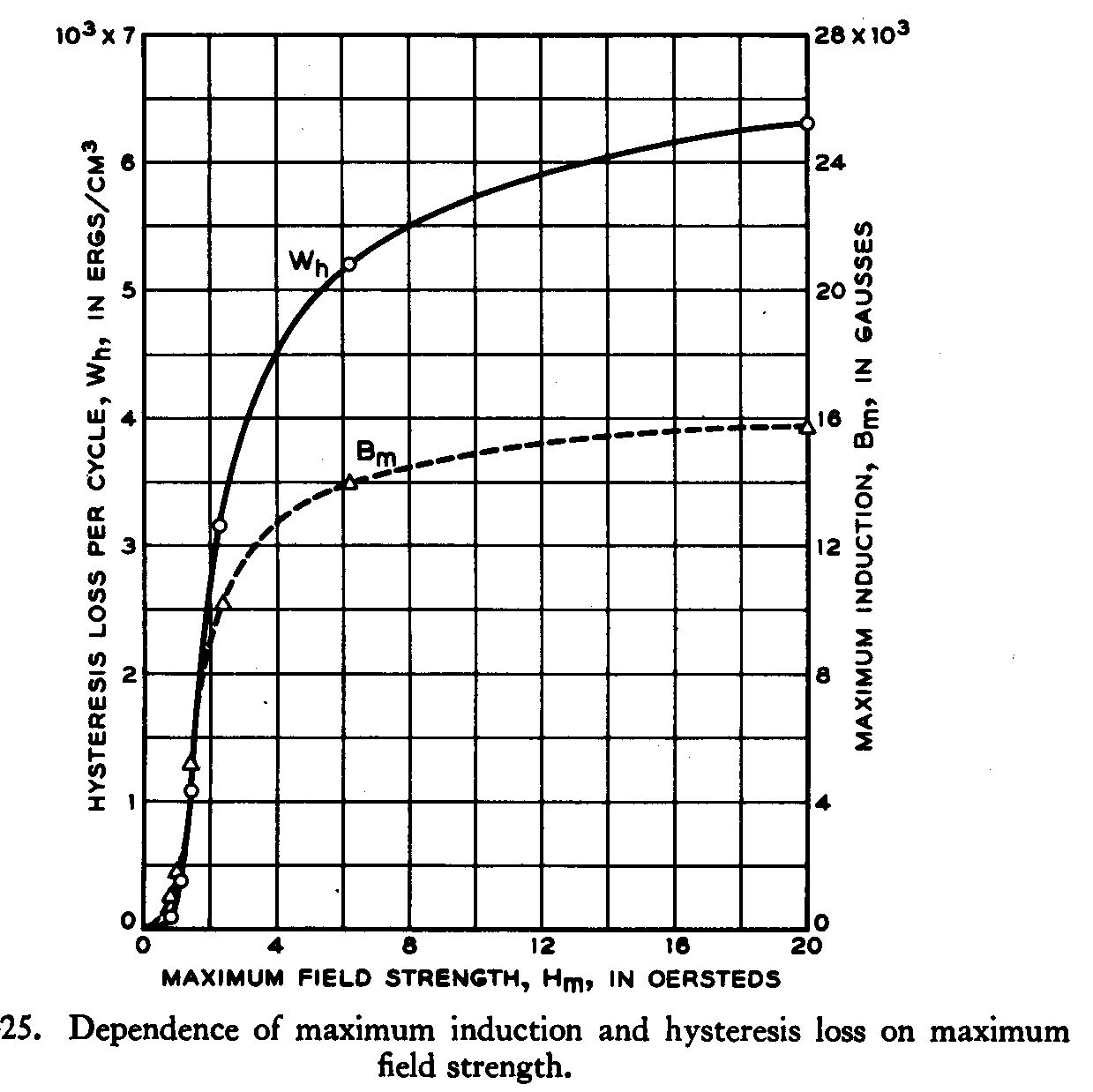

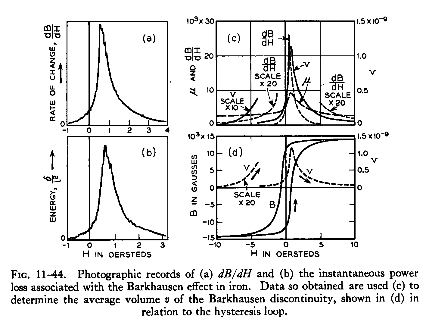

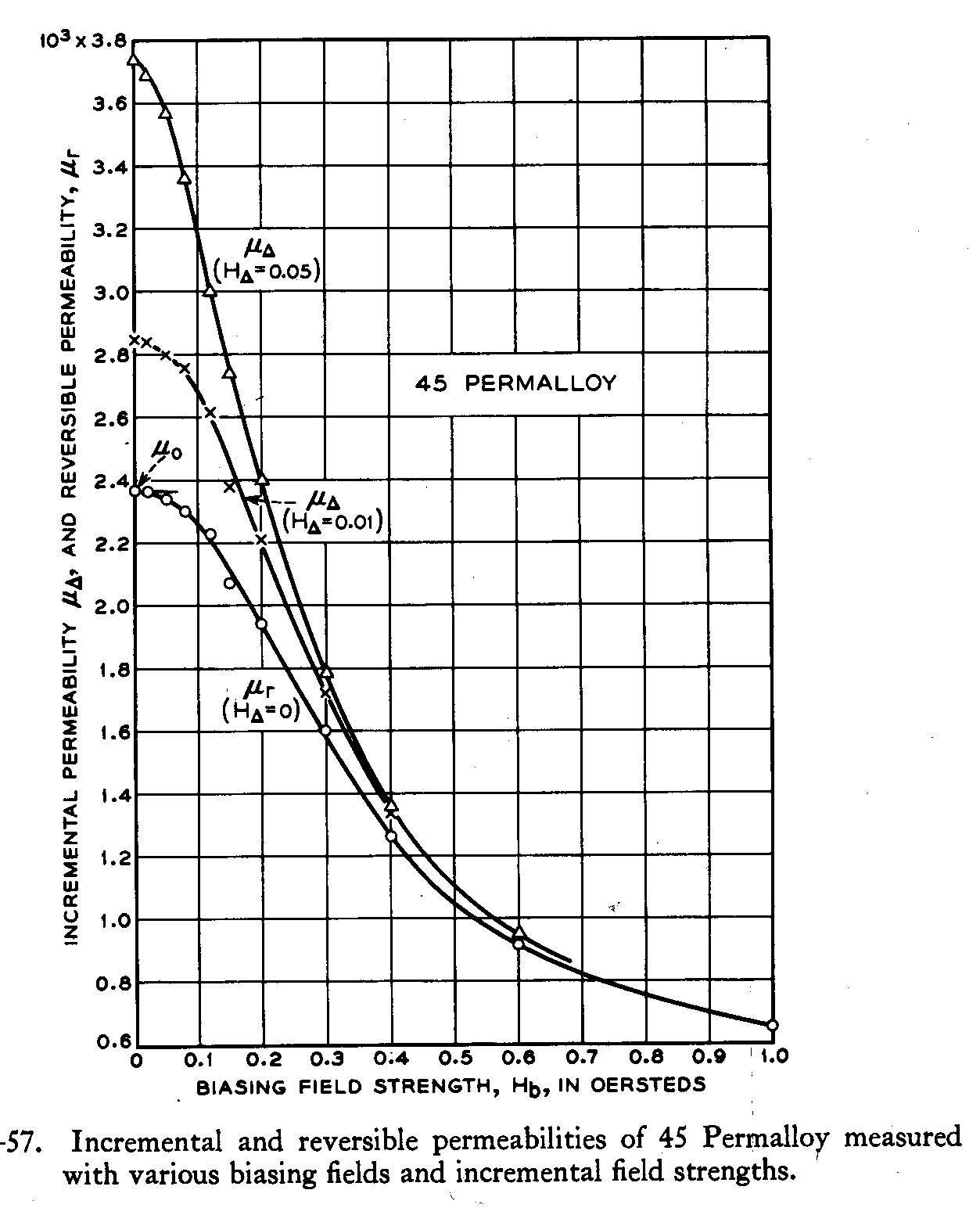

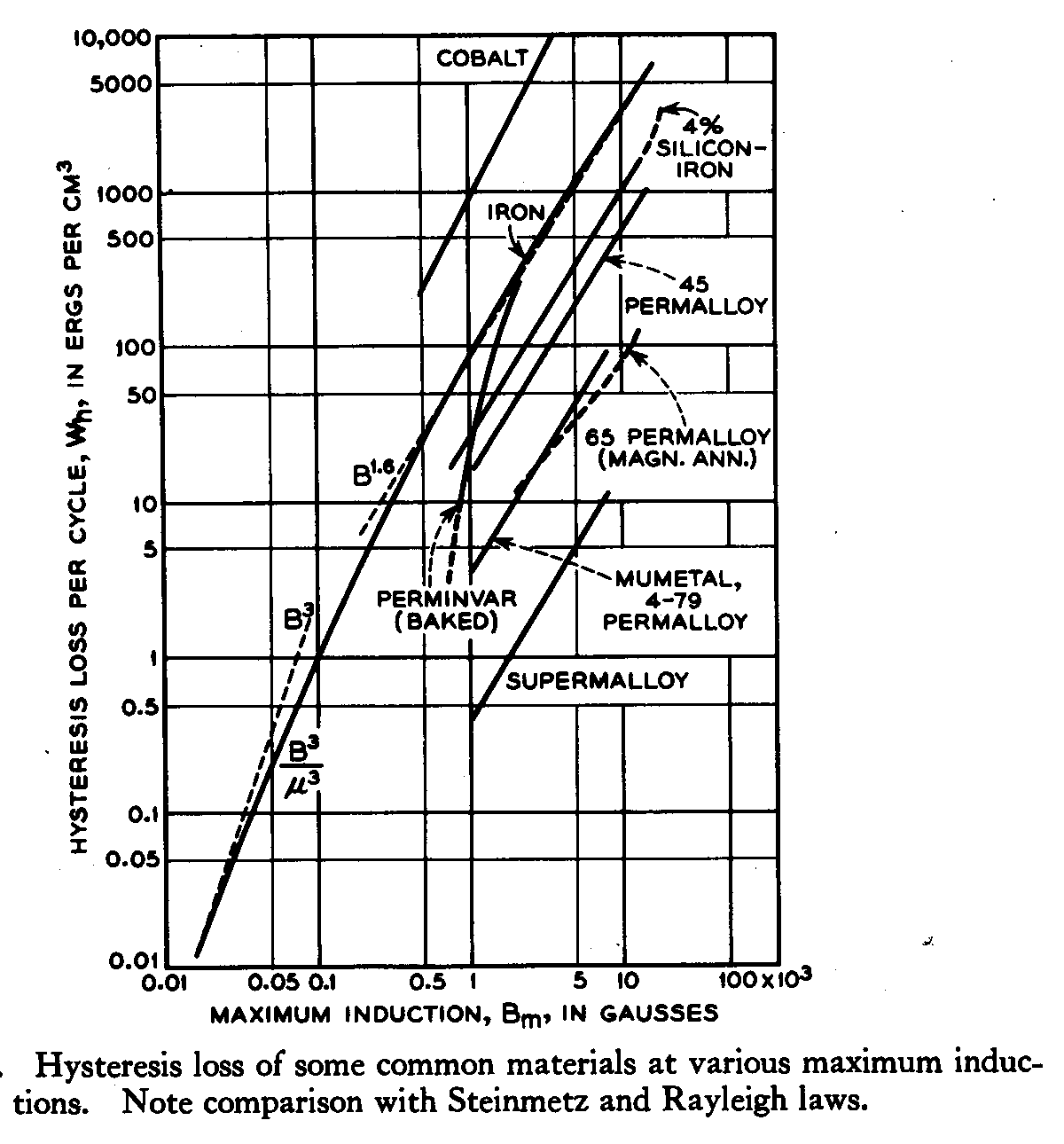

Some real data from Bozorth "Ferromagnetism" (the Bible on magnetics, all Ferro.. books refer back to this one)
Since the question referred to size of xfmr effects. A comparison of xfmr A with 1X core and xfmr B with 2X core area is in order.
Assuming same inductance, and related Zpri, Zsec and turns ratio for both cores and same voltage drive on the primary. Xfmr B will have .707 times as many turns to get the same inductances and related Zpri, Zsec. So flux density for core B will be 1.414/2 = .707 of core A. Core loss per volume scales at approx. 1.6 power of flux, so (.707)^1.6 = .574 However, core B has more volume, (1.414)^3 = 2.827 giving .574 * 2.827 = 1.62 times the core loss of core A. Eddy currents come out a little better since they scale as 2 power of flux. So a 1st estimate would be that the larger xfmr B has more losses than the smaller one for the same signal.
However, the larger core will have larger wire, so less copper loss too. With the bigger winding window we can go further and request an xfmr with higher inductance (more turns) for core B and still handle the same power as the smaller one. This would be equivalent to asking for a higher primary and secondary Z spec. So if we request the same number of turns on both core A and core B, the Z and inductance ratings for core B will be (1.414)^2 = 2X. Recalculating the the core losses: (.5)^1.6 = .33 and the volume is still 2.827 X giving .33*2.827 = .93 the loss of core A. So if you do it right, a larger xfmr will have less loss than a smaller one for the same power.
Not only is the loss reduced, but the larger core has 2X the flux headroom, so odd harmonic distortion from saturation will be greatly reduced at max signal. Reduction of the hysteretic core loss reduces even harmonic distortion also (for SE case, see 5th and 6th charts, P-P case does not have even harmonic dist.). And the extra inductance (2X) will greatly reduce magnetizing current induced distortion from the tubes.
And finally, every magnetics book published will tell you, for the ultimate in low distortion, get rid of the DC current from SE operation. SE operation causes assymetric hysteresis causing even harmonic distortion, it gives you half the flux headroom to avoid odd harmonic distortion, and it gives you abysmal permeability or inductance to avoid magnetizing current. And finally, there is no crossover distortion in P-P operation of an xfmr. Take a look at graph 3 and you will see hysteresis drops faster than flux at low flux. Transformer operation becomes very linear when operating in the initial flux region (no Barkhausen avalanching), although permeability and hence magnetizing current will be relatively greater there.

edit for above:
That last sentence should read:
Transformer operation becomes very linear when operating in the initial permeability region/ low flux region (little or no Barkhausen avalanching, see chart 4d, and notice the Barkhausen peak occurs right where SE biasing centers on), although reduced permeability and hence relatively (to the small signal) greater magnetizing current will occur near zero crossing. Magnetizing current is never-the-less still smaller at the zero crossing than at larger fluxes.
