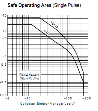

I agree , if the OP devices are not fakes .. a VERY good price.
2 issues stand out with this package , actually 3 , but the 3'rd is understandable.(ip issues)
1. NOT 1kw - 5 pairs of those sankens do not even come near the SOA (attached below) to do 1KW... 😱 About the same SOA as 21193/4's.
300w continuous , maybe 1kw 10ms pulse (4R load ... maybe
2. The circuit , while it would work , is not too refined for a amp of this caliber. Running the VAS at 10+ma and just using a low HFE type1 EF would make this amp perform horrible with a demanding load. It is similar to my "supersym" (cascoded LTP , same VAS, outputs as drivers) but very amateurish in its design. Also the VAS to-126 devices will be very hot as designed with no heatsink. The OP device drivers should have been on the main HS and he should have used a triple OP , this is why .47R emitter resistors are used .. bad thermal stability.
the 3'rd - Schematic is wrong (cascode is biased wrong).
At $5.00 apiece for the sankens , the package is a deal , but makes me wonder 😕 .
300w continuous , maybe 1kw 10ms pulse (4R load ... maybe)

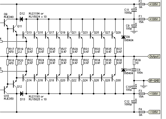

Output transistor power dissipation is quite complex.
1/ Typically the output transistors take 40% power and the load 60%
2/ The output transistor is only on for 1/2 cycle.
3/ The power dissipated on a half cycle rises to a midway voltage then declines after that to the power rail.
I agree , it is, but this amp is overrated. The designer seems to have just multiplied the device dissipation X5. The "brother of quasi" with 4 pair of MJ15024/5's is only 300 watt. My amp with 5 pair 21193/4's is 300+ at best.
The only true 1KW project I have seen is ESP's "insane" project 117 ... Project 117
9 pair 15024/5's or MJW21193/4's , along with a proper triple to prevent beta droop with difficult loads. (attached)
