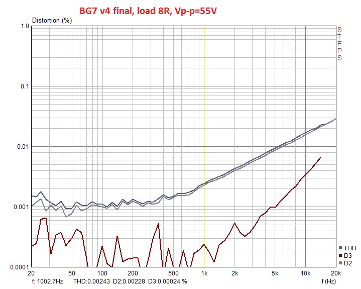

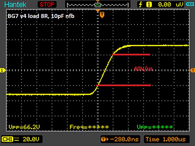

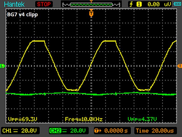

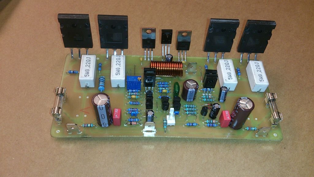

I was wondering what special is in the blameless amplifiers so I decided to create my own (as many mabers here).
I decided to go:
-input stage like in B.C. book
-vas same as old yamaha amps
-3 emiter fallower

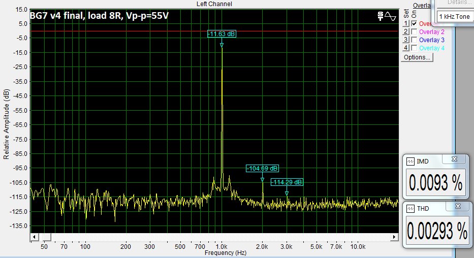

So basicly nothing new and nothing special, but I must say that I am very happy with this amp. Bellow some papers. Bias in this kind of setup is bit overcompensated as I prefer for safety reasons.
There is many improvements availible to make the amp ''nicer'' on the paper/measurements but I have listened it for a good while and I like it.
I have tested many setups for BG7 (2xLTP + cascoded VAS and etc) but this setup was sounding the best for me.

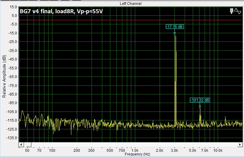

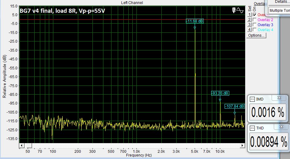

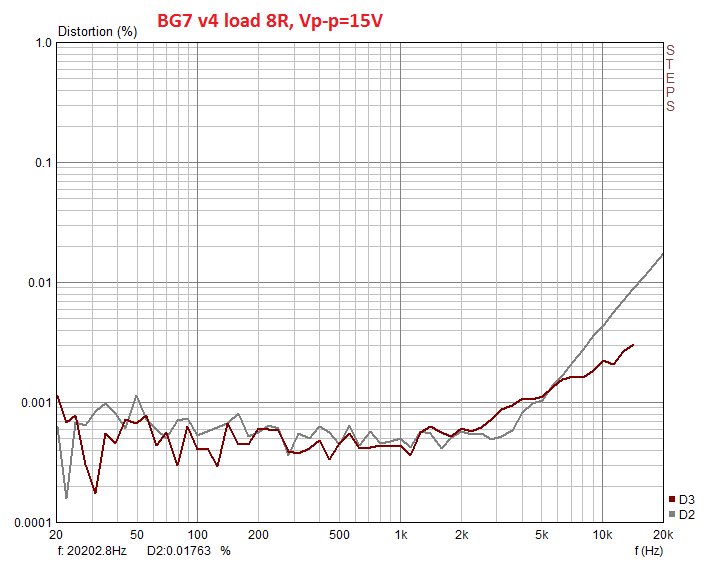

The prototype was showing bit lower THD than final version becouse I dedided to adjust a bit h2 and h3 spectrum to the prefered one.

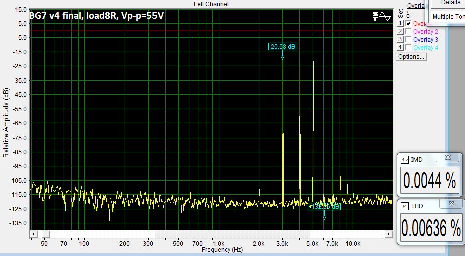

On the 3k-3.1k modulated signals the IMD products are lowering similar to thd spectrum - I suspect that this kind of setup is ok.

Looks actually very good. I also like a CFP VAS arrangement, though I never used it in my designs so far 🙂 Congratulations Borys!
Valery

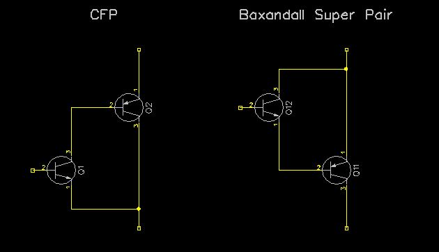

Valery, I think that was called Baxandall super pair, not CFP, if I am right.
By the way, Borys used very strange (at list for me) current mirror, what's that diode over there?
Damir
Damir
Damir, you're right. I was not attentive enough at a first glance.
The diode, I believe, helps with clipping, preventing VAS saturation (it is off while LTP is balanced and the signal is not high enough to open it). As an idea 🙂
