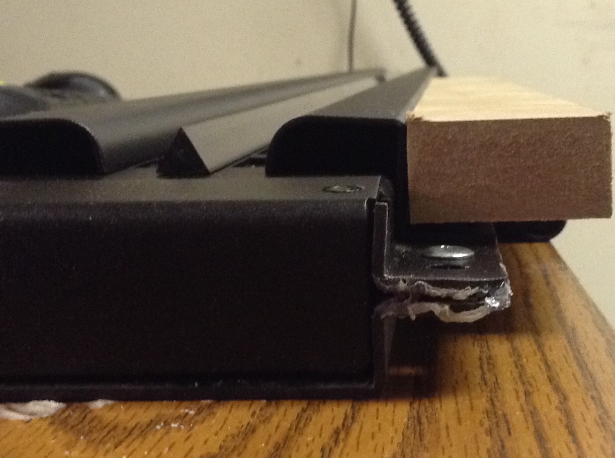

Does anyone have any more mechanical details for the RD50? I want to expose just the element while hiding the end caps. The only datasheet I can find just has overall dimensions.
I've attached a picture of the end with a piece of 3/4" MDF for comparison.
The baffle cutout should be around 47 2/8 x 3 7/16". You will need to route out the back of the baffle by 1/2" to account for the end caps.
