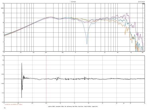

i have just finished a project with Beyma TPL150-H, i think the vertical dispersion is disappointing and horizontal dispersion is not up there with the best too. However, it is a big tall AMT so something got to give with that 99db sensitivity.... 😀

this is the 2way part of Beyma 12P80ND v2 and TPL150H.
As this is a tall speakers, the reference axis is at 1m height (which is between tweeter and mid bass).
the response is 10cm above - reference axis - 10cm below @1m.

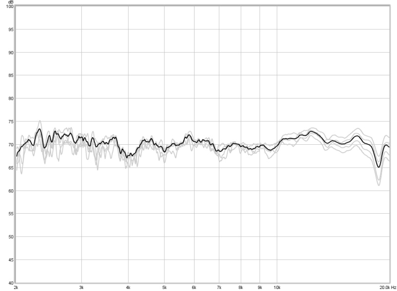

Attached is the PRO4 measured in-room at about 2m, no IR gating, 1/48 smoothing. The raw response humps around 10kHz, so I have used some smiley face eq, but no notches. I moved the mic ~5cm up and across between measurements (that is: much less than the ear-to-ear distance), and took the average, to show how much of the deviation is room/position related, and how much is inherent.
  • The top octave looks good, but is very position sensitive.
  • It has a consistent -2dB dip at 4kHz.
  • The dip changes if I fiddle with the number and position of felt pads in the rear of the unit. Presumably it is a cavity resonance, and can be reduced with correct damping.
  • Moving by 5cm, or changing a room reflection (e.g. closing a door) can create much bigger dips - about 5dB - which shows the relative insignificance of a 2dB aberration.
Do the Mundorf units have less than 2dB variation when measured in-room?
