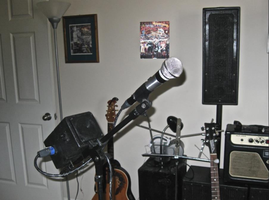

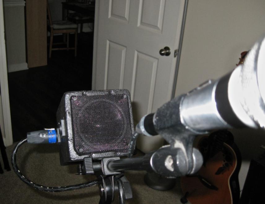

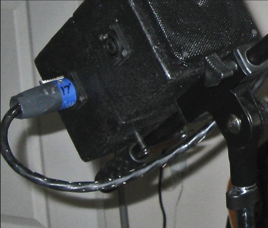

In reading your thread , realized I had never really tested some “mini-monitors” (MM) I had put together several months ago- no gigs since before Covid19...
Set them up and gave them some live listening tests today. For use with a live acoustic band, they offer advantages over a wedge monitor, even those using high quality co-ax drivers as have been suggested, assuming you don’t want much more than 106dB SPL at your ear.
Like Galaxy Audio’s “Hot-Spot” monitors, they use small full range drivers located near the mic, but using even smaller drivers allows less of a visual distraction, and makes it possible to use one boom mic stand for both the MM and microphone, which also puts the monitor near the maximum rejection point of most cardioid microphones.
The MM I built use 3.5” drivers, a pair with B&C 35NDF26, and a pair with Tymphany TC9FD-18-08. They sound good “full range”, 100-Hz to 16kHz, producing in excess of 100dB at the ear, mounted on the mic stand boom.
The Beyma 3FR30 would be similar, though would roll off about an octave higher.
The close proximity of the MM to the performers ear takes advantage of the inverse distance law, sound drops at 6dB per doubling of distance.
To keep up with the MM, mounted on a mic boom producing 100dB at the ear at 1/2 meter- a floor wedge at 2 meters distance typical for standing performers would have to produce 112 dB to achieve the same level.
With acoustic instruments used with floor wedges the instrument mic or pickup is “hearing” a level about 6dB louder than the performer’s ear- the MM typically has about a 6dB gain before feedback advantage over a floor wedge.
Using in-ear monitors provides the best potential for reducing stage volume and maximizing gain before feedback, but using MMs can reduce stage level by 12dB (10dB level reduction sounds about “half as loud”) while still allowing performers to hear at the same level, which makes a huge difference in the overall mix clarity both on stage and in the house.
Although the MM are not going to produce much level below 100 Hz compared to something like the “Smithers wedge” or similar, in most cases the low frequency “spill” of the mains provides plenty (often too much) of low end on stage for a live acoustic band, especially if microphones rather than piezo or magnetic pickups are used.
If the acoustical factors are not convincing you, consider for the cost, size, and weight of one decent co-ax wedge, you could make six of the MMs.
The rectangular box and stand clamp (two T-nuts, two screws and a piece of metal) is easy to make, probably also reducing build time by a factor of six, especially considering the time wiring crossovers.
