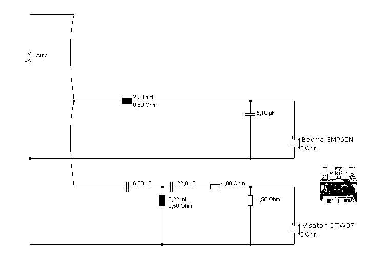

Who can help me about box and crossover for this drivers?I have small room,thinking about small BR with stands...or ML-TLs.Beyma have qts around 0.29...

I was not very impressed with this driver. The sound is smooth but without to much details. It is quite "slow"; I would not use it over 2500Hz. Bass is not great either. Easy to implement crossover. It can sound good but only if you use a subwoofer and ~1.8kHz crossover.
I would recommend you the Dayton RS150 instead. The price is about the same but you get better bass and more details. You still have to cross it quite low so DTW97 may not be an option.

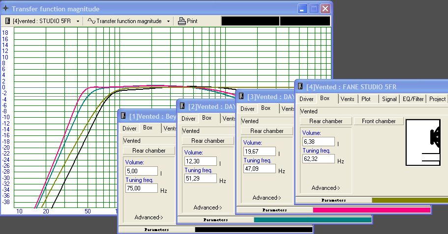

To reinforce what tpsorin said I tested/simulated these 4 drivers: Beyma 5MP60N (black), Dayton RS150-4 6" (green), Dayton RS150S-8 6" (red) and Fane Studio 5FR (yellow). Another good contender it's the Aurum Cantus AC-130F1 5-1/4" Woofer

It's a good driver. PeteMcK might be very right. You will probably add later a sub or woofer. In the mean time, a BR of about 12L (as in the spec sheet/or a little less) or closed box (less bass) it's possible with the volume I mentioned before in the other post, or similar.
Visaton DTW97
Very nice from You...I will also try Beymas in a angular spiral horns,enclosure for FE126e...not the same driver,but low qts,low moving mass,small Vas...small box for small room...18x31x30cm...size of the box!!!
- Beyma 5MP60N+Visaton DTW97
