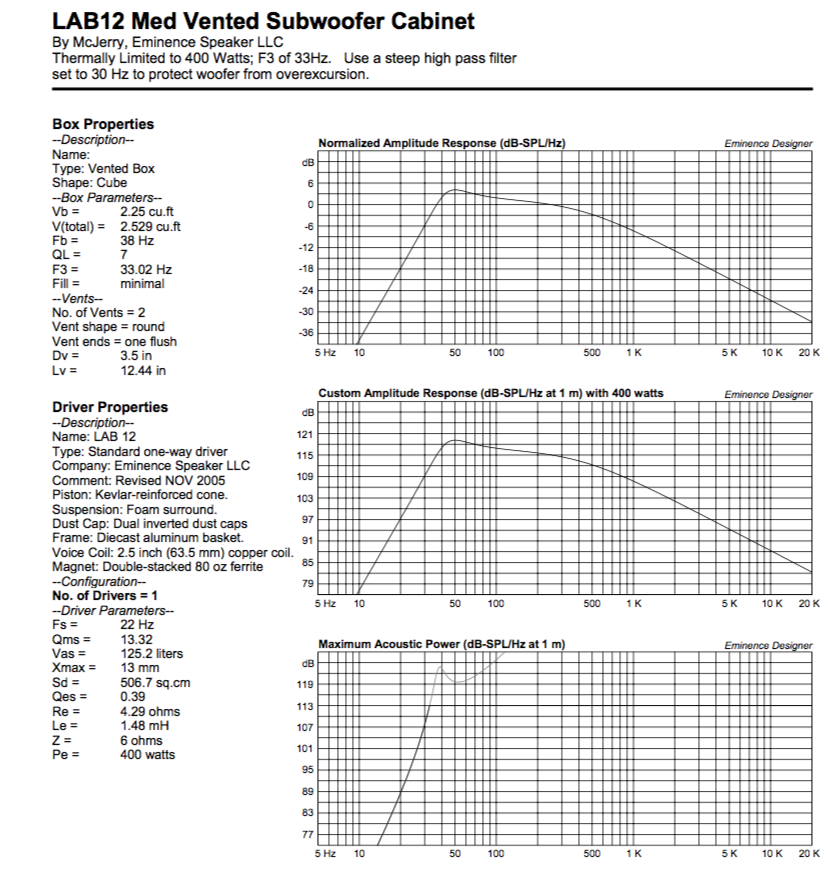

FWIW, a ported 15" in a box similar size to these will do 121dB at 40Hz. If you were pushing the sealed boxes to the limits, the ported box would be strolling along. Guess which is going to have less distortion.
