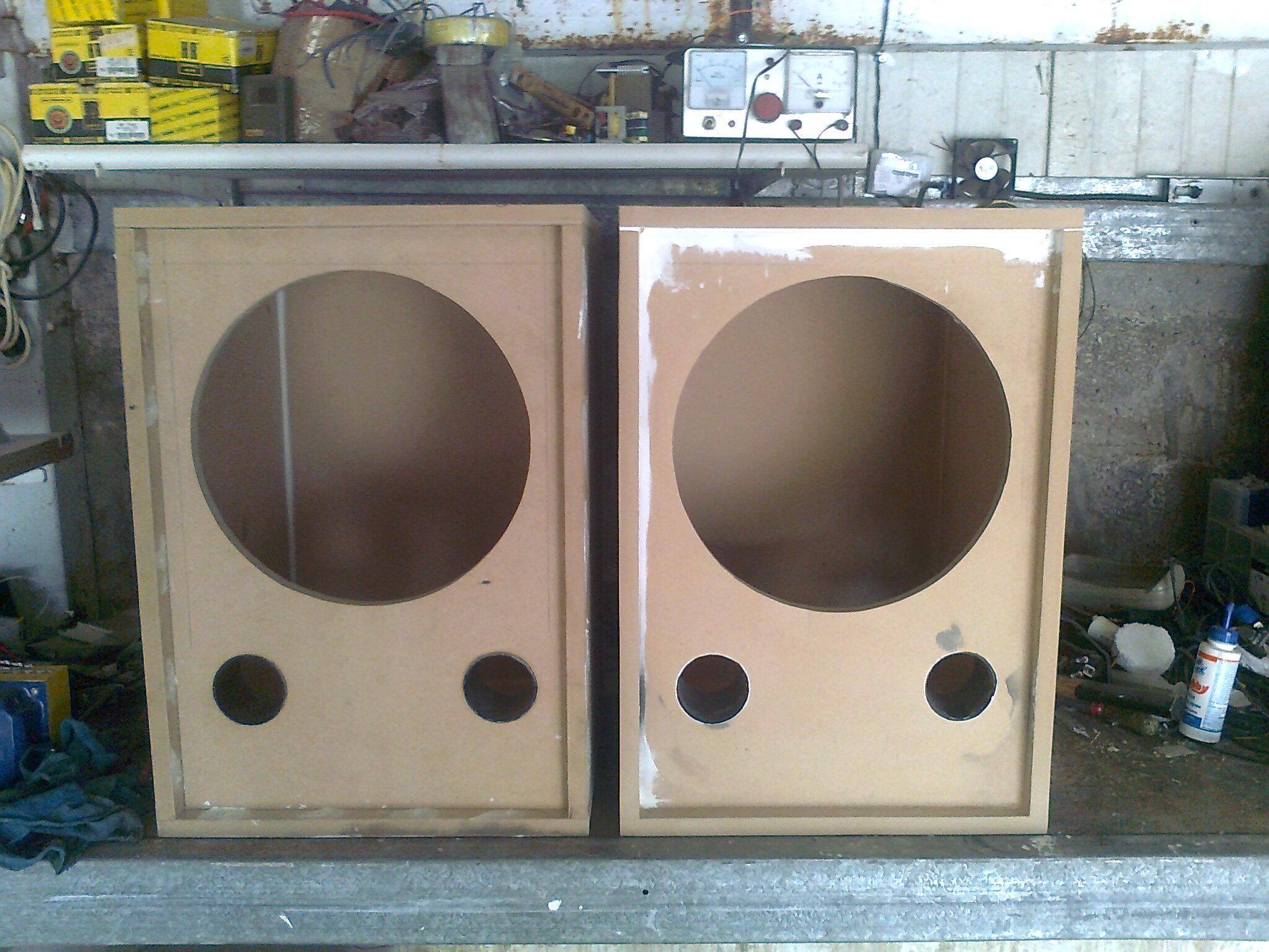

yes imean the folded horn...
it makes 126 db rms so i think it;s ok....
i have two 50 liter boxes tuned to 55hz and i made a simulation with the fane woofer at my box....
i have -2 db at 60 hz....
so i thin it's ok..
what do you think?
this is my boxes
so i thin it's ok..
what do you think?
this is my boxes

i think dc gold speakers are hi-fi speakers...
i need some smpl for pa use.....
so i thik i will go with this speakers Fane Sovereign 12-250 TC - Thomann Greece
i have 2x300 watt 8 ohm class d amp available...
