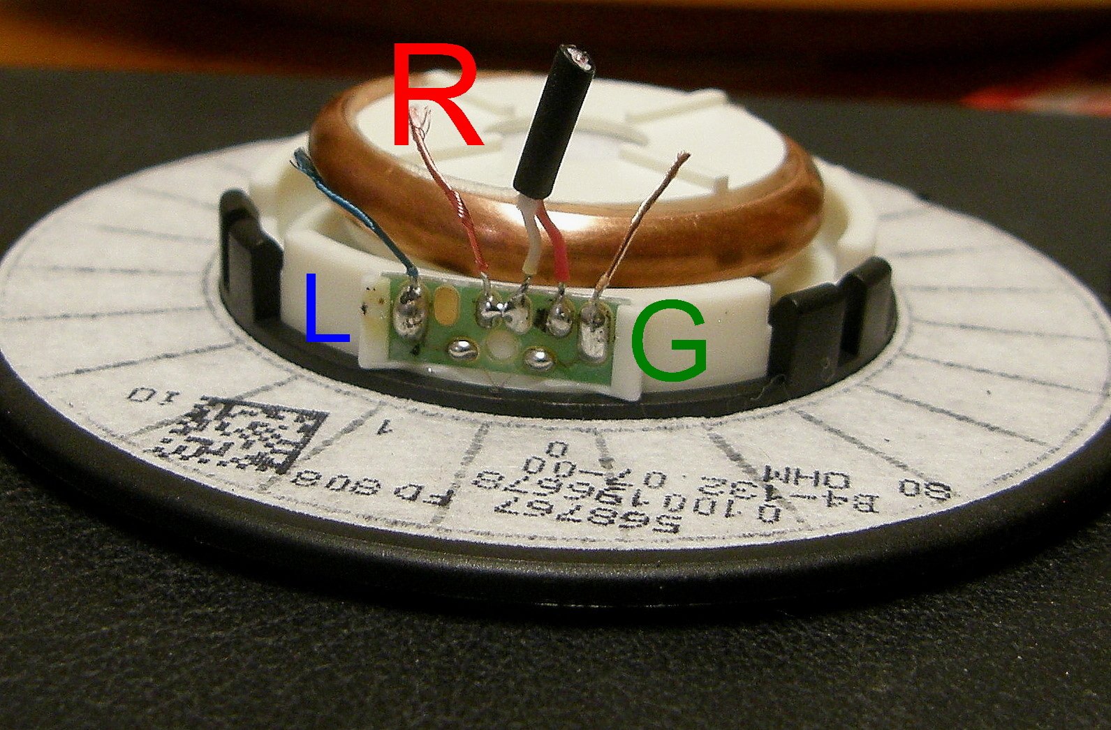

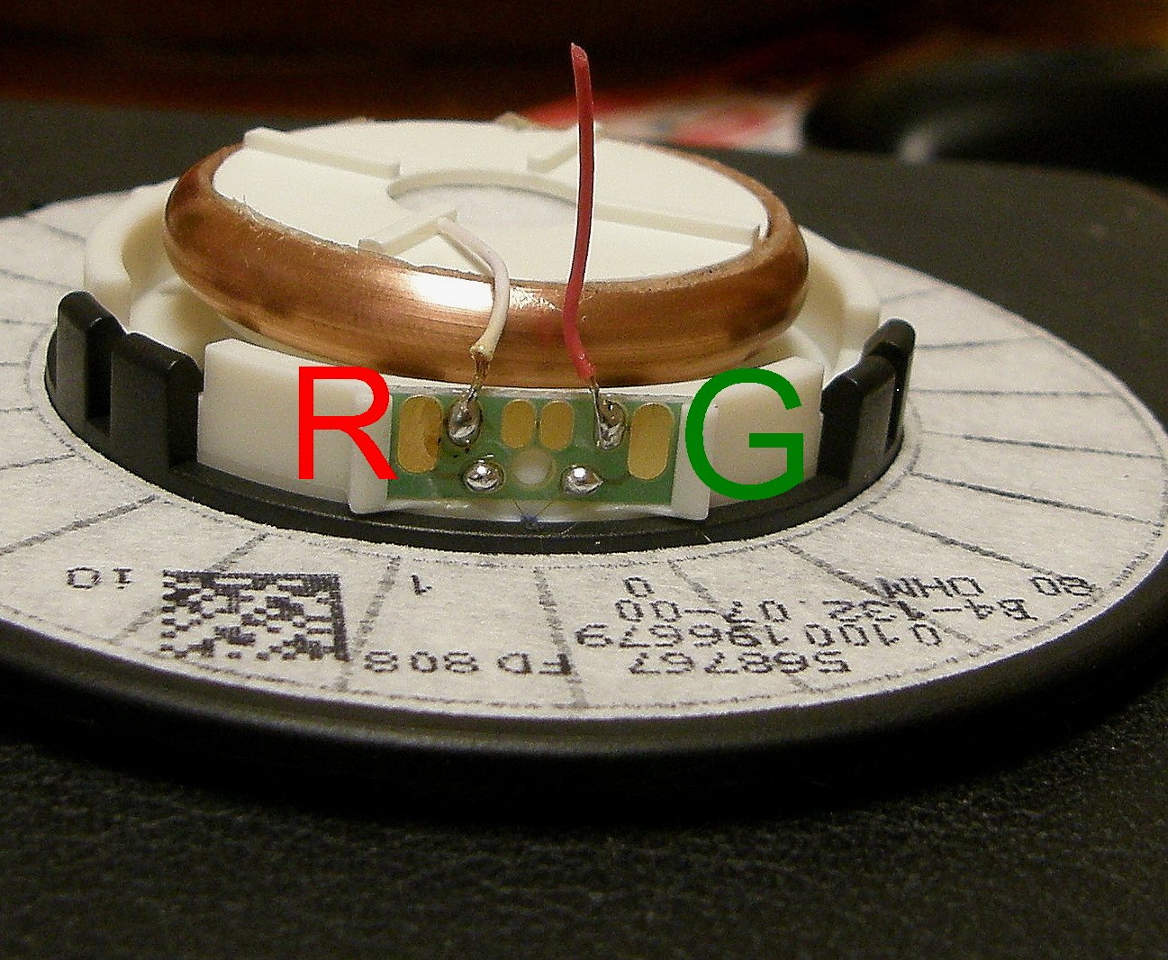

More than likely this has been discussed somewhere. I ran into Custom Cans while looking for a way to make the cable on my Beyer Dynamic DT770 pro phones detachable. Of course, this led to more options for fine tuning the cups of the cans as well. I do not regret it so far, but am not done with the initial wiring. Beyer Dynamic uses a certain wiring for the drivers and well, Custom Cables uses yet another. I don't see a problem since Beyer Dynamic has the back of the drivers coded for + and -. It is just the difference between the two methods makes one start to guess what goes where. I am almost done and shown here is the original wiring from the factory.
I should add that the first photo is of the left driver and of course the next photo is of the right driver. Beyer Dynamic cable attaches to the left side only. I am starting to really prefer this wiring arrangement.
