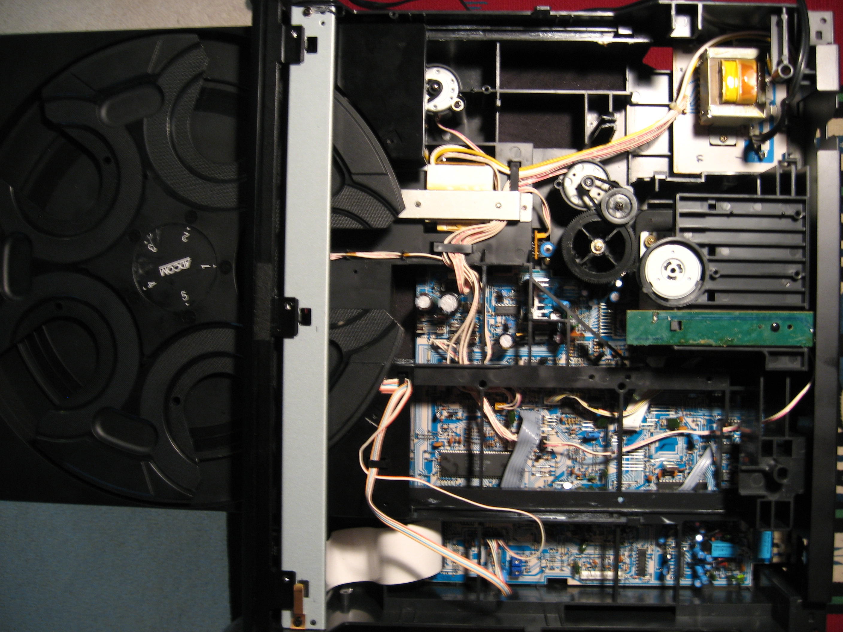

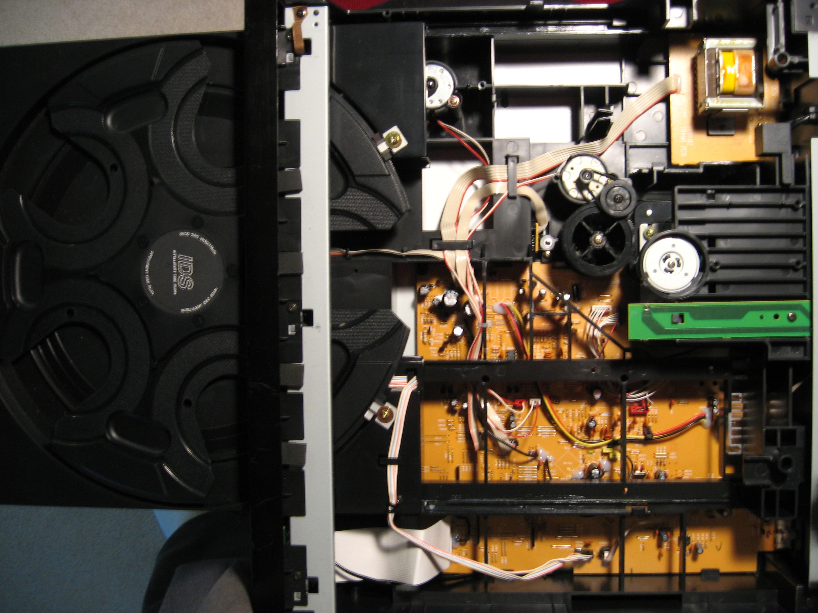

I, like most DIY audio members, like to hear good sounds and that usually means modding equipment to our liking. Everyone has different Idea as to what is "Great Sound". That I believe is our personnel choice. I have modded a Marantz 67SE, Aracam Alpha 5, Nakamichi Player 4, and a Magnavox CDB-630. Some to Destruction, by my own doings. I decided to choose my next victim, and after reading "Reviews" picked an Adcom GCD-700. Of course, price was an issue, but it was universally praised as an excellent sounding unit. It was also touted as a "quality unit". Bought one that had some tracking issues, Taking a chance(seller completely honest, not a factor in my discovery). What I found was quite a shock! I received the unit and immediately took off the cover to dig into the laser unit(maybe adjustment). The box indicated that it was built in Japan, but immediately it was obvious to an experience DIY it was made in China. Sure enough, the name plate confirmed it. Many of the large caps had spewed out on the horrible constructed circuit board. Parts were not only of inferior quality, but not place in alignment, and had unequal length leads. Some parts where against the board others with half inch lead lengths. The player had 2, I repeat, two regulators. It had been repaired in the past, one capacitor of much greater quality. I recognized this unit. I pulled out my unmodified, working, Denon DCM-260, exactly the same mechanism, frame chassis, and even the power transformer. I was SHOCK to see a $200 unit with the same basic chassis as a $1000(?) unit. The denon parts where laid out even, aligned, with normal positioning found on most units. None of the parts had failed yet. Both units are from the mid 90's. How did this unit get such rave reviews? Does this prove that quality(including parts) don't make the difference between MID FI and HI FI. I didn't even find a medium review anywhere on the Adcom. Just as a side note, all the Philips chip/mech units are still working some 26 years old, all my Sony units have failed at least once.

I decided to choose my next victim, and after reading "Reviews" picked an Adcom GCD-700. Of course, price was an issue, but it was universally praised as an excellent sounding unit. It was also touted as a "quality unit". .... I was SHOCK to see a $200 unit with the same basic chassis as a $1000(?) unit. ... How did this unit get such rave reviews? Does this prove that quality(including parts) don't make the difference between MID FI and HI FI. I didn't even find a medium review anywhere on the Adcom.
LOL - proof (as if it were needed) that the reviewers either talk through an orifice not located in the region of their face AND/OR that they are as suseptible as anyone to a flashy exterior and a marketing spin.
Audiophools the world over should consider this in the context of cables, "audio quality" capacitors or semi-conductors etc etc.
The electronics in the ADCOM appear to be completely different from the Denon, this could explain sonic differences.
I'm not too surprised they're both using the same transport, maybe ADCOM didn't want to spend the $$$ in developing their own transport.
In my experience Denon uses good capacitors too...
