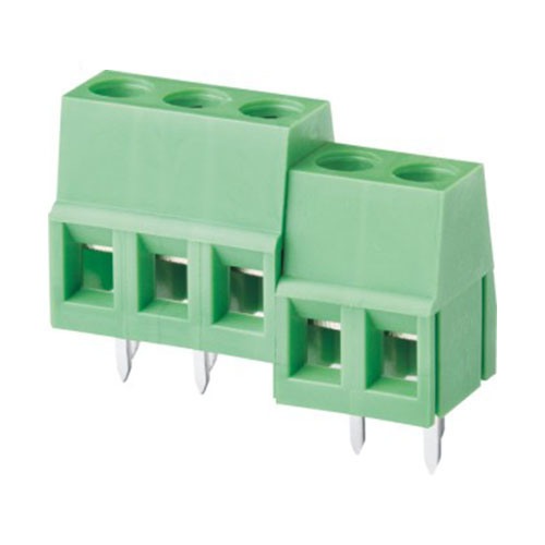

Standard terminal blocks tend to twist when tightened and I always worry about damaging the boards.
Are there better alternatives?
I much prefer polarized plugable connectors to these screw down terminals. Once connected correctly and labeled, not a problem in the future. I use the Phoenix screw down terminal when first building, but always switch them out to something like Molex KK 2.54mm,Molex SPOX, etc., based on the requirements (voltage, current) of the circuit. Favorite recent terminal series is the TE Dynamic D5200 series. Of course for those, the board needs to be designed for them. The Molex SPOX are 5.08mm centers, so can usually just replace the normally used Phoenix connectors directly. Of course the crimp pins need a crimper of some sort, but normally not a problem.
You get terminal blocks with pins on the ends that go through holes in the PCB, to transfer the stress to the board.
Twisting means you could be using too much force. Try larger rated terminals. Or a smaller screwdriver.

Anyone with experience knows soldered connections are not the best way of connecting wiring to PCBs. To avoid the twisting you could use the minimum of a 3 pin version. It is mainly the 2 pin versions that twist. If you use for instance the 4 pin version you can have 2 x + and 2 x - in a power supply and have the benefit that it does not twist.
Of course one does not need to tighten the screws like tightening a cilinder head. If you worry about such things you could use the versions with M3 screws and crimp the O shaped AMP connectors. These are a good solution for amplifier outputs, power supply connections etc. as they can have some serious current. Even when the screw is not tightened right these will make good contact anyway. Quite reliable.

These are also available with a pair of small plastic pins at the bottom.
These would drop in small holes in the PCB and will prevent rotation when tightened.
But you have to look for them; Würth had them last time I looked.

I noticed that it is the plastic that twists more than the conductor itself. Also, it happens more on cheap ones. As Paul said, if you are designing something yourself and have pcb space, use 3+ ones instead of two contact. Proper hole sizing is very important. I have tendency to hold the housing with fingers when tightening it down, works well (even when it doesn't twist, my mind thinks it reduces the chance of making cold joint).
