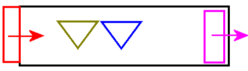

Recently I have become very interested in effective air cooling of PCs, and I was thinking of adding an extra fan to my OHP. I have learned through case of my computer that the most effective way to cool is to bring fresh air in with an intake fan and then use an exhaust fan to pull the hot air out. By adding a simple exhaust fan to my friend's PC (he already had an intake), his temperatures dropped by about 6*C.
I was just wondering if there would be any problems that anyone could see with me adding an intake fan onto my projector. The bulbs are 360w 82v ENX bulbs in an Elmo HP-L355 Deluxe OHP.
I have attatched a file to explain what I am trying to do. The view is a crude top view of what the projector looks like. The triangles are the bulbs. The Blue triangle is the one currently in use, the violet rectangle is the current exhaust fan and the red rectangle is the fan I would like to mount on the opposite side of the OHP. If enough air can be pushed by this fan I am hoping to create a sort of wind tunnel effect.
Another question I have for this is, will this possibly lengthen the bulb lifespan? Because Halogen lights get so hot, I wasn't sure if this might possibly help to tag on a few extra hours of life to each bulb.

anyone?
I'm not so much concerned as the bulb being "too cool" (I'm not using peltiers here 😉) as I am with contaminents possibly getting to the bulb more easily. I know my computer fans get quite dusty after a while (they would when they're pushing near 200cfm in each direction 😀) but I am not sure what effect this will have on my OHP.

I'll take a guess at this, Defmike 🙂 (Disclaimer: I have very little electronics knowledge) However, after working on machinery and equipment all my life, cooler is almost always better. I don't believe that you could make the interior of that OHP too cool. I would think that a pair of evenly matched fans, one to force intake and one to improve exhaust, would only help the situation. It could also be easier on the fans themselves. However, I wonder if the heat of the exhaust would be hard on the exhaust fan? Over the years at the fire department we have switched from trying to "exhaust" smoke and heat out of buildings to "pressurizing" the building on the intake side to force the heat and smoke out of the building. This puts your fan in the fresh, cool air and not working in the heated exhaust air. Perhaps if you are using two fans, it would be better for the longevity of the fans if you use both for intake, "pressurize" the OHP box and then choose a few different exhaust points that ensure an even air flow over the necessary components? This could let you channel your air flow over the critical heat producing or heat critical areas. As far as extending the life of the bulb, I would think that keeping the bulb within its intended operating heat range would get the maximum life out of the bulb. Just my thoughts...

I really don't think peltiers would be very effective for cooling bulbs. There are a few problems I can see.
1- They create MORE heat on one side, it is harder to deal with
2- They can create humidity which is destructive to halogens
3- Changing hot glass into cold glass too quickly will crack or shatter it.
Water cooling, however, is something I can see being done more easily and effectively. If you have water at room temperature, it will NOT be too cold for the bulb to crack it. It will also absorb heat very efficiently in order to cool the bulb more to room temperature. The difference between peltiers and watercooling alone is this: Watercooling is meant to bring temperatures down to ambient temperatures, peltier cooing is meant to bring temperatures into sub-zero temperatures. For CPU cooling this may be OK (though some consider it overkill sometimes), but for cooling glass I don't see any benefits. You're not trying to freeze the bulb, you're trying to dissipate the heat off of it.
If a shroud of metal (preferably copper, though aluminum will work) that will fit around a bulb with water flowing inside of it could be created this would probably be the best method for bulb cooling. Keep in mind too, a thermal grease would need to be between the copper surface and the bulb surface in order to create a good thermal flow between the two. There are a few flaws in this design, however.
1- When cooling a CPU the heatsink must sit perfectly FLUSH with the die of the CPU. Any miscontact and temperatures rise like crazy.
2- Creating the metal shroud with such precision would NOT be an easy task, neither would be switching the bulbs out of it.
3- It would be expensive to make...you will need a pump, tank (to hold the water while it's still cooling), radiator, fans (to cool the radiator, they could be as quiet as needed) tubing, and the "heatsink" for the bulb. The pump, tubing, and radiator could be purchased or salvaged from cars etc, but the block (or "heatsink") must be created to custom fit the bulb you would be using.
Unless you could have water actually TOUCHING the glass...which I don't think would be possible without damaging the bulb....it would be a very difficult task. Actually, if there was a coating of some type that does not limit thermal flow but somehow waterproofed the bulb this would be the best solution because the thermal contact would be directly between the bulb and water...there would be no metal to pass through on the way. If this would still be too hot, it would be a good idea to use thermal paste to connect metal fins (to increase the surface area where heat can dissipate) to the surface of the bulb.
If you ask me, any of these methods would take a lot of time and a lot of thought. I think that air cooling would work fine for bulbs, but for the person that just *HAS* to have the projector be dead quiet, watercooling is the solution. (unless you want to submerse the back of your bulb in 3m non-conductive liquid...but that's something else ALL together 😀)

Let Me start by saying that,while I am an electronics Tech(23 years), I am in no way an expert on lighting products, but I do know that a Halogen bulb >Needs< to run hot. It has to do with the tungsten in the filament actually vaporizing(A little) and the combination of the halogen gas and the quartz of the tube helping it to redeposit back on the filament. If You look at a halogen bulb that is old or has been run at a lower voltage(On a dimmer) You will see the metal on the outer tube from the lack of the heat(more so at the support posts). Cooling a halogen bulb would therefore, not only shorten the life of the bulb, but also it would get progressively dimmer as it aged. Sorry to be the bringer of bad news, but I know this to be true.

Tall Shadow...thanks for the heads up. I guess watercooling or peltier cooling isn't really a goal any more
I think I still may go with the air cooling idea just to see how it turns out, if not just temporarily. Not so that the bulb itself stays cool, but so the air being blown all over my room isn't quite as hot...
