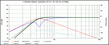

BetsyK Vented 61Liter revised
I've revised my vented BetsyK model using as measured T/S specs (about 8 hrs run in). Really looks quite nice. Here are the results.
61 Liters net. Fb=46.7 (3"x1.75" vent). 100.9dB w/ 5 watts. F3/F10 48/36 Hz.
I'm fairly skeptical of the VAS going down with time. It doesn't make much sense to me, unless we're talking a long period of time and the suspension gets drier and tighter. But, your changes are pretty small. 61L isn't a big vented box for the BetsyK, but if it gets boomy you can always tune it a bit lower.

Perhaps I haven't been clear. My measured Vas values aren't going down. They are consistent, they just haven't ever measured as large as the specs.
Both drivers are marked WBAL 114 w/ a 1/22/10 date on the back.
FWIW, if the box volume doubles to 4 ft# (111 liters), the F3 drops 4 Hz and the output goes up by 1.5dB but f10 doesn't change.
That's not a good trade from my perpsective, no real change in performance for twice the box volume.
Also frankly, if the box is tuned low (~34Hz) the F3 goes way up and the FR isn't nearly as flat. That also doesn't make any sense as a design choice.
Paul, your site says 2 to 3 ft3 ported, so I don't understand why my result seem to bother you so much. You can see the predicted response curve is quite flat so I wouldn't expect it to be boomy.
My experience with this box modeler is that it is a good predictor of results when measured T/S values are used.
