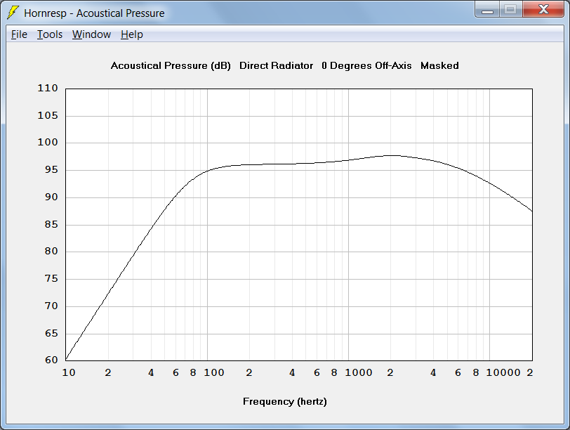

Perhaps I’m missing something - The response in that box looks pretty bad in that it drops off very quickly after 1000Hz. That not full-range.
hornresp only considers power response - not what can happen with narrowing dispersion or breakup region. On, axis the published graph is pretty much what I saw my Betsy-k mounted in a 28 inch tall by 12 inch wide Karlson - box - imo, BetsyK has a nice sound on vocals in general.
Hi freddi,
For multiple-segment horns yes, but not for other loudspeaker types 🙂.
The attachment shows the on-axis pressure response for your 2 x Pi direct radiator example.

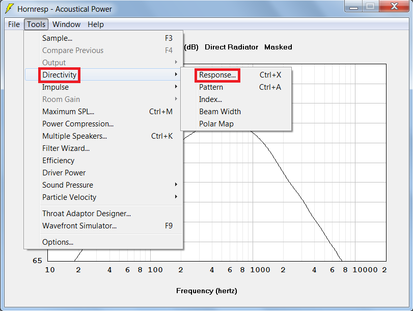

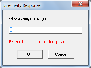

David - how does one select that option to show the axial frequency response?
Hi freddi,
Calculate the standard power response then select Tools > Directivity > Response, and specify the desired off-axis angle. The default value is zero, which gives the on-axis pressure response. There are five directivity tools that you can play with - have fun 🙂.

thanks - does that also work for vented cabinets? Regarding front loaded horns, must there be just one segment in the model for the directivity function to work?
The directivity tools work for the individual outputs of a vented cabinet (i.e. the direct radiator output and the port output) but not for the combined output. A front loaded horn must have only one segment for the directivity tools to work.
