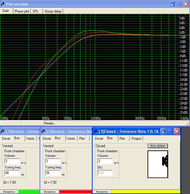

I decided to go with a 3cf box 12” x 12” x 36” inner dims and will top it off with a tweeter (pro sound with a small waveguide). Initial sims indicate simply cutting a 3” hole into the .75” wood for a tuning of around 40hz.

Can some of you check my sim and offer any suggestions on tuning the box before I cut wood?

This is what I get in WinISD with your tuning:
3" round vent would be 1.75" long.
2.25" x 2.0" square vent would be 0.76" long.

I decided to go with a 3cf box 12” x 12” x 36” inner dims........Initial sims indicate simply cutting a 3” hole into the .75” wood for a tuning of around 40hz.
I plan on powering this speaker with the neat little Dayton T-amp.......
FWIW, ancient wisdom dictates a ~3.36 ft^3 net tuned to Fs as the 'ideal' minimum, so assuming only 10 'clean enough' watts available at Fb, I calc a ~3.5" dia. x 0.75" deep hole is required based on published specs, though WinISD Pro (WIP) says a 3.125" dia. (~42 Hz my way), so a range to work with.
For a 3 ft^3 gross/~2.9 ft^3 net then, its mid-bass 'bloom' will be a bit more peaky unless tuned down around the T/S max flat alignment's ~36 Hz which requires a 3" dia. x ~2.5" (~2.87"/WIP) long vent.
Regardless, a 3" dia. x 0.75" vent in ~2.9 ft^3 = ~44 Hz/(47 Hz).

Here are my sims for the 12lta.
3 cf box, 3" port:
.75", 2.5" and sealed. Seems you can't go too wrong. Since they will be in or close to corners i am going to split the difference and go with the 36hz tuning and the 2.5" length (thanks GM). If it's too boomy i will stuff the port. This driver might work best in aperiodic cab but i don't know how to sim that.

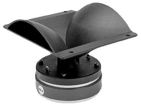

Godzilla, is there any particular reason you are going for a waveguide & compression driver rather than something like the FT17H?
How does one go about choosing a CDriver and flair?
Got so say I'm liking the curves on this type of unit :nod::nod::nod:
